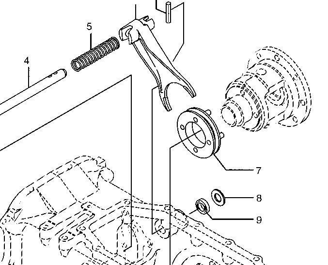

Problem 2. My positive traction pedal sometimes works and sometimes doesn't. When I get stuck going up a hill one wheel starts spinning so I push the pedal. Sometimes it locks into place and sometimes it just grinds. Is there an adjustment I can make to fix this? I have had to dump a few loads in bad places just to get myself out of situations. :confused:

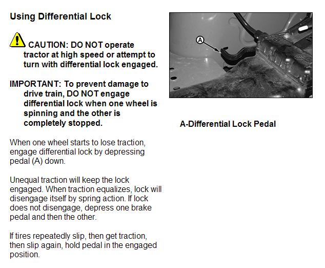

Question #2 -- the positraction (differential lock) should not be engaged when one wheel is spinning. It will/may take out the locking fingers and then not function at all. Engage the positraction while the wheels are stopped.
It may even spell that out in the manual ;)
As it is here, along with pic of the pins on the differential lock that could get sheared when mechanically linked (or attempted) as it is like trying to get into gear without using the clutch (they grind).
On 1- :thumbsup:
On 2- Manual? What manual :confused2:. Haha anyways, I never knew that (old habit with other tractors). I will take it apart later when it cools down to see what damage I've done.

On manuals, first URL is to order manuals. If you live close to a JD dealer you can get it through them save you the shipping.
Second URL is the online version manual for your loader.
