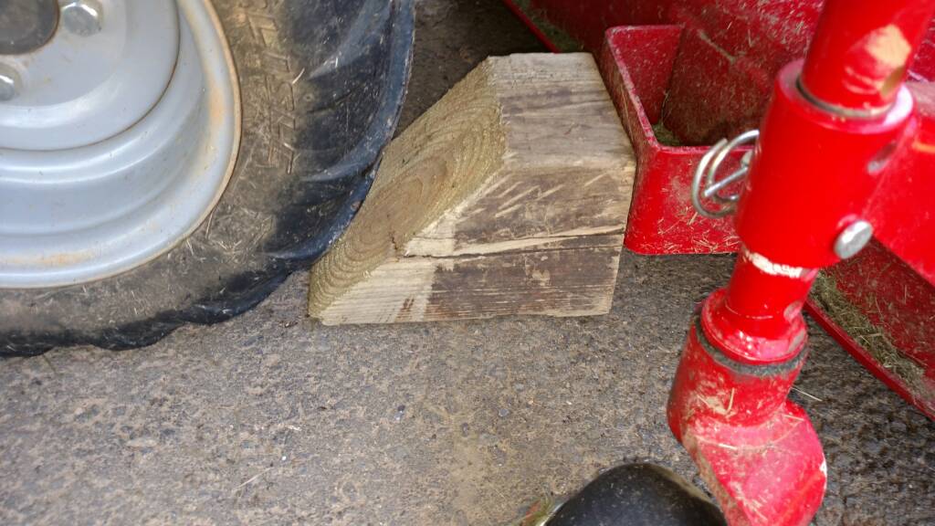

I made a couple of wood block ramps out of some 6 by 6 cut at a about 45 for ramps they are about 10 inch long like others have said it works just get the front axle started to climb over but it is wise to use 4 wd I have a 1705 with the same mower deck.
