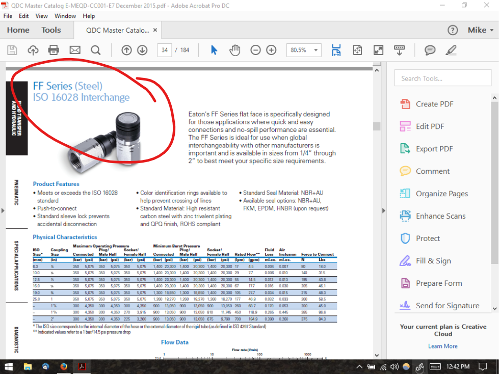

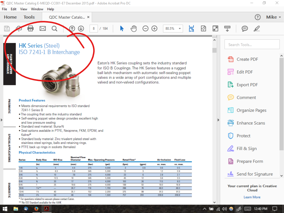

Why does the tractor industry use the ISO 7241 couplers instead of the ISO 16028 (flat face)?
ISO 7241
ISO 16028
The flat face couplers are used almost 100% of the time on other equipment such as skid steers and they are 1000 times easier to use and much cleaner. My guess is cost.
   / Couplers... #2
My guess too is cost...and not all use the 7241's either, many OEM's use 5675 AG style.
