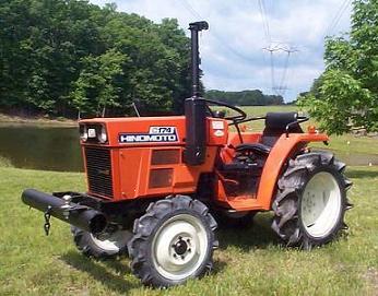

Until a week ago, I had a little neglected tractor I bought mostly for nasty jobs.
It didn't have a cow catcher, instead, it had more of a "bull nudger." The bumper, made from 5/16 inch plate and 4-inch pipe, was about a foot wider than the tractor.
If I could push it over, the bush hog would chop it. (Hopefully the photo will really get uploaded so you can see it.)
One caution -- I thought the bottom of this little tractor was pretty well protected. After a couple of hours of "mowing" 1 - 2 inch diameter oak saplings, I suddenly lost my hydraulics. Apparently, as the tractor moved over the brush, the brush slowly loosened the hydraulic filter, which was up within the frame of the tractor. Oh well, I needed to change the filter and fluid anyway.
A year ago, the area where the tractor is parked for the photo, was a tangle of brambles, samplings, and construction trash.
(And for anyone following the discussion about welders in the do-it-yourself forum, most of the welding and repair on this tractor was done with a little Lincoln 115 VAC 140 amp flux core welder.)

Hi knute
I like the "bull nudger". That's a good point about oil filter. In my case the brush is popping out pins holding brush cutter. I'm going to get bolts for pins till the brush is cut. Got about another 20 acres this year and 40 I'm going to clear next year. I just thought about it today; I'm lucky I didn't break a line with some of those bigger trees I cut. Now I'm cutting the bigger stuff on the left side as the oil lines ore on right. Also, I'm now using tires to push heavy stuff down. (Probably not so good on tires.)
That nudger might be better for brush if lower closer to ground. I would do something like that if I wasn't about 3/4 done. In my case I have a smaller tractor pulling an 8 ft woods and I could use a little front weight. I would include a box that I could load some solid blocks into. I still may get some front weight, everything would be more stable.
