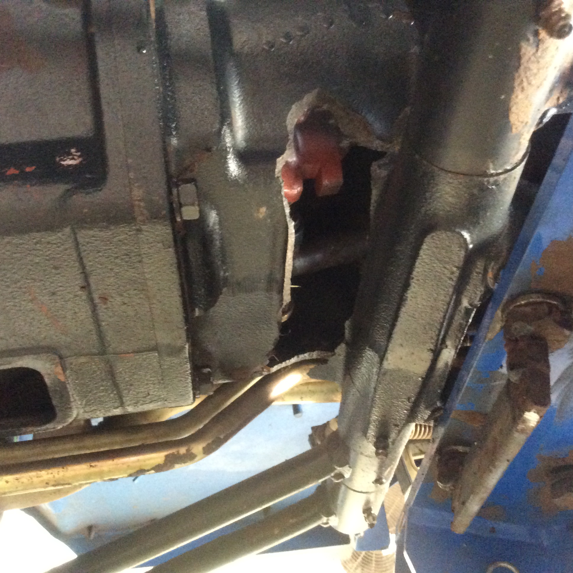

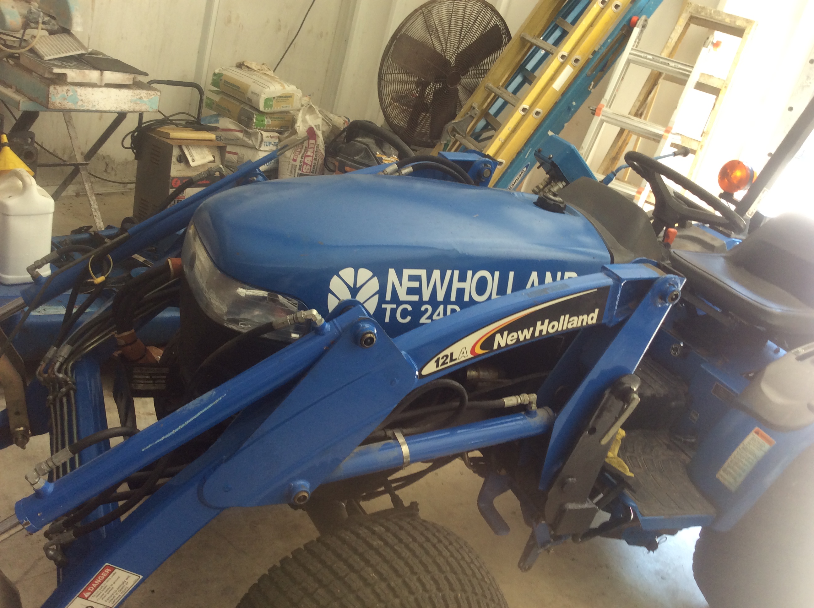

I'm new to this forum but beside that I have A tc24d 2003 with 1200 hrs . The bolts were loose on the support bracket apparently and the assembly broke off the case .If I find a housing is this a diy job for fairly capable person who has never split a tractor before. All advice is welcome !! I assume this is an expensive fix and a new holland dealer is 50 miles away.Thanks ,Mike

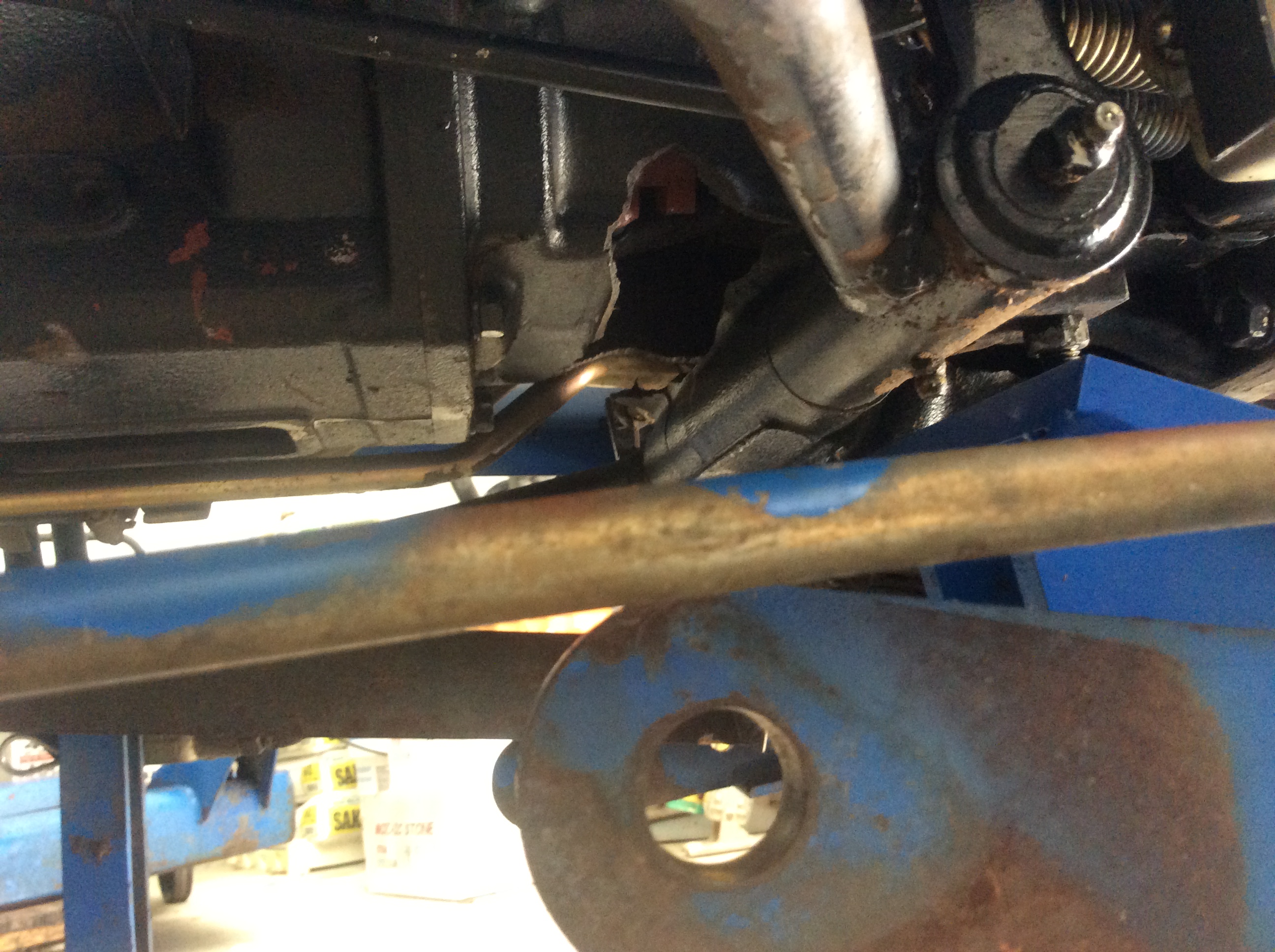

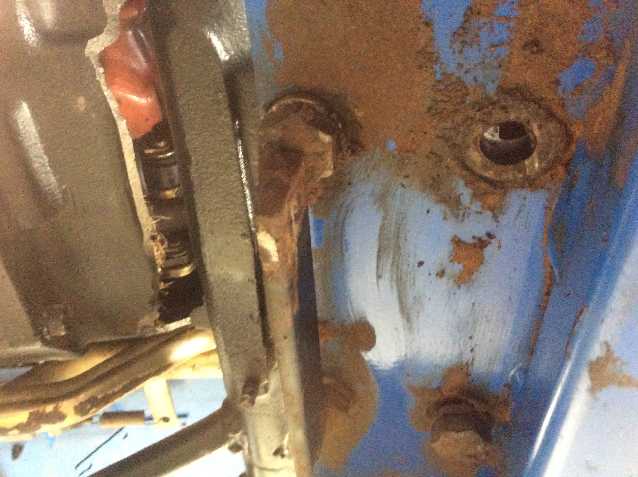

Here are pics of cracked case it happened first time out after putting 12la fel on tractor .It had a belly mower on when it happened , support bracket bolts were loose and one was missing still licking my wounds now I know how everyone feels when tractor breaks!!! image.jpegimage.jpegimage.jpegimage.jpeg

Wow, when you said cracked case I thought of a "crack". That thing is pretty much toast!

It's after the bell housing messicks calls it mission case ,$1070.00 for case part # sba322017621 couldn't find any with all new holland dealers in u.s. Messicks says the are expecting back order any day. Tried salvage but no luck man you know I'll be checking those loose bolts on undercarriage after this. By the way that's quite a engineering brew project you got goin! That reminds me in happy hour
