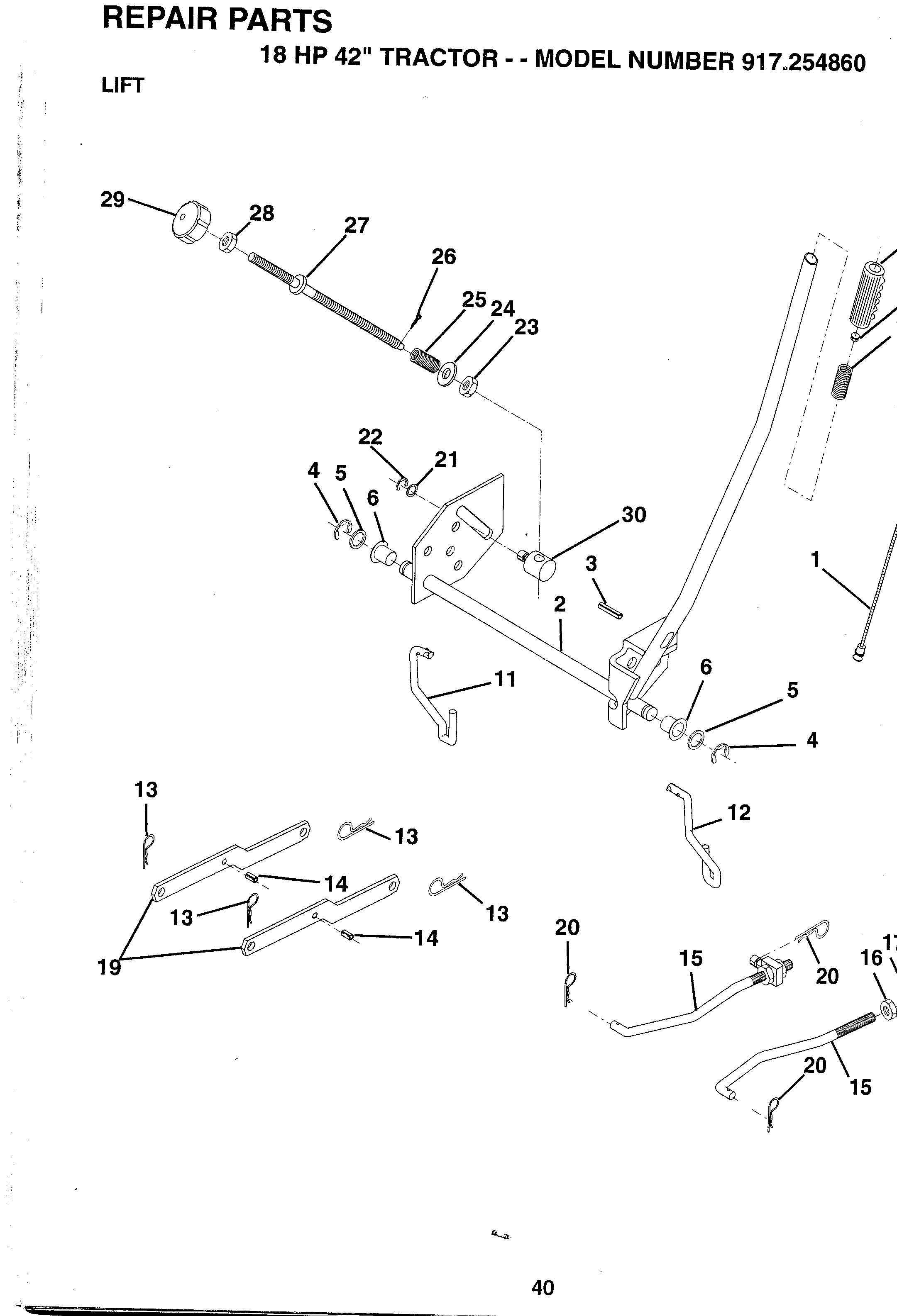

My vintage Craftsman 42" mower (model 917.254860) is missing a suspension arm. There are three of them on this model. Two are shown on the Lift diagram (see attached file: Key No. 19; PN 130832) as a "Arm Suspension Rear" and one is shown on the Mower Deck diagram as "Arm Suspension Rear" (is the center diagonal of attached picture)
The Sears web parts list shows these items as discontinued. My mower is probably 15 years (or so) old . I'll bet that most of the 42" mower decks around that time were very similar. Does anyone know of a source of Craftsman Mower used parts or does anyone have one of these arms you are willing to sell?.
thanks!

That would be an easy part to fabricate, especially using the one you have as a pattern.
If you don't have the ability, surely someone near you could do it. look for a welder/fabricator.

Outdoor Distributors says the replacement AYP part number is: 178024.
In many cases Sears uses the original manufacture's part number so you can look them up at Sears and then Google other suppliers. Models that start 917. are American Yard Products (AYP) built machines.

To: ray66v Thanks and I agree with the fabrication alternative. Even though the Outdoor Distributors (OD) AYP part number provided is not the correct part, I can buy two of them for $9, cut them to size, and weld them together to make my part as you suggested.
To: EddieWalker Thanks. I buy and sell on eBay quite a bit so that source was one of my first checks.
To: atschirner Thanks. Your research gave me new info that will help now and in the future. Especially the American Yard Products tip. The part number given by OD is not the part I need, but the part I need can be made from two of the straight pieces. I also sent OD an email requesting they check again to see if they have the correct part.

Update: After a lot more searching and calling about the part called a Suspension Arm, two separate sources confirmed what fellow TBN forum member "atschirner" was told; that is, the replacement AYP part number is: 178024 - which is straight rather than "zigzagged" like the original. I ordered two and will soon find out if they do the job.
