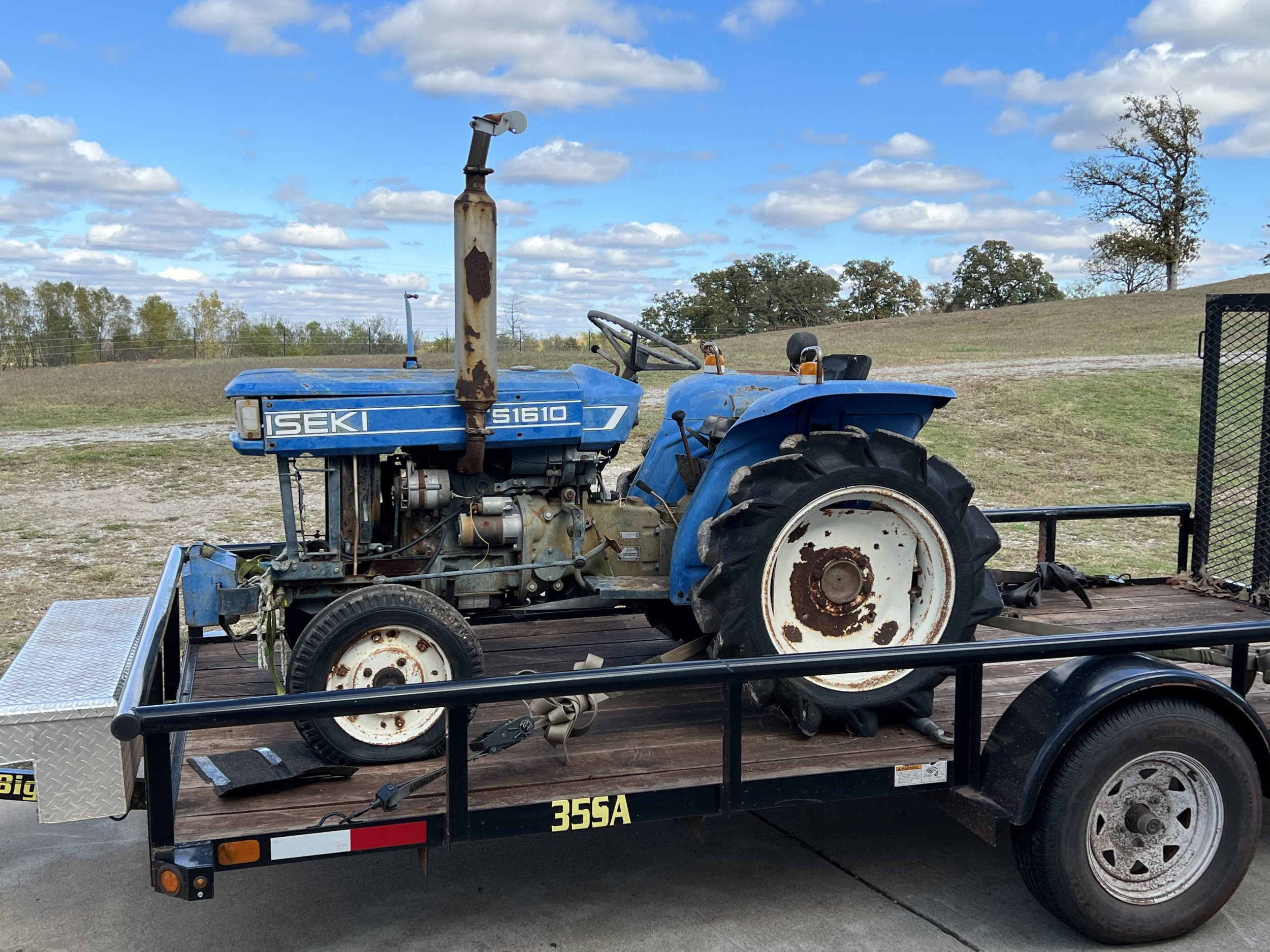

Just acquired a TS1610 2wd on craigslist for $100 complete, minus the front grill. Even has weights on the front bar.
Needs lots of attention and parts and would like to try and save it.
Seller claimed it last ran two years ago. Looks like he needed to add at least another 5-9 to that figure.
Engine is locked up and water was sitting in #1 cylinder.
Water was drained and I poured some trans fluid and penetrating oil in both cylinders.
Removed valve cover and two valves were stuck. One came back fairly easily and the other took some time but is back to "normal" now. Rockers were not rusted at all. Springs and all looked brand new.
Engine still will not turn over but will pull head and see how bad it is.
No keys so a new starter switch is needed.
It needs everything from seat to shift lever boot to front grill and obviously a engine rebuild kit.
Front crank pulley is also needed. I chipped it trying to break free crank. Stupid move i know...
The oil drain plug and oil filter are missing.
Everything else is there.

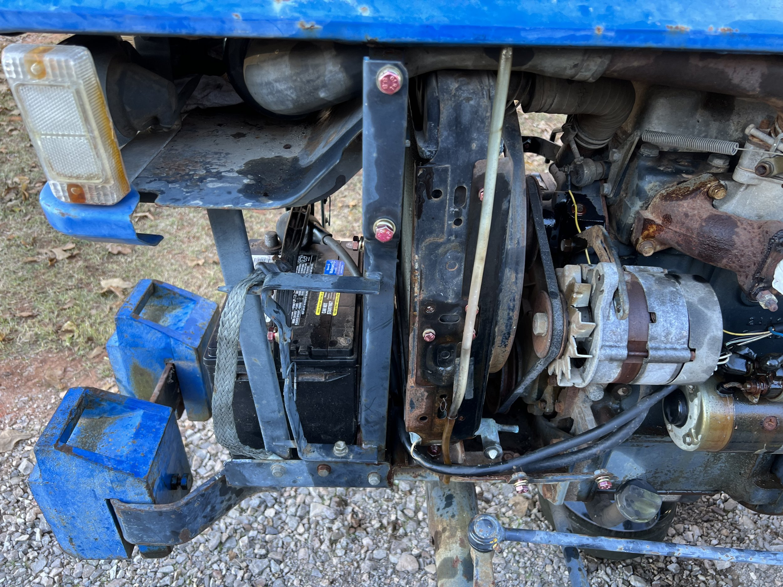

I have had a few frozen tractors I have pulled out of barns and blackberries in my younger days...
Did as you did. poured ATF into cylinders. pulled plugs or injectors and let it sit a few days.
Never try to force the crankshaft to turn by starter, crank pulley or crank pulley bolt. you break something....you are done.
We always put the tractor into low gear and one of us on each rear tire. Rocking the tractor back and forth untill something starts to move. Refill ATF and let it sit some more. Continue as needed. Some it worked better to rock in high gear. Once you get it rolling you can use the starter to turn the engine over to blow out the ATF. plugs/injectors back in and start. Its going to smoke!
   / Craigslist TS1610 acquired---Maybe too late but want to try and save it.
Yea
Lesson learned and I hope I can find a replacement pully.
Will search for the manuals and definitely try the low gear trick.
Hopefully someone will chime with parts available.
I bought all the missing bolts for the panels and screens today.
No idea what size the oil drain plug is.
Maybe Kubota has one that will work?
Lots of work to do and plenty of small parts to get
Everything from shifter boot to fuse holders to front side reflector, etc.
I love the fact it’s easy to get to most everything.

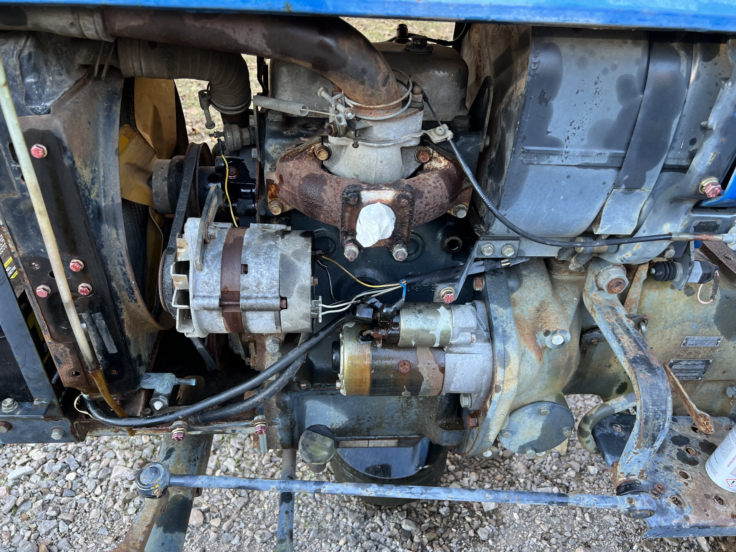

I do need to get out the two busted studs on the exhaust manifold.
The other two are probably close to it.
What is this port for?
Left side of engine below exhaust port.
Oil pressure?
Parts book shows nothing
