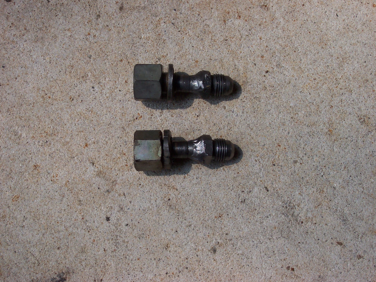

I had a hose blow out on my Jinma Backhoe (Chinese) and local, national hydraulic shop could not match up the fitting!
I welded a JIC fitting to the stock fitting from the hose and converted to something popular/easy to get.
It's that "Global Economy" they keep bragging about.
