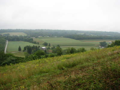

Hi TBN'ers. I'm mulling this situation over in my head. We live on 52 acres, about 2/3rds of which is a fairly steep hill behind our house (picture attached.) Parts of it aren't bad, but parts of it are, and I'm beyond a novice when it comes to tractor operation, so I basically refuse to take my small Kubota anywhere near that hill.
Thing is, my wife wants it all cut semi-regularly (a couple times a year). Enough so that she can hike on it occasionally. I'm not as gung ho about it, but I agree it would be nice.
Funds are very, VERY limited. I would love to buy a new (or used) slope-capable machine a la PowerTrac 1850 or something similar, but it's just not in the budget anytime soon.
But in my browsing, I've learned that there are rotary cutter attachments for bobcat mini track loaders (and probably others.) The local rental house has a T190. My limited understanding of these things tells me that track loaders are intended for stability on rough terrain, like slopes and bumpy areas. Would it traverse this hill safely, with a rotary cutter attachment? The rental house doesn't have the cutter, but I could swing that in my budget, and then just rent the vehicle a couple times a year for a few years until we can afford to buy one (I'd like to have one for tilling, box work, etc.)
So, does anybody mow with one of these things, or know someone who does? I'm just wondering if I'm nuts, or if this might actually be a good idea.

Forgot to attach the pic, of course.

Most of that appears quite "mowable" with your Kubota, if you're careful. I'd put some front weights on it, and mow up and down the slope. The danger is in turning, or on sideslopes.
If I were you, I'd try that, and see what you're left with that really is too steep to mow, then decide accordingly. You might find that you've gotten it down to a point that there's other alternatives, such as a walk-behind for the steepest spots...

Thanks for your thoughts. You might be right. Of course, that picture doesn't really do the hills justice (don't they all say that /forums/images/graemlins/grin.gif). Thing is, I'm not sure I want to find out if it's mowable. Call me chicken, but it is what it is. One thing that I've discovered about my tractor is that even though it has a parking brake, it doesn't do a whole lot to stop the tractor once rolling. And it's got a manual, gear-driven transmission. If it popped into neutral while I'm pointed uphill, things could get ugly in a hurry, no? The bottom of the hill is a creek, naturally. Why can't they ever just be nice soft grassy bowls at the bottom? /forums/images/graemlins/laugh.gif
I've thought about a walk-behind. Seems like it would be very time-consuming, though, even on just a part of the hill. But I don't have any experience with a big commercial walk-behind.

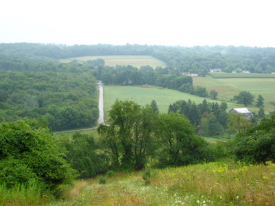

Another picture, for the heck of it. About 2/3rds of the way up the hill, looking down and across. The large building in the middle-right of the pic is my barn, I was standing near the barn when taking the picture facing uphill.

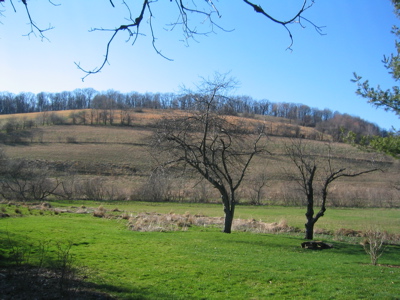

And another.

That hill looks semi-doable with a tractor. There might be some ways to make it a little safer to mow the tractor. If you are going to mow across the hill (instead of up and down) why not try rigging up a counterweight to hang off the uphill side of the tractor? Or maybe an outrigger that hangs off the downhill side? Either one might be enough to make the tractor more stable and increase your comfort level with mowing on the hill. A lot of tractors allow you to move the wheels out also to increase stability.
