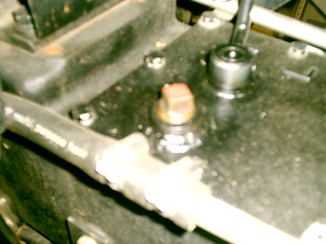

In the process of bringing my new/used tractor up to speed with it's maintenance I decided to change out the transmission oil only to discover that it's a light creamy color. I'm concerned this may be water, can someone please inform me if I'm correct or if it's something else and what is the repair. Thank you in advance for any help or advice you can provide me.

Greg is spot on. Just to clerify, drain it and replace with kero or diesel in a pinch. Drive it around for 5 minutes. Do not do any work, just drive forward and reverse using all gears if possible. Drain and refill with 80W90 gear oil.
Also, it takes a while to drain. There are 4 drain plugs total. One on each side of the draw bar mount, on under the creeper box, and another on the output of the front drive shaft. When refilling it takes a while to get gear oil in the creeper box. It has to travel though the bearing. I did a mod to my tractor and put a dipstick on the cover.
Chris
