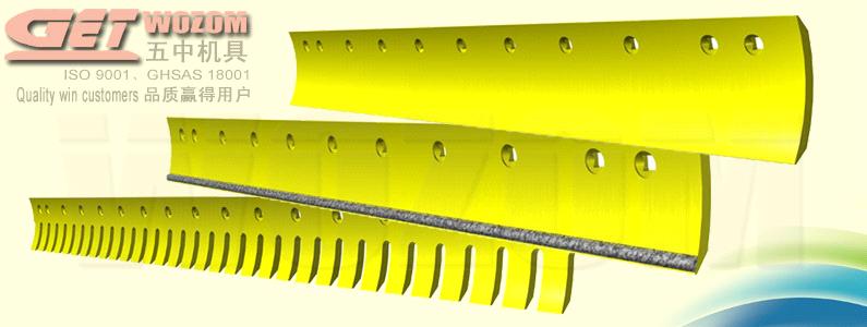

There are serrated edges available for grader blades and loader buckets, so I don't see why a homemade one wouldn't work.
Bruce
Grader:
Loader bucket:
