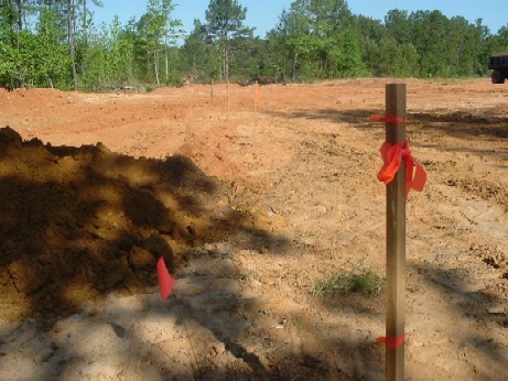

Once again I find myself homeless. I've sold my Container Barn and have to be out by Sep 1.
This time around I'm going to build on a cement pad using traditional stick methods. To keep things interesting, I'm going to do some experimenting on the finish with some ideas I have.
The workshop will be 24 feet by 30 feet. There will be a two story home with 1,000 sq ft of living area, three bedrooms and 1 1/2 baths. There will also be five full bathrooms on the side with a long covered porch.
First thing to do is figure out how much space the building will need and clear off the brush and topsoil.

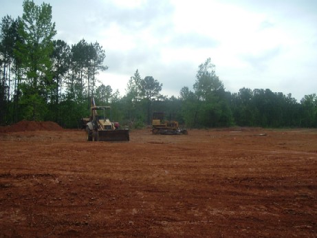

The overall size of the building will be 48 feet by 48 feet.
There is a slight slope that I've cut down for drainage and will build up for the pad.
The guide sticks are outside the pad for now with the bottom orange line indicating the height I need to build up the pad.

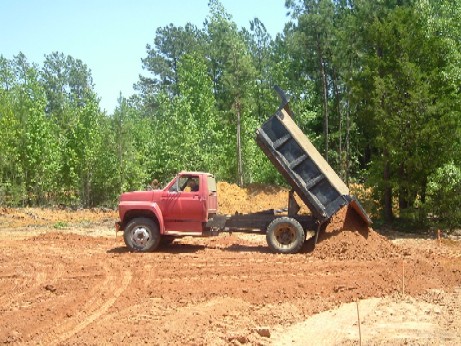

The dirt is coming from a shooting position the US Army built in 1942 to allow soldiers to fire at the targets with less then a 2% angle of fire. The mounds are 600 feet long and 20 feet across at the top. This one was only 4 feet tall at the low side and 8 feet tall at the high side. It's just a baby compared to the others.
The dirt is incredible. Clean with good moisture for compaction. I need the dozer to break it up and build piles, then the loader can take over.
This is my Dad on the backhoe.
   / Creating a Workshop & Home
With the 2X10 sideboards, I can move six yards at a time. Every four loads, I'd spread the piles with the dozer to build up the pad about an inch or less at a time. 24 yards doesn't go very far!!!
