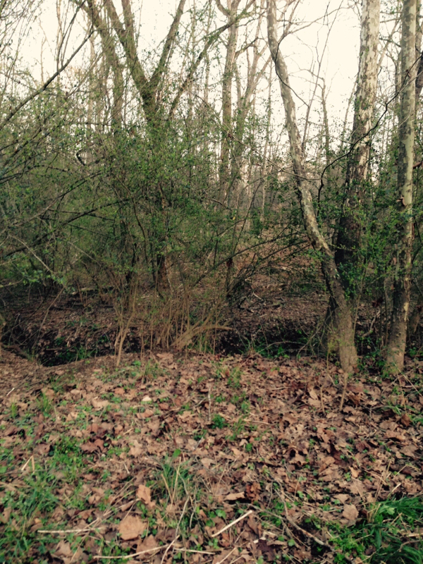

After reading some threads about people getting stuck to the frame in mud or such, I have a small creek to cross on the backside of my 71 acres. I am thinking about an 8' long by maybe 48" inside diameter would be plenty big for for a piece of corrugated metal pipe. Will this work for a 2600 lb tractor (L2501 4 wheel drive)? How about plastic corrugated? I have a FEL too so that would add a little more weight. The small creek flows year round and is usually only a few inches deep and about 6' from bank to bank where I would cross. any help with this? Thanks, Gary not wanted to get stuck way back in the mud...:confused2:

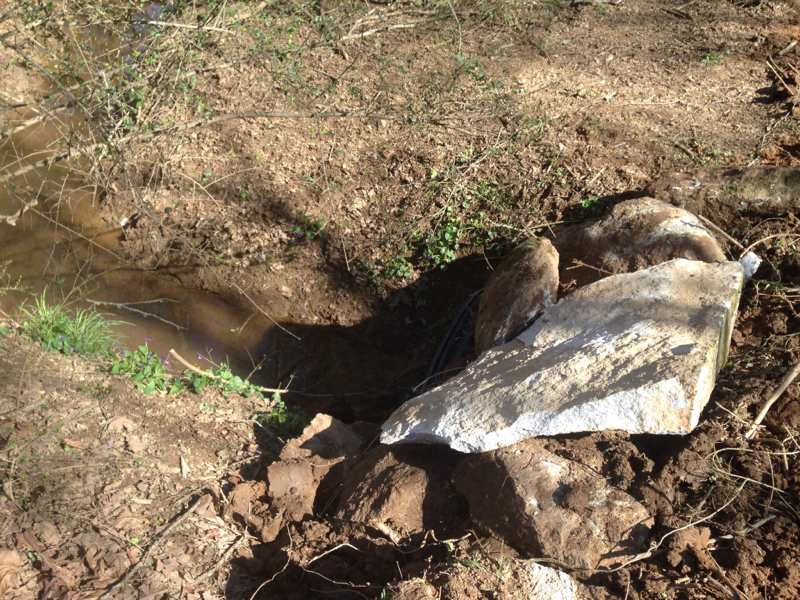

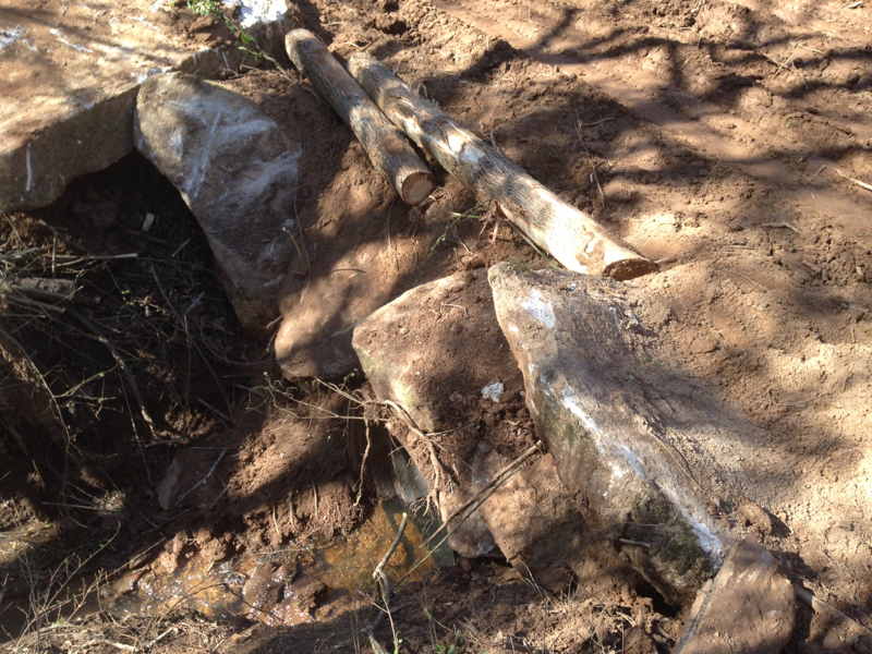

Just did that on my place. But you need a much wider pipe. I used my 48" x 20'. You need extra width for soil placement. I anchored both ends with every rock I could find in the area, some over 2000 lbs. then covered it with about 2' of soil.

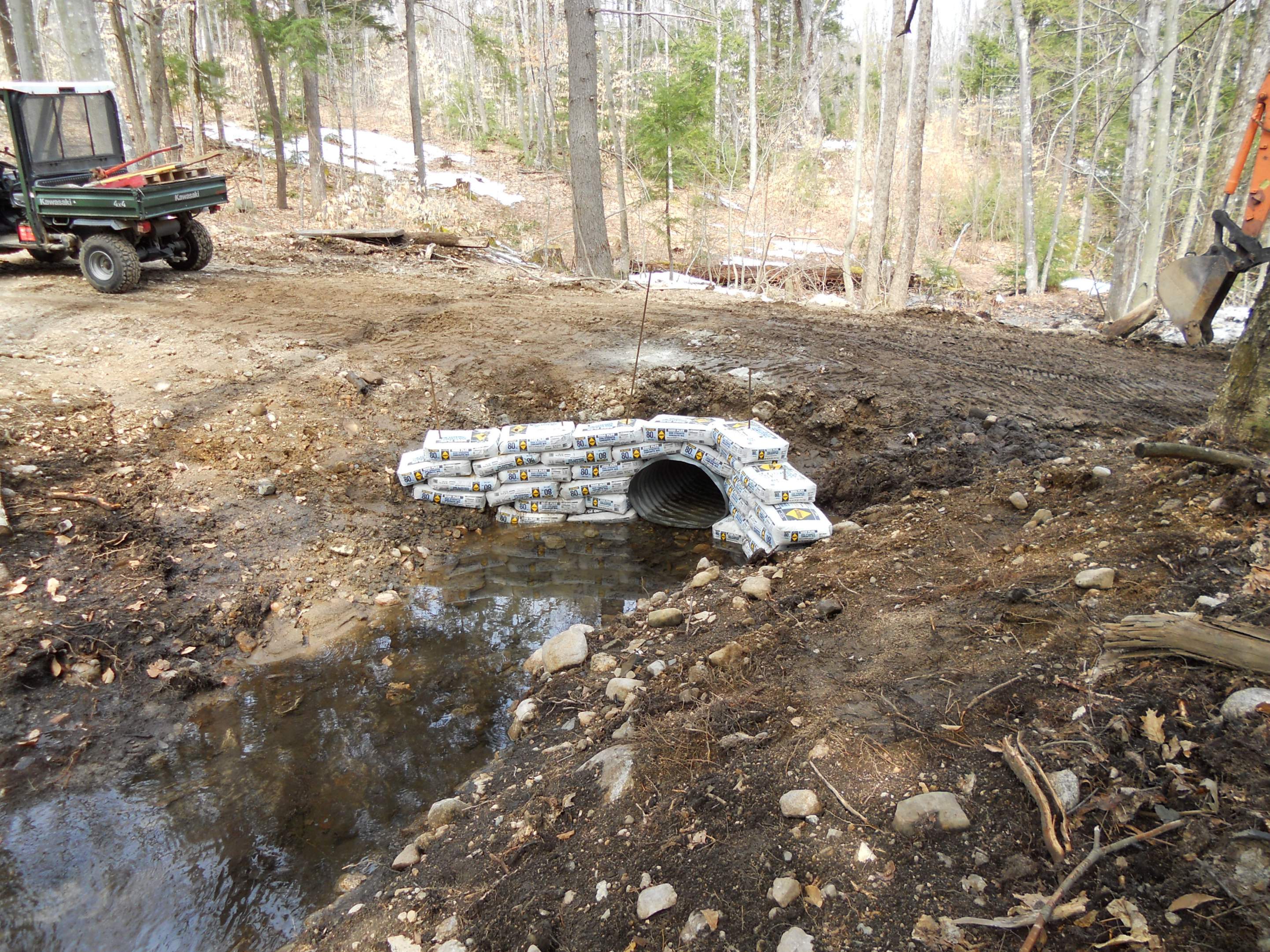

Here's an easy way to make a good "headwall" for a pipe without a lot of fancy form work. I drive #4 rebar down through the bags at various angles to knit it all together, the concrete hardens and the bag's fade out and go away over time. It is best to have a headwall at each end but very important on the inlet side.
You need a 20' legnth, you'd be lucky to end up with a narrow footpath by the time you backfill a 48" pipe.
