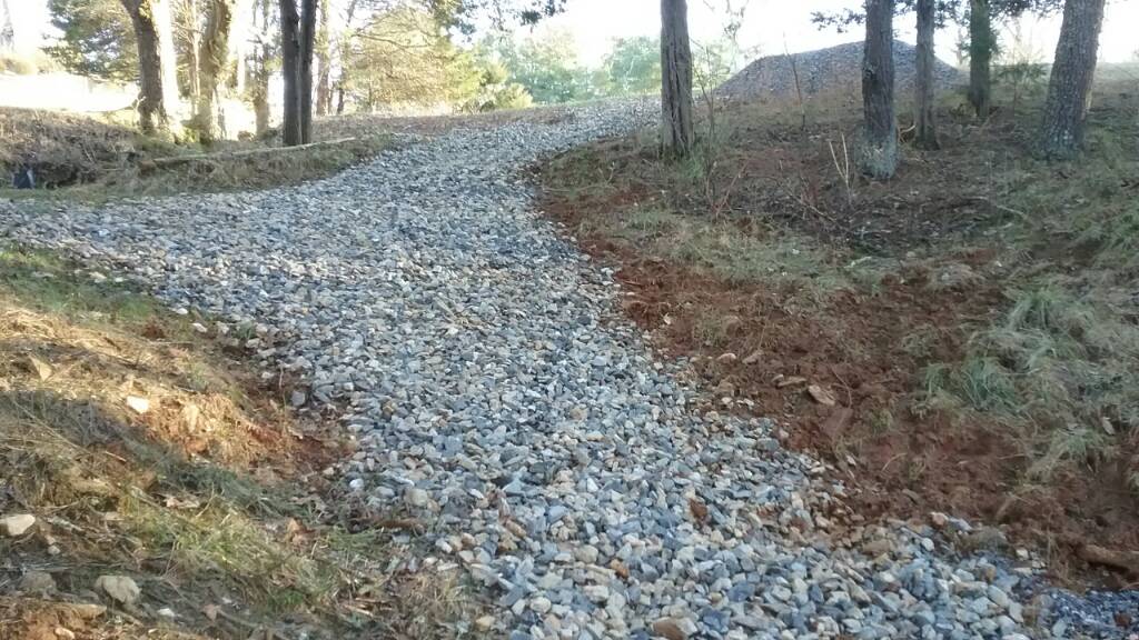

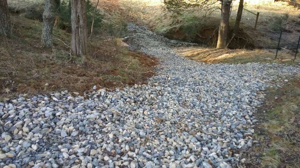

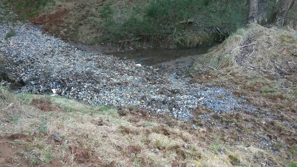

I have a creek crossing that I used two loads of railroad ballast. OK at first, water flowing through the stones but they fill will leaves and silt, so I buried a 6" & 3" PVC pipe. OK except we've had lots of rain recently which they couldn't handle.

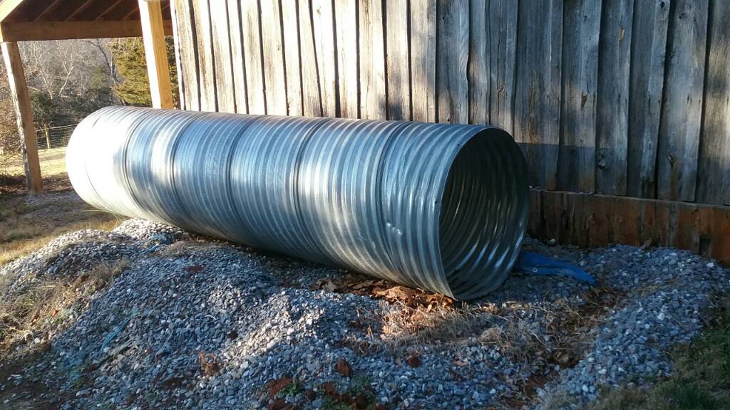

I have this 3ft. X 13ft. Galvanized corrugated pipe which should be final solution. I have a JD3038, FEL & 7.5ft backhoe which should do it.
Before I start I'm trying to figure out how to do it.
A few things...the hill going down is steep (where stone is). The creek bed which is about 10" below crossing is solid bedrock (so I can't dig deeper). The 3ft. pipe I assume I would need about 2 ft. of dirt on top with about 6" RR ballast then gravel on that? Then either side would take an awful lot of dirt going to it, especially on the steep uphill side going back maybe 50 feet (actually a good thing since my small tractor does a wheelstand going up now).
Then I figure I'd have to move all that ballast out the way first, then put it back.
Pictures are in order as I walked down hill just now. Last picture is coming back, the road is a Y...bear right goes back up steep hill, left crosses a small pond dam and much more level ground.

That's a much bigger project than first appears.
You definitely need a culvert. Yours is wayyyyy too short. 20ft minimum. Then start hauling dirt. Fill in the far side to the height of the humps on each side of the path. Bring that level across the ditch over the culvert and meet the steep grade halfway up. Going to take quite a bit of dirt. Some rough math would give you an estimate in cubic yards. Then do the math for whatever your tractor will haul. Then commit devotion and patience. In the end you'll have a great crossing.

Thanks...shame I couldn't use this 13ft one somehow though. Just so I could get tractor/bush hog and 1/2T pickup across.
I'm thinking 7ft at top would be fine? Otherwise maybe I could add maybe an 8ft larger pipe to it?

Do you have a shop or garage that you park in?
If so, block the doorway down to 7ft wide and use it that way for a week. Then we'll talk more about your culvert.
If you bought a 36" dual wall plastic culvert it'll cost $25 p/ft. $500 for 20ft.
You've probly spent that much on gravel.
   / Creek crossing & pipe project? #5
And a double wall plastic culvert will flow more water then a similar sized corrugated metal culvert due to the plastic being "slipperier" than the metal and the inside of the plastic culvert being smooth rather than ribbed.

Rent a mini track hoe for half a day, dig the rock back, place the rock on the far side of the cut in the middle of the crossing in front of you. You will need every rock to cover again. roll the pipe into position in the cut, be prepared to remove the pipe to remove more rock so it sits down in the cut correctly and has some small degree of fall on the down stream side. Then cover. As much rock as you have there you could easily borrow some else where to make it look nice again.
IMO trying to dig that even partially with a front loader on a tractor would take a long time, be hard on the machine, and loosing rock you will need. Get the tool for the job..

You have solid bedrock?
Clean off the bedrock, spread the stream flow over a larger area and drive through it.
That's the simplest plan!!!
Makes the steep bank harder to climb but otherwise is the best fix if the bedrock is solid!!!
