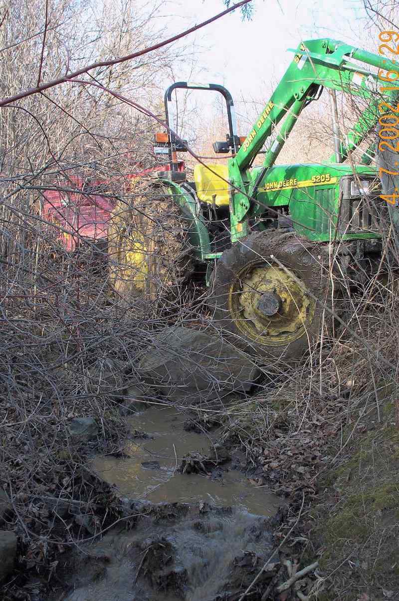

I have a number of creeks on my property and would drive my self crazy (wife says I'm crazy enough.../w3tcompact/icons/wink.gif) if I had to build a crossing for each and every one
Come up with a work around solution and try crossing the creek higher or lower from that particular spot...
{see attachment}
