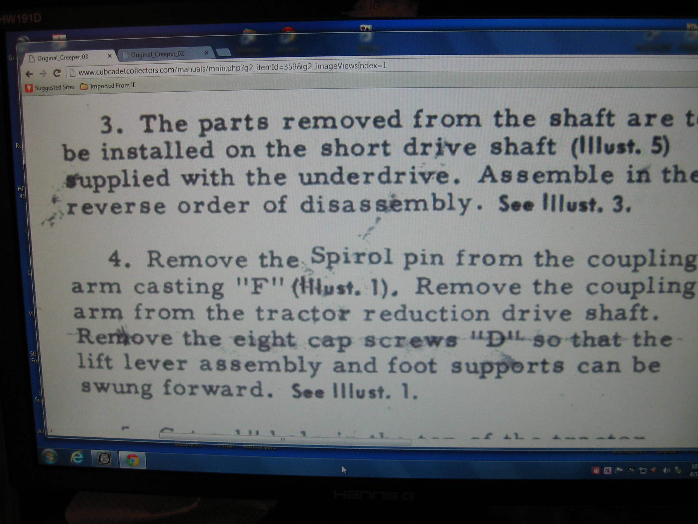

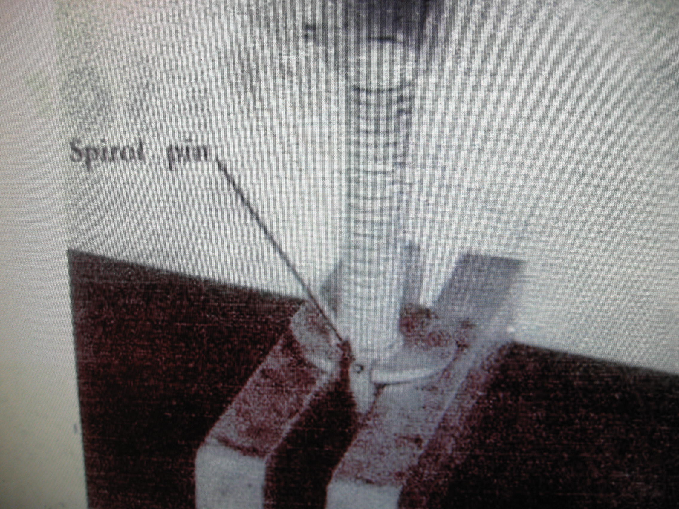

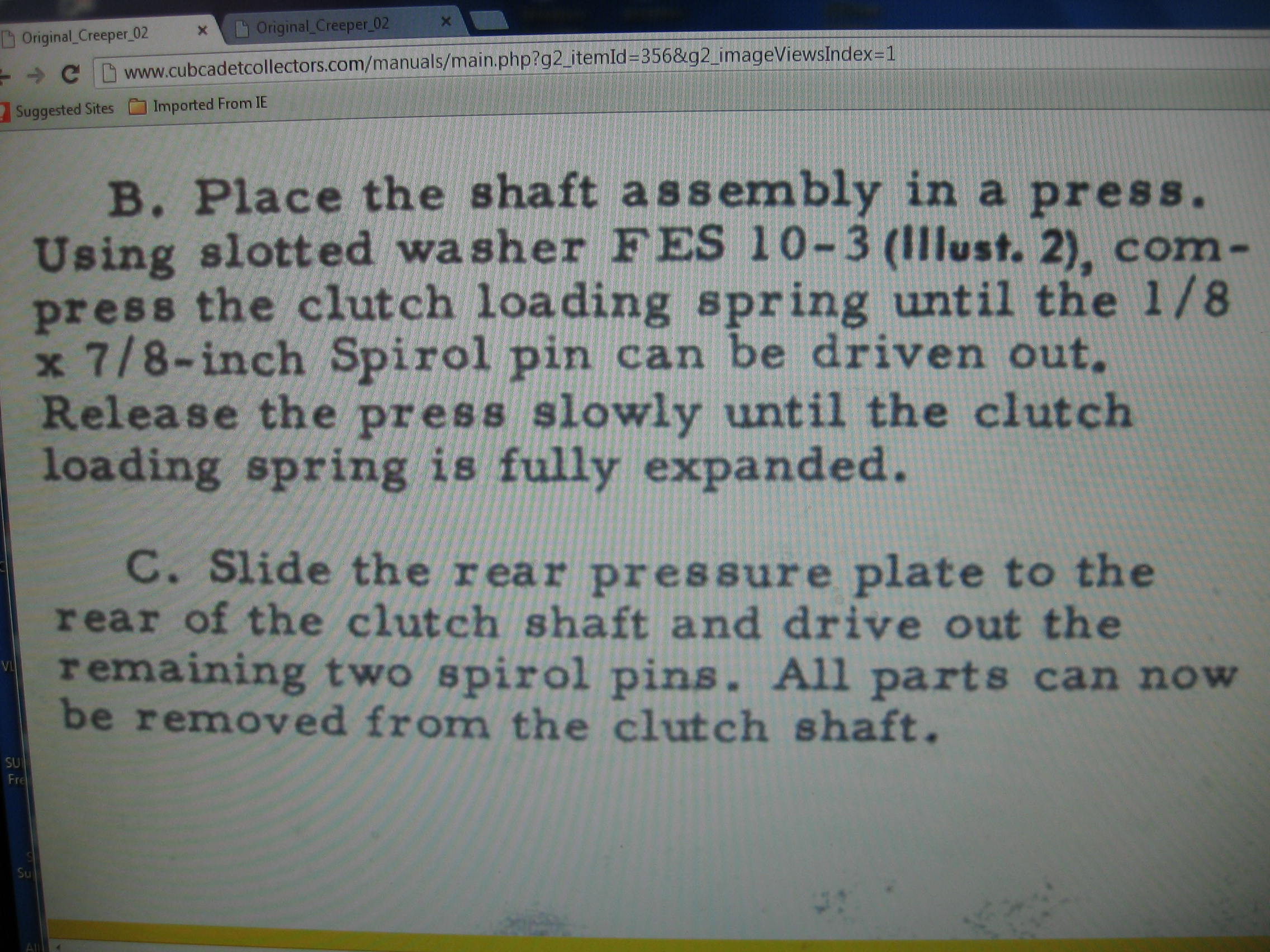

Anyone know where I can locate a "Creeper Gear" assembly attached to the drive shaft. I recently obtained the Gear but i have to remove the drive shaft (mine-OE) and cut it down then re install it to the CC124. The manual calls for placing the drive assembly into a special slotted washer (FES 120-3) to compress the clutch loading spring in order to remove the Spisrol pin. I am looking for an easier way. At some point the original drive shaft has to be cut thru a factory inscribed mark which at the present time I have not located.
The reason for the creeper gear is that at low gear the tractor moves a bit too fast in full throttle for effective operation of the 1A tiller I have.
