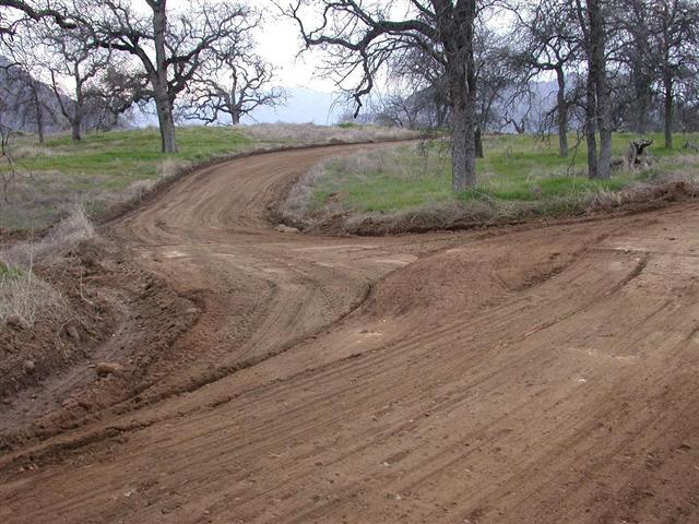

You are lucky to have ripples and pot holes that need repair. Offers more opportunity for seat time. /forums/images/graemlins/grin.gif All kidding aside, that's why I'm not going to gravel or asphalt my road. I bought the tractor instead of paying for road topping.
As far as your questions, crowning a road will help with rutting or ripples somewhat. I found it more important to do where the road rises and falls moreso than on completely flat sections of the road. The run-off has a greater chance to build up velocity on those inclined sections and do more damage.
A backblade is probably the better implement for best grading results. On the other hand, a boxblade will also do the job. Not having a backblade, I use my boxblade for all road maintenance and repairs and even to cut "gutters" along side as you were inquiring about. It has worked out well and have no need to spend money on a backblade now. In this photo you can clearly see the grading work and also the gutters.

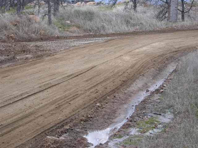

Josh,
If that's the case, standing water, I would blade the sides of your drive and cut in a gutter. With the shell and gravel there, work some of it to the center creating a slight crown. You'll most likely drive on that anyway. Try that before buying additional material. Here is anoter photo of a level part of my road after boxblading. Notice the water on the sides in the gutter area.

From my experience with the boxblade, that is correct. Even with the lower end slightly trailing the high end, it still grabs the material and displaces it away from the gutter (towards the center of the drive). I have no experience with the back blade so I can't say anything about that. But the boxblade has sides and keeps stuff from spilling back into the gutter, or widening the drive. Then I reset the angle ... not nearly as steep and grade the spillage and the rest of the road to put a light crown on it. Comes out looking pretty good and the gutters sure work.
Another super handy feature is the ability to back up, bulldozing the gutter into natural spillways...on the same angle as the gutter. On my property this was very important so the gutters didn't overflow before the water flow could reach the culverts. In bulldozing, you can set the back cutting blade aggressively and cut very nice escapes. It also pushes and levels the dirt so it makes a nice path for the tractor, never worrying about "going over" the edge. (Note: stop first). The Top-n-Tilt toplink has been a tremendous aid in positioning the boxblade for cutting or smoothing in forward or reverse..."on the fly".
I do this on more inclined parts of the road rather than the flatter parts. It is more important to do that where the water gains/accelerates and will rut and wash out your road. Another reason I like bulldozing backwards is that your tires end up on the area that has been bulldozed away so it will be nice and flat...not bumpy. Not like pulling the boxblade where it tends to ride up and down with the tractor if your tires are going over bumps. Bulldozing cuts those bumps out and you have immediate flat results.
I think this photo shows what I'm trying to explain about the spill-off areas. Notice how the slope follows the gutter slope, and the road is left up higher and smooth.
