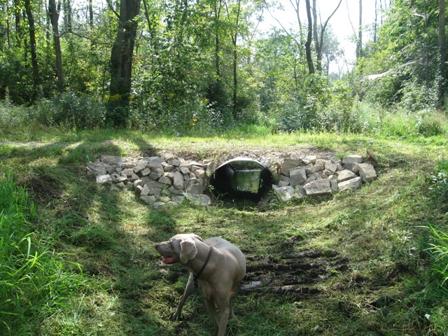

I would forego the underlayment and agree with Jay that you just need to remove the organic soil. here in Michigan, that's usually about a foot of topsoil to get to sand and/or clay. A cheaper alternative to gravel is crushed concrete(CC). Up here, it's readily available in a couple of sizes, 3" (fist-sized) or 1". It was recommended that I put down 6" of 3" then 6" of 1" on about 500 ft of driveway. The downside of 3" is that it's big enough to still have pieces of rebar and reinforcing mesh in it which will cause flat tires. BTDT. After that section, I had trouble finding the 3", so I just put down a foot of 1" CC after removing the topsoil and it's holding up great. No need for the bigger stuff underneath for residential loads IMO. CC costs about half of what gravel costs up here and packs like concrete. Usually driveways use limestone as a topping for it's packing ability over gravel but I've found CC works just as well. And I'd prefer the CC over crushed asphalt if you can get it.
I think the carpet idea is a waste of time if you've got a good base and good drainage off the road surface into the creek. It's crucial that you give the water a place to go and don't let it sit on your "paved" surface because it will make a mess of even a gravel or CC roadbed if allowed to sit.
Don't know if it applies where you're at, but up here in Michigan a "creek" is usually just part of a County drain system and if it's a designated "County Drain", a permit is required to put a culvert in it. Costs $250 and you've got to have the plans approved. In my case, they wouldn't allow side-by-side culverts like you're planning. Needed a 42" culvert but to keep a low-profile, I used an oval shaped one approved by the County. Even ordered it through them and got their discount.
Good luck.
ps, found a couple of pix of the culvert I put in. Sand on either side to the banks of the ditch and one foot over the top with a minimum of 6" of 1" CC on top of that.

Thanks, JML. Here they call CC "riff raff." Just learned that today talking to the dozer guy who is getting my road started. I'm going to need plenty of riff raff, apparently.
You know you're on a tractor forum when someone complements you on your culvert pictures! They're very nice.
