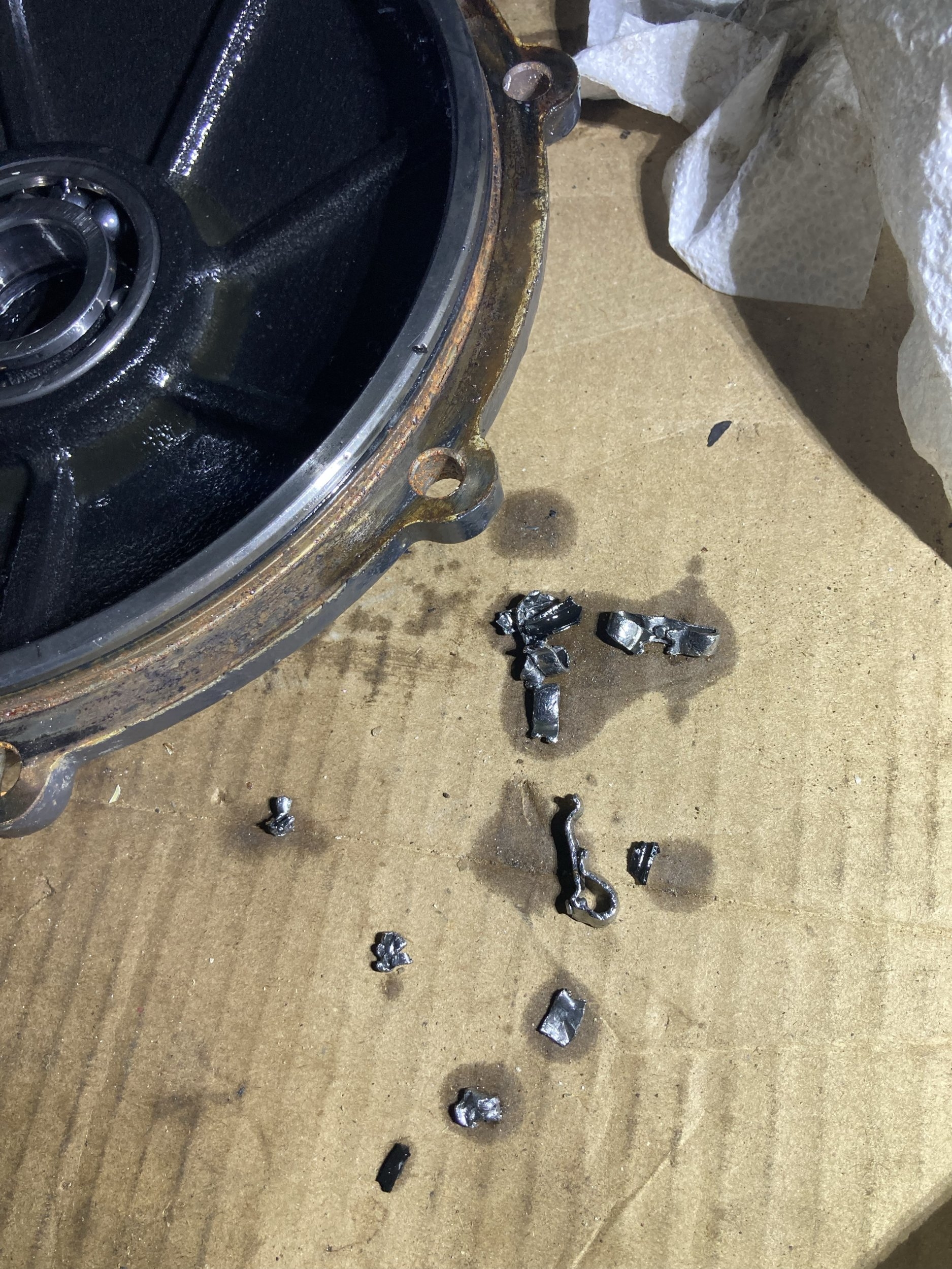

Had a oil seal leak on one of the front wheels. When I went to change the seal I found this inside
   / CT 225 front wheel bearing
#2
When I drain the oil in the front axle I noticed a ton of metal shavings. Had to change the lower bearing also because all of the bearing pieces fell to the bottom and damaged the lower bearing. This is at about 700 hours. I use my loader to its full potential and run in four-wheel-drive almost all the time. I pulled The other site apart also just to check things out and it all seems fine. No complaints from me just thought I would post as a reminder to keep your front axle fluid changed and if you see an excessive amount of metal shaving in the oil might want to pull the housings off and do an inspection. Still love my tractor.

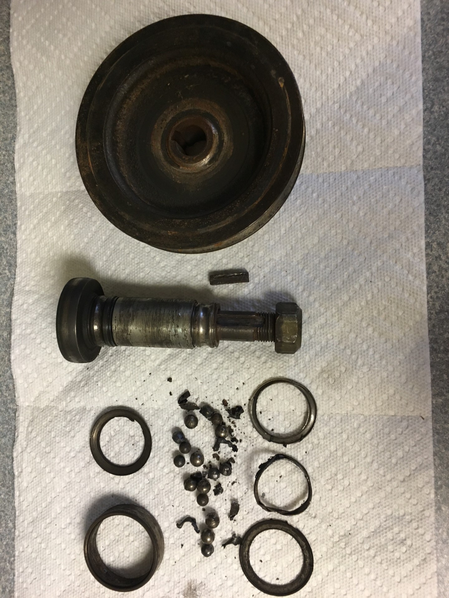

I've had several issues with these bearing on my CT122, recently ordered more.

The kicker is it always seems to be the bearing cage that fails, allowing release of the ball bearings which are the hardest material used in axles This can allow for some real damage if they find their way into any gear teeth.
