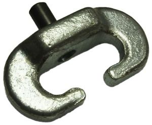

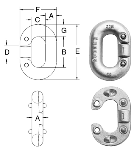

If you want to make finer adjustments to the side chain lengths, you can use side chain repair links:
or Crosby repair links:
or pin couplers:
which are shorter than the more common quick links. You can replace some of the normal side chain links with these shorter links.
I find pin couplers very handy for connecting the chain ends when mounting them. But they are not common, and some suppliers charge a ridiculous price. I was fortunate to get mine at a good price from a local supplier.
