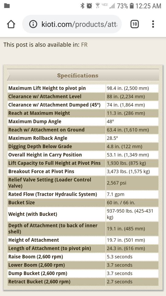

Something else to consider regarding the kioti 4030 loader is the max lift spec for 1800+ lbs is written for the 59" lift height versus maximum lift height. They make apples to apples comparisons harder in doing so. I emailed bobcat asking for full specs on the FL 7 which I have been unable to find up to this point.
From a semi related post in a semi related thread:
Have to disagree with this. The published lift capacity for the KL4030 (which I have on my CK) is not given at max height. It is 1,835 lbs at the pins at 59.84 inches.
KL43 Loader | Kioti Tractors
I haven't seen a published lift capacity from Kioti for the KL4030 at max height. Not sure why they don't give that, since they do for the predecessor KL4010.
For the Kubota L2501's LA525, the published lift capacity is 1,131 lbs at the pivot pins at max height, and 1,490 lbs at the pivot pins at 59 inches.
➤ Compact Tractors | Kubota L251 Price Specs Key Features
If the bobcat is 13xx at max height, then it may well be 18xx at 60", if a tractor which is 1131 at max height is 1490 at 59"

I was confused when you all kept referring to max lift at 59 inches. This is the specs for the KL4020 on my tractor. I'm not trying to sway you to a Kioti, just thought it was odd...
