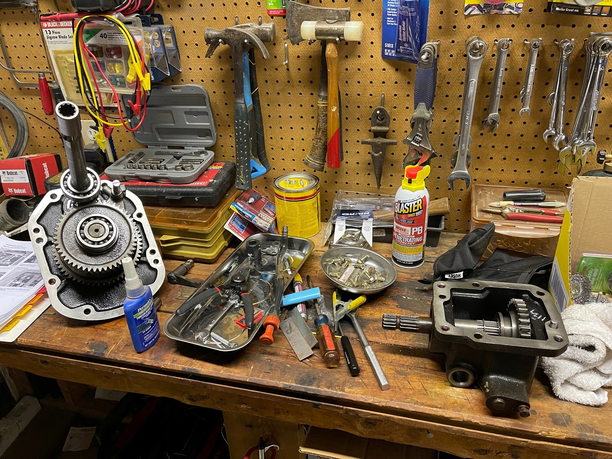

Got it apart. Was loaded with gray silicone. Everything looks great except fork bar doesn’t move up selector rod. Should be a simple fix from here. Thanks for the comments.
   / CT230 - Rear PTO stuck on.
Got everything apart and still questioning why silicone as a gasket vs. anaerobic, which is better for machine flanges. I'm ready to put everything back together and not sure what gasket to use to mount the mid-pto or the rear PTO. Any ideas? Service manual says one thing and the parts list another.

I would probably go back with whatever was on there to start with.
