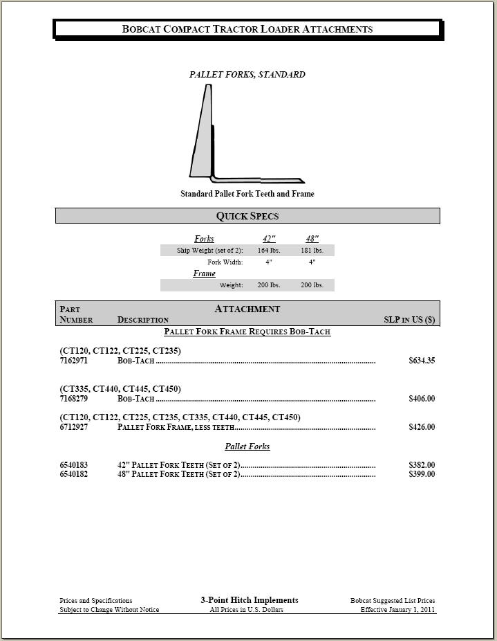

I picked up a Bobcat 42" pallet fork assmbly last week for my ct335.
The frame is 200# and the tines weigh 164#. Total weight 364 lbs.
They are a little pricey, but they do fit-up nice and look right on the tractor.
   / CT235 bobtach pallet frame and forks #4
Google is your friend. Here is what I found in my search:

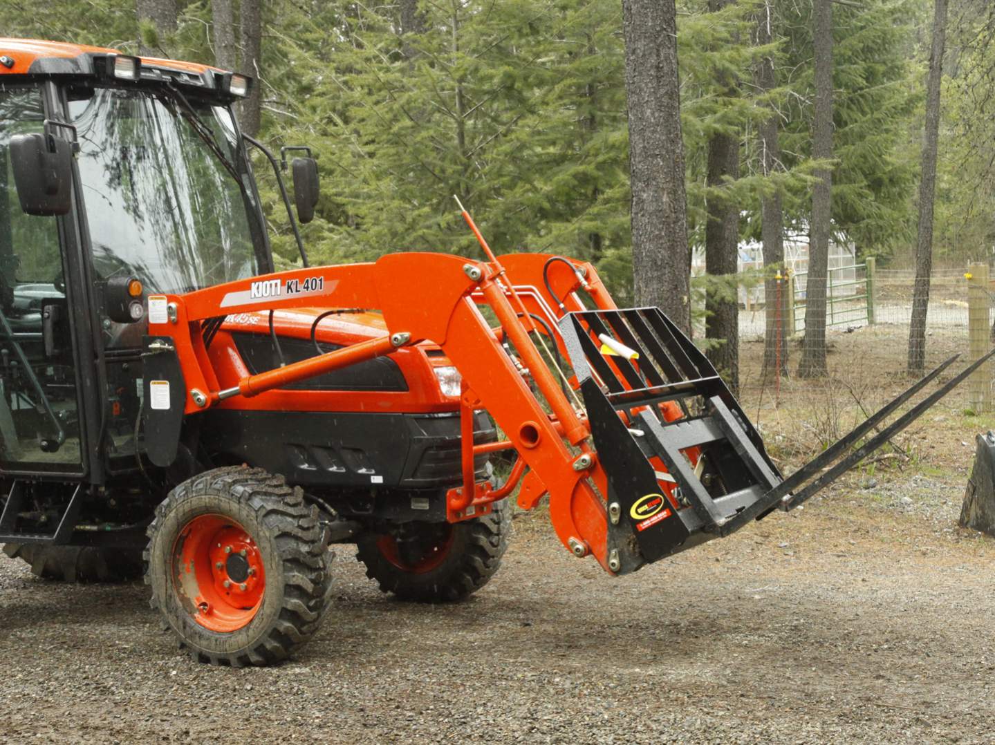

I just bought a 42" skid steer style set of forks complete with the front guard from "Quick Attach". There 42" long forks and weight in at 400# but are rated to 4,500#.
My tractor has a lifting weight of 2,700# (breakout 3,500#) so i wanted the heavier capacity.
They were $795.00
