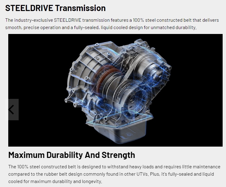

For those who haven't seen the ads yet, Polaris just introduced a 1500cc Ranger. The CVT in it uses a steel belt that is liquid cooled.
