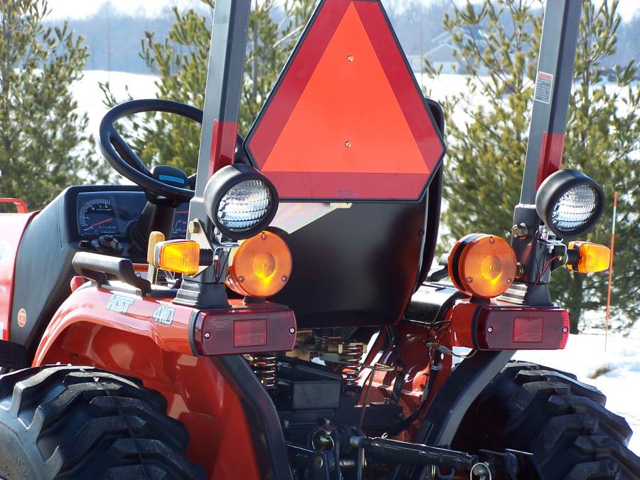

KT,
I put a couple el cheapos on my B7610 Kubota. Photo attached. The thread with a couple more pics is here.
Good luck.
