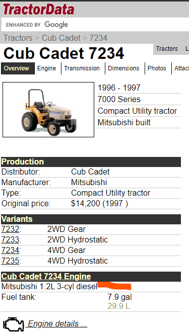

Cub Cadet tractor has a diesel engine not gasoline. I also suggest to check for good diesel flow from tank yo inj pump. Check to be sure fuel tank is venting.
Thanks for clearing that up. 🫣
