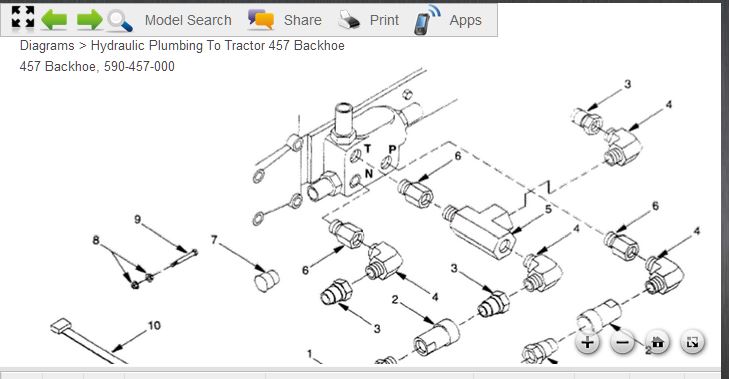

I bought my Cub 7275 Hydrostatic 4WD about 5 years ago and have really enjoyed it and work it fairly hard, it only has about 1400 hours on it and still runs like new. It has the Cub 417 Loader and a Cub subframe mounted Backhoe that works very well.
The Backhoe had been on my 7275 all it's life before I got it and when I removed it to use the 3 Point Lift, it won't work more than about a 1/4 movement. I was told it was something on the hydraulic or switch block on the lower right frame under the engine. I tried to adjust the small lever on the H block but it made no difference. Anyone have an idea how to turn on my 3 Point hydraulics on w/o going to the stealer (dealer) for adjustment and\or repair??

What model BH? By chance is this the hyd block?

After removing the BH how did you reconnect the hoses?
Apparently you have flow, but bypassing the 3pt.
If you have three hoses in the rear, it is possible that whoever reconnected the hoses caused the PB fluid to go to the reservoir instead of to the 3pt.
If you can , follow the flow path from the pump and trace the lines. For correct operation, the fluid should flow through all valves in a series path.

Miy block is similar but has the hoses connecting directly w/fittings. It has a lever on the large side that is about 1"-1.25" long. Tried the lever in both settings and no difference either way.
The two (I believe) BH lines were disconnected by the Quick Connect slide fittings that seal automatically kinda like airhose fittings but larger. I'll have to check again but I don't think they are long enough to connect to each other and they are different sizes so it wouldn't work that way anyhow..

Did you figure out the problem.
You probably need a jumper for the BH QD's .
Do the other hyd seem t be working.
Do you hear a relief valve whining.
