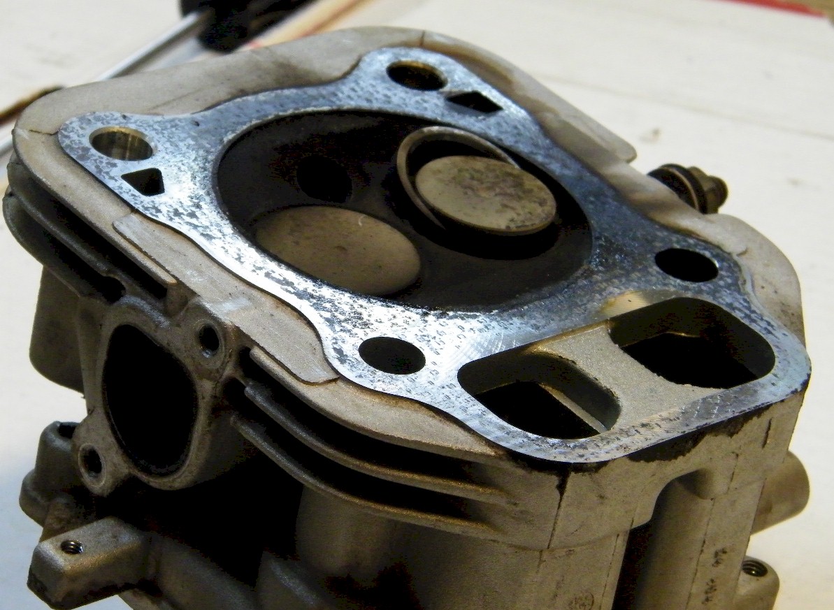

I am posting here to maybe help out anyone that might be thinking about any CC product with a Kohler engine. I bought a 2500 series Cub with a Kohler 20HP twin. This was a premium product, not a Home Depot homeowner special. It's always had problems and quirks, but at least it ran. Until today, with 135 hours since new, it's had a major engine failure. An exhaust valve seat fell out, jammed the valve open. The piston is damaged, along with the head, valve, push rod. Add in gaskets, smalls, and labor, transport, etc... and you're talking about a big bill. Plus, no mower for some time.
Take this for what it's worth. I've never been happy with the Kohler product, for several reasons. Today, I am particularly unhappy with it. It's a waste of raw materials, and it's the reason smart folks no longer buy USA. Spend your money where you will, but for me, I would never touch another Kohler product. A $ 1500 engine should last more than 135 hours, and if it doesn't then there should be a warranty to back it up. Should be.
Here's a pic of the head:

It's not the Kohler Courage, it's the Kohler Command. As far as brand bashing, well, this is a cheaply made product. It was expensive to buy. During disassembly two bolts broke off in the casting, all four were over-torqued during assembly. The carb mixture is not adjustable. It can only be run at one speed. It uses alot of fuel. It backfires everytime it's shut off. The valves are intermittently noisy. It came from the factory with the engine speed mis-adjusted (cub cadet's fault?). It has always run hot. It lasted 135 hours, and now it's dead. Those are all facts. Maybe I expected to much.
