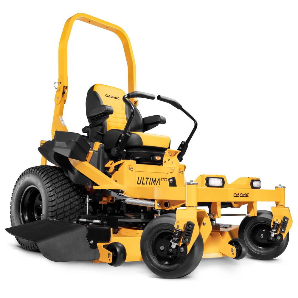

Would I buy a commercial grade Cub Cadet? I don't know. I don't think I've ever seen a pro using Cub Cadet but based on my experience with this model I certainly might. Maybe this 60" model:

Sounds about right. I have the ZTS 1, and love it. No issues with belt though.
I do like the front wheels not being caster style on mine. Kudos on the lack of plastic. I love that part as well. I did just order a pair of 3" seat springs ( fits an older Harley) to aid in ride. Cheap enough guess to a better ride.
If I had to buy again, like if mine was stolen, I'd go for a ZTS 2

N80, how is your seat switch? The one on my ZTXS5 is oversensitive to the point of annoyance.
   / Cub Cadet Ultima ZT2 54" zero turn brief review.
It is a bit too sensitive. Even if I lean over a little it starts to cut the engine. But, it hasn't really caused me any problems.
