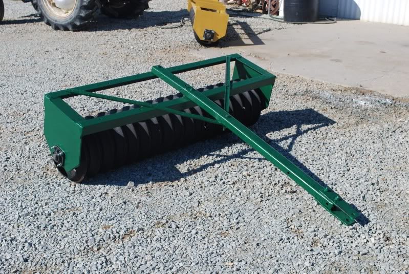

Ended up being pretty expensive. Over $1000 for 2 junk cultipackers($300), steel($650) bearings($130), bolts, and paint. Finally finished them... Turned out three, keeping one for me and selling two to hopefully break even.
These two are going up for sale to cover materials and hopefully some pocket change for 3 days of time...:confused3:
5.5' trailer type (3" x 1/4" angle iron frame, 3/8" plate steel, greasable flange bearings)
7' heavy duty 3pt (cat 1) (1/4" 3x3 tubing frame, 1/2" plate steel, greasable flange bearings)

Very Nice. They look great. I really like the yellow 7'er how much do you think it weight's
Where did you get the bearings?

Real nice job on all of them but I really like the 7'er. Looks store bought if not better. I think a new 7ft is around $1500 so I think you did alright once you sell the others.

i believe u could sell them and not only break even but make some money those or really nice where i am at the little new ones bring 2500 dollars and a used one brings from 750 to 1500. i would think the larger 7 ft should be worth atleast 1500 atleast where i am at everybody is looking for them to do food plots. but u made some really nice ones thats for sure

Well, I put $950 on the big one and $700 on the little one. Maybe they will be gone soon.:thumbsup:

that is a good price they should be easy to sell since the little ones at tsc or 1000 and the big ones or 2500. u did a really nice job the yellow one looks factory built
