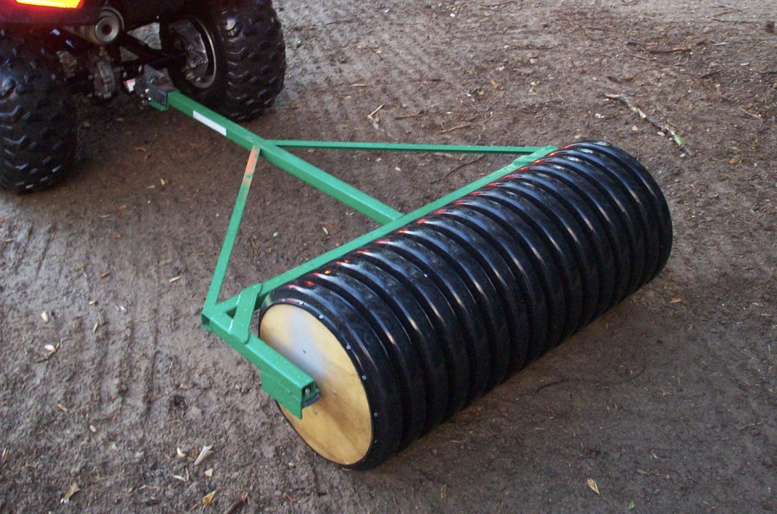

38E956EA-57F1-428F-BE28-F5A357740F92.jpegI’m looking to make something like this drain pipe filled with concrete.

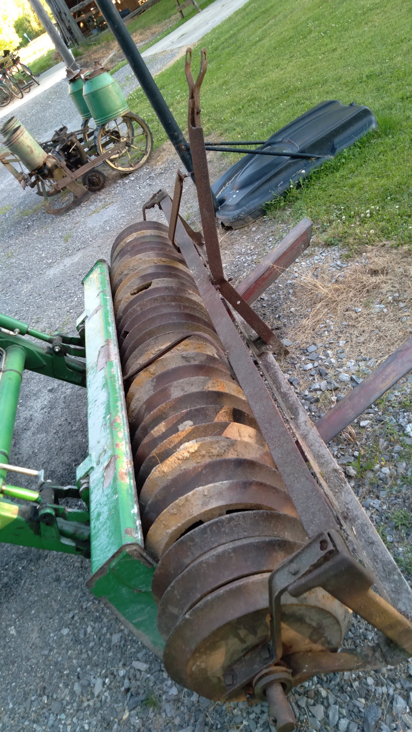

Keep on the lookout for used cultipackers. They were tough to find for a while, when scrap steel prices were real high. Now that scrap steel prices are low, they are much easier to locate.
A neighbor dragged a couple old rusty ones out by the road last summer, by my place in western NY. They were both 8 feet wide, and in rough shape with bent up frames, missing bearings, and had some busted wheels. I stopped and asked about the better of the 2, and the woman let me have it for $ 40.
Only 2 of the iron wheels were broken, and I will need to make new wooden bearings for it. They are easy to make from white oak or pressure treated 4 × 4's. The frame also needs straightening. It should only take me a couple hours to make it into a fine, serviceable 7 footer.
I already have a 7 footer at my place, that I rebuilt similarly about 20 years ago (I traded the guy a case of beer for that one). I need the new one over at my folks place, about 15 miles away. I have been getting by over there, dragging a log, chain link fence, or using my dad's side by side wheels to push in the seeds. That works, but not nearly as well as a cultipacker. I get very uniform seed germination at my place, but spotty over there.
Some folks use lawn rollers or culvert pipe rigs like that pictured above. Those might be a step up from chain link fence or log drags, but still not as effective as a real cultipacker. A cultipacker has extra clearance between the wheels and the axle which lets the wheels move up and down independently over uneven ground. The culvert pipe and lawn rollers are all one piece, and lack that independent wheel movement feature.
