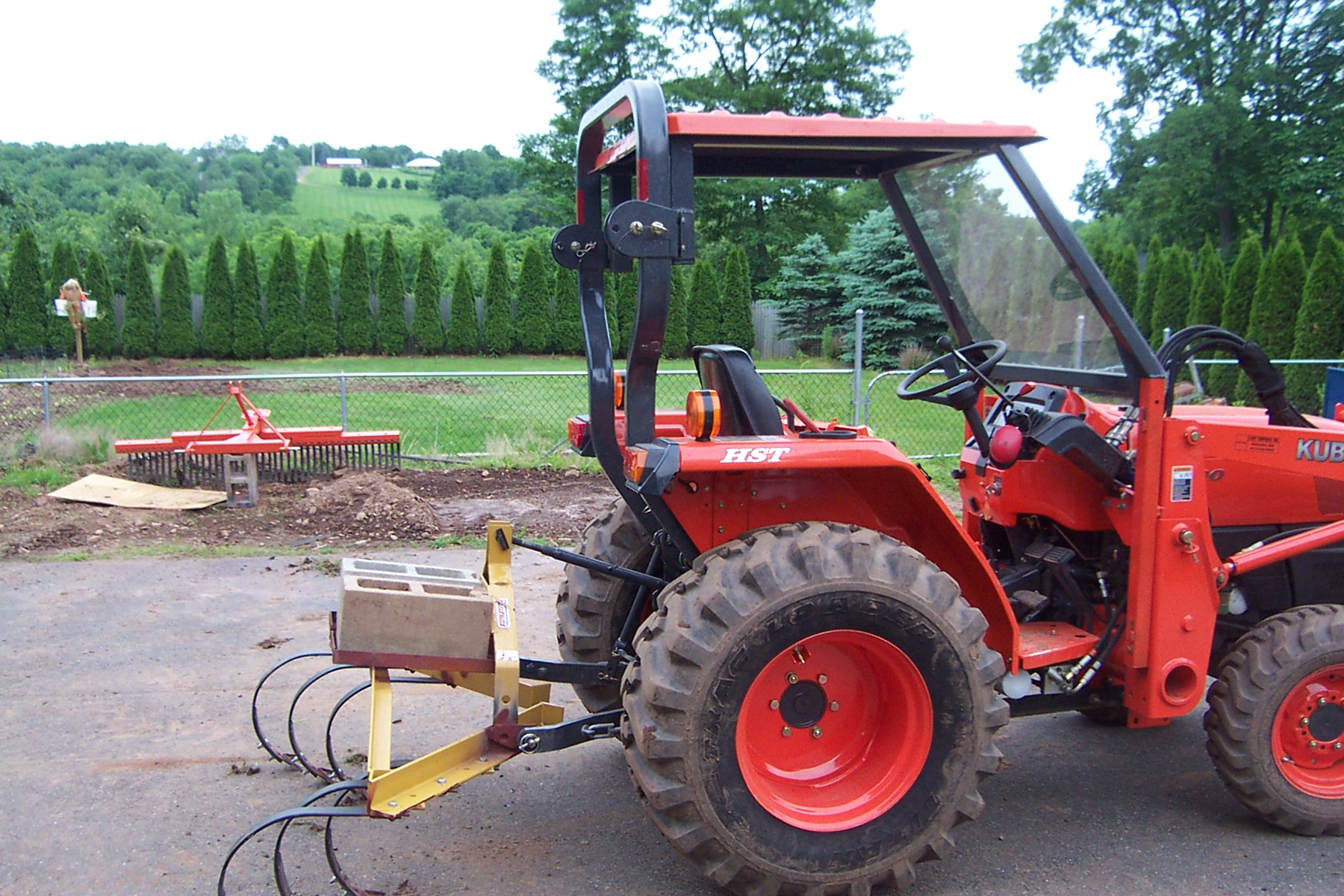

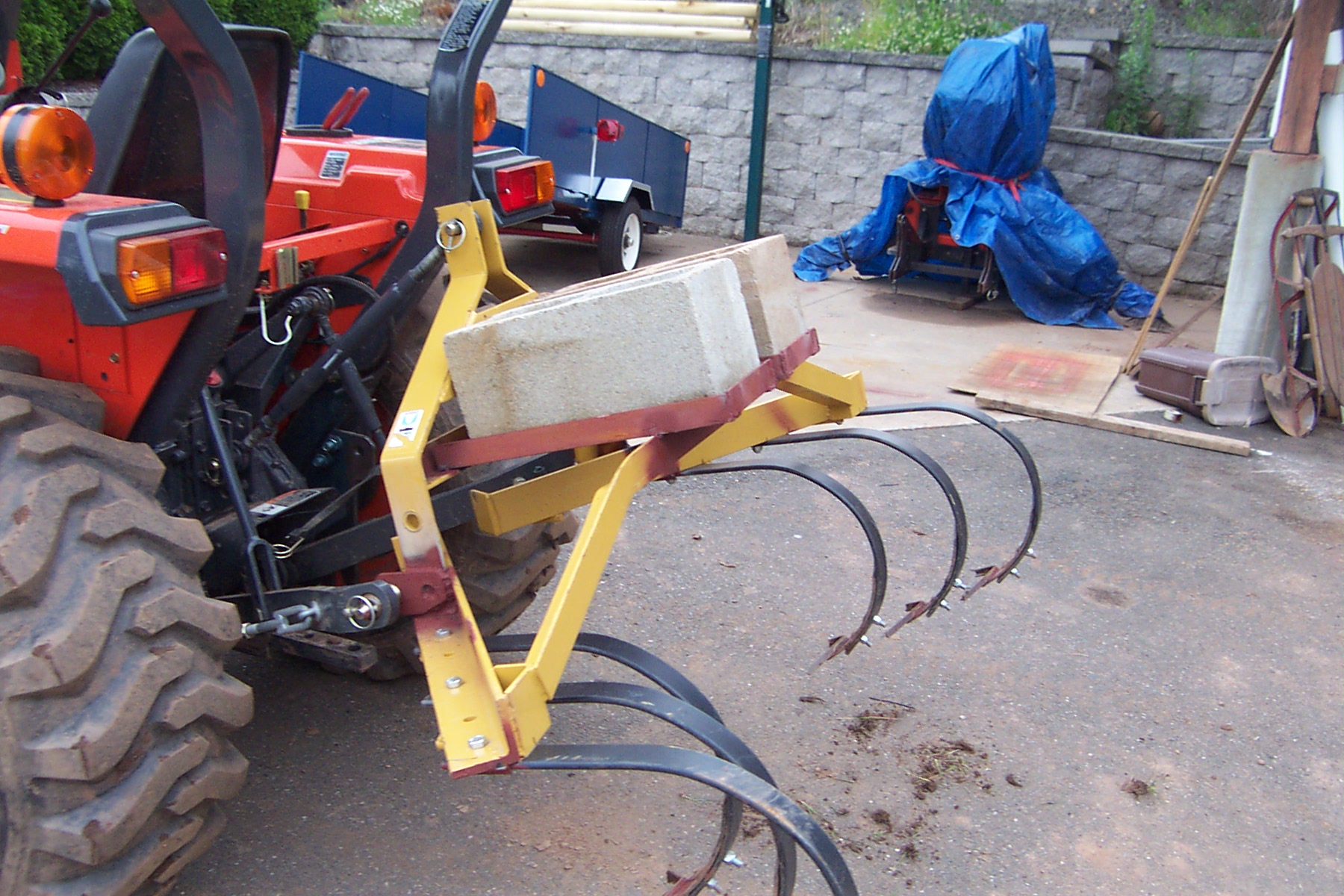

How can anyone function without a welder?

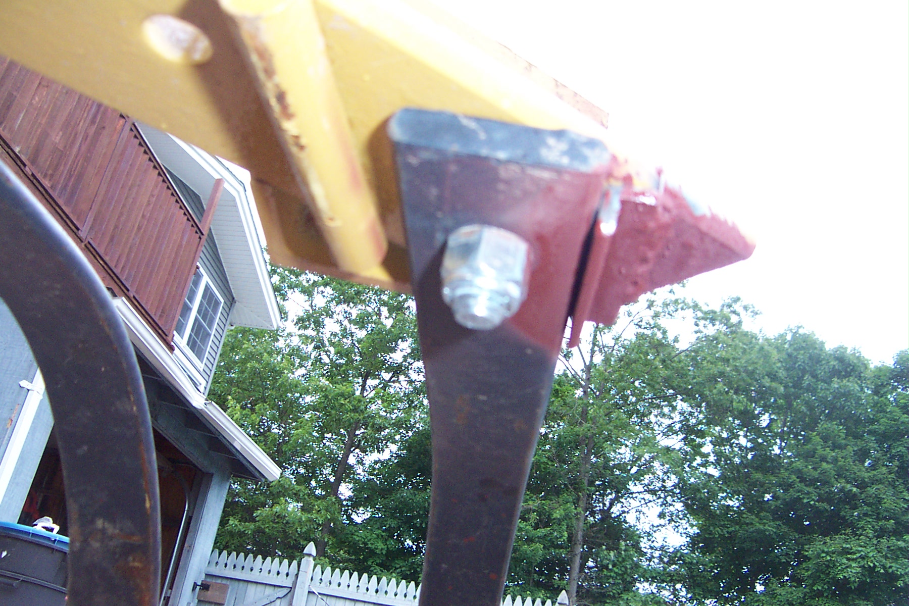

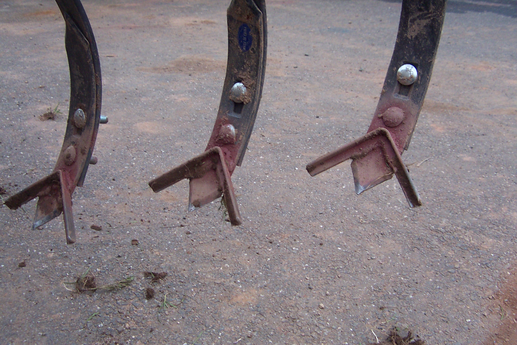

I was thinking of driving an hour to TS to buy sweeps, but these larger cultivator sweeps angle the wrong direction.(according to me) I need them to get after the weeds. So I made my own with a small piece of angle welded to the tip. These tip are all business when it comes to weeds.
And lastly I welded some better alignment guides. My guides get close and kiss the spring steel. Not like the guides that come on it, which are a 1/4 inch away so the guides allow the tip swing from New York to Detroit.

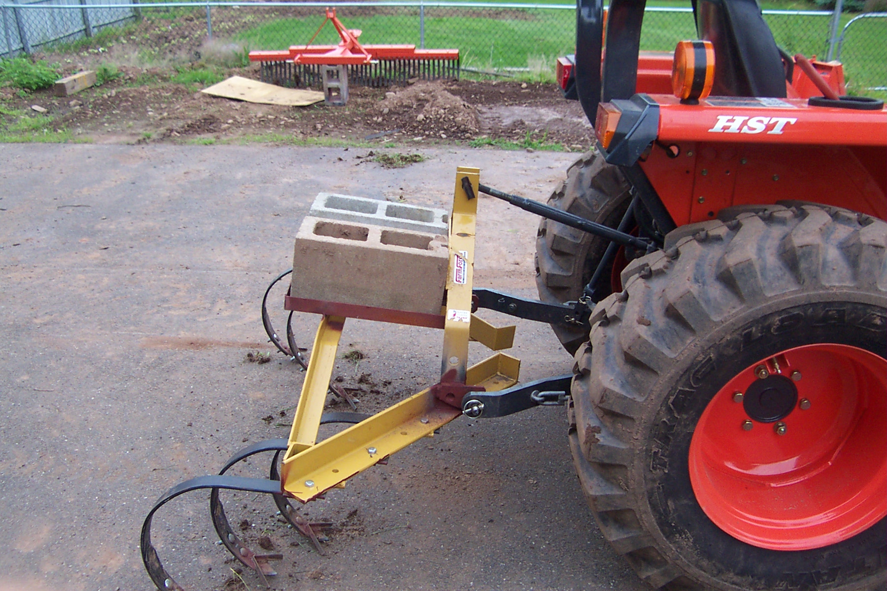

Oh, and 2 cinder blocks are just the right amount of weight.
