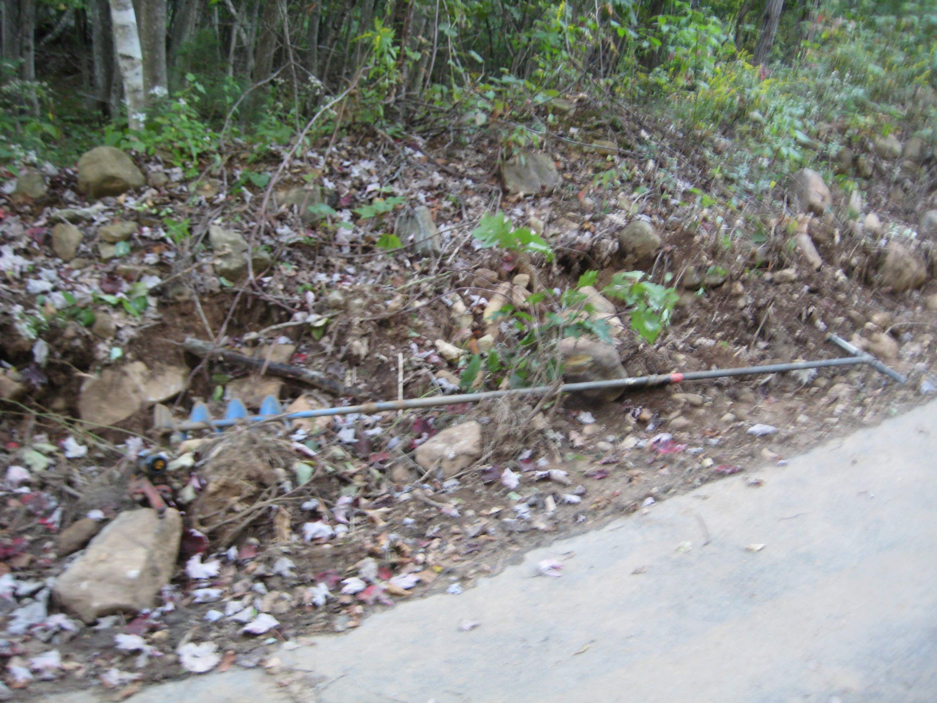

I am fixing drainage issues on my driveway and I dug up the entrance and exit of an old culvert underneath our paved driveway. It is packed solid with sand. It is too far from our house to get a hose up to it and flush it. I am debating getting threaded rod to push the sand out. I do not have any access to power up there so renting a power auger is out. This culvert is only used a few times a year when we get hard rain and a spring pops up but it moves a huge amount of water away from our ditch that runs another 800 feet to a large culvert. I plan to dig deeper around the entrance so that sand will not clog it .

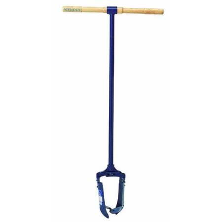

What about a gas powered auger? There's a couple types of manual t-handle post hole augers as well, some with a spiral twist like an icefishing auger, and some with a pair of curved sides that meet at the bottom. This latter style uses pipe for the upright section of the handle, so if you need a longer handle you just unthread the head and add in a union and another length of pipe.
My whole lot is basically sand, and while it will stop on egg- to fist-sized rocks, I much prefer it to the two-handle types (I still have to resort to those sometimes if I can't get a rock out with the other).

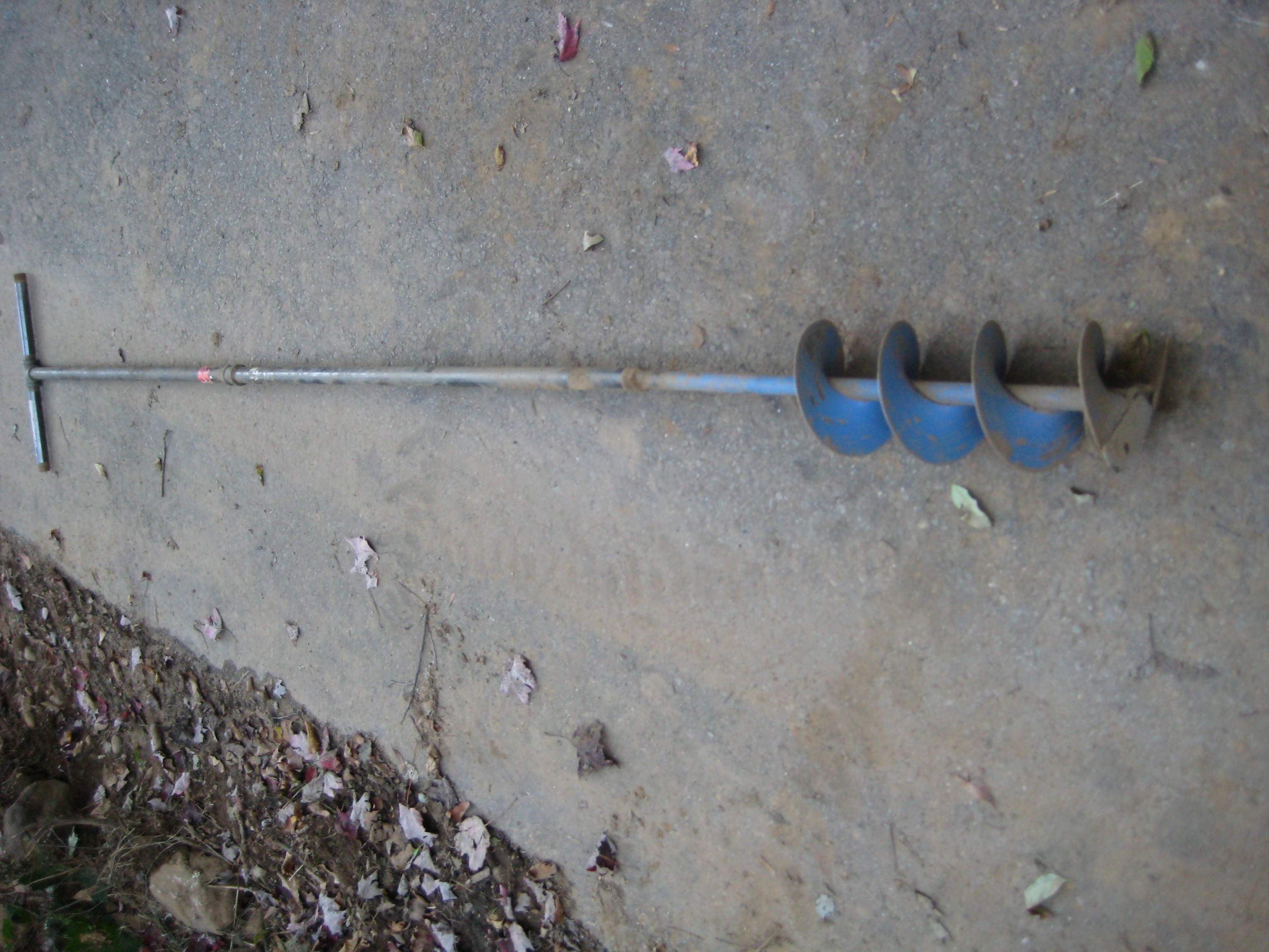

Well I came across an ice auger in a scrap pile. I cut the handle off and welded it to a 4' piece of 1" schedule 40. I added another 4' piece with a coupler and used a tee with 2 1' pieces for a handle. It works like a charm. I just need to back out to clear sand every now and then. Perfect for the small culvert

Awesome, glad you found something that works.

Its gonna keep getting clogged up since its only a 4 inch pipe. It sounds like you have the volume of water to run thru it, but not the velocity to keep it clear. your choices here for long term fix is: 1. upgrade it to a larger culvert size 2. do away with pipe since its only a 4 inch and use a box with a removable top so you can clear it with a hand shovel 3. dig a large silt pond before the water goes into the culvert 4. or just keep what you are doing since you already created a cool tool to clean it out yearly.
