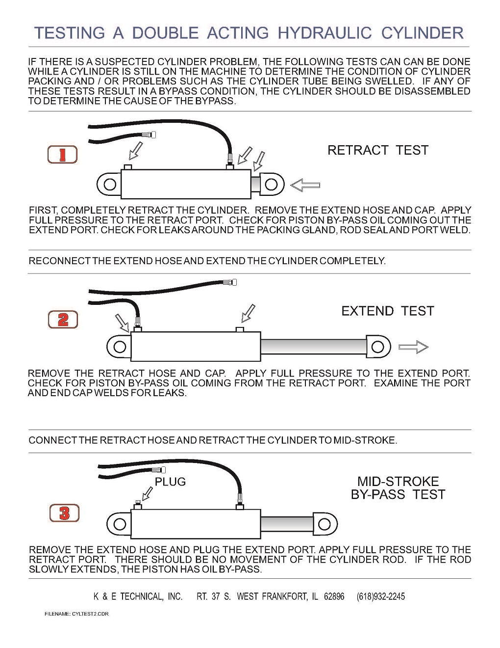

I don't know much about this but learning, please help! Curl and bucket wont maintain position and go down in a matter of seconds. Bucket lifts fine. Curl is slow. NO LEAKS. My main concern for now is the curl as it is the worst. This is a terramite T5c backhoe. Is there a way to test cylinder I can do my self ? THANKS FOLKS!!!

If you follow thew attached instructions without any shortcuts you will identify where the problem lies.
Likely internal to the bucket cylinders around the piston.
You need some caps to seal the hoses for the other bucket cylinder so you test them one at a time.

Hey thanks Dave ! that is perfect ! I really appreciate you taking the time to send me that !!!!!!!!
