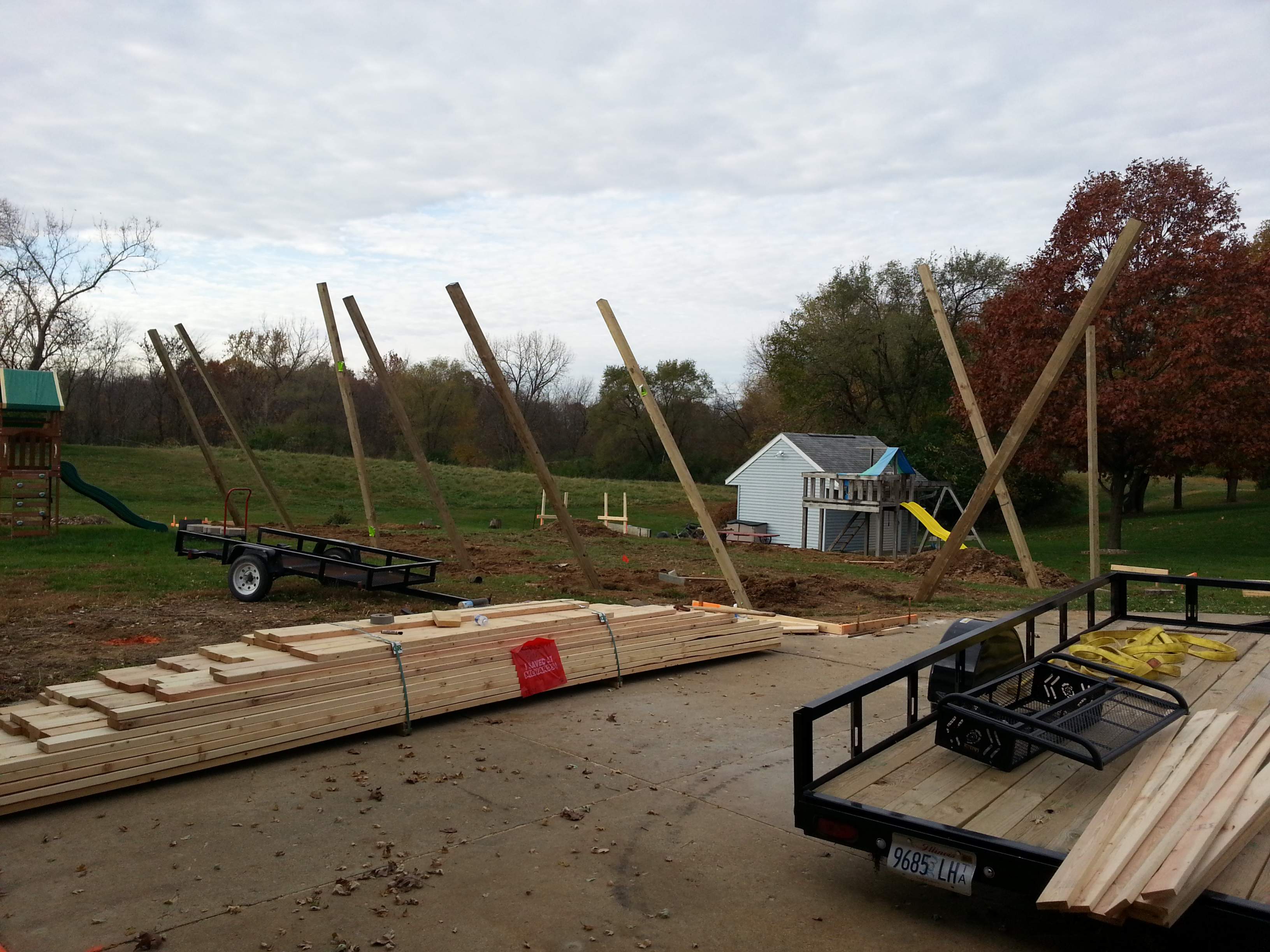

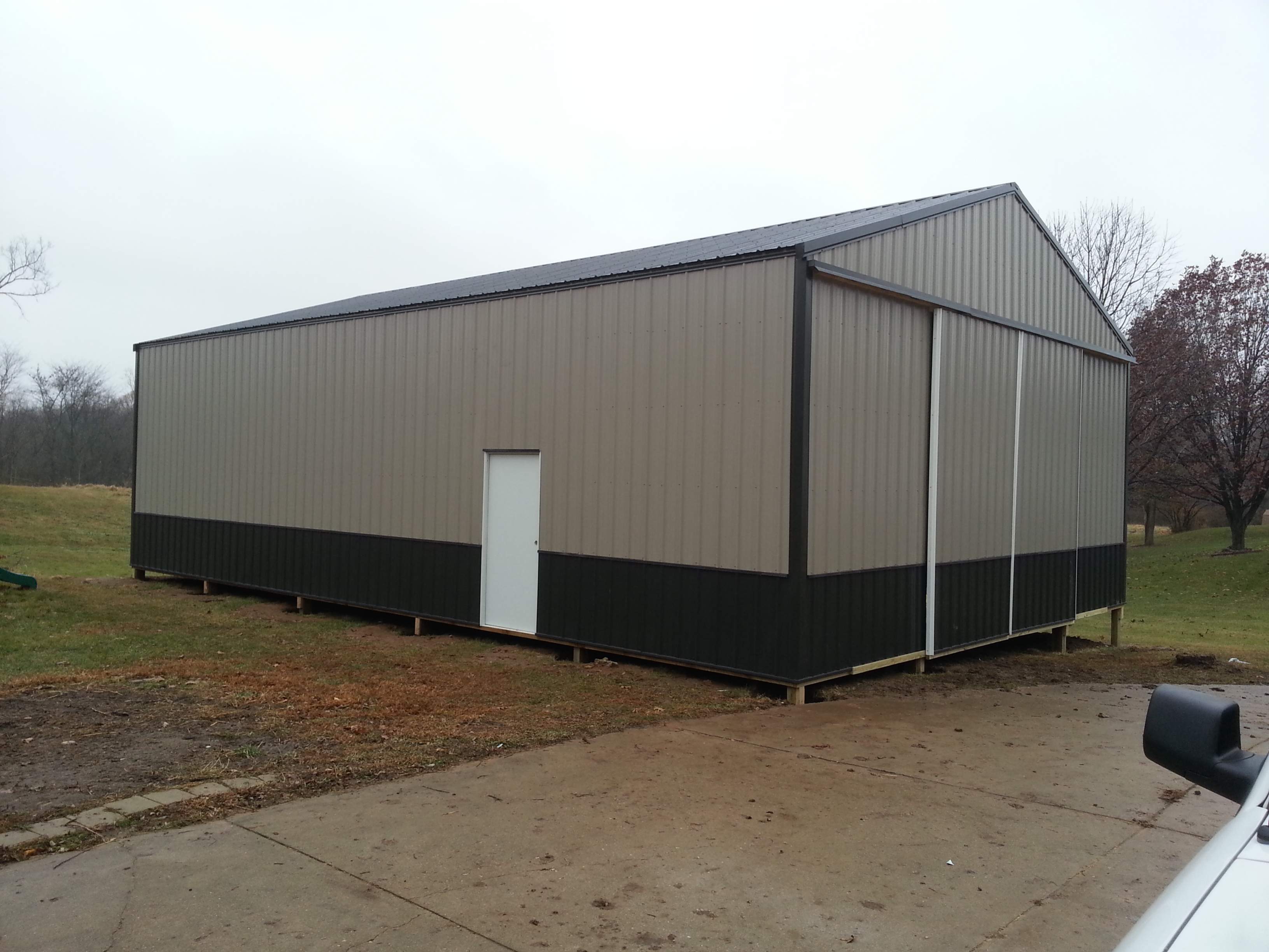

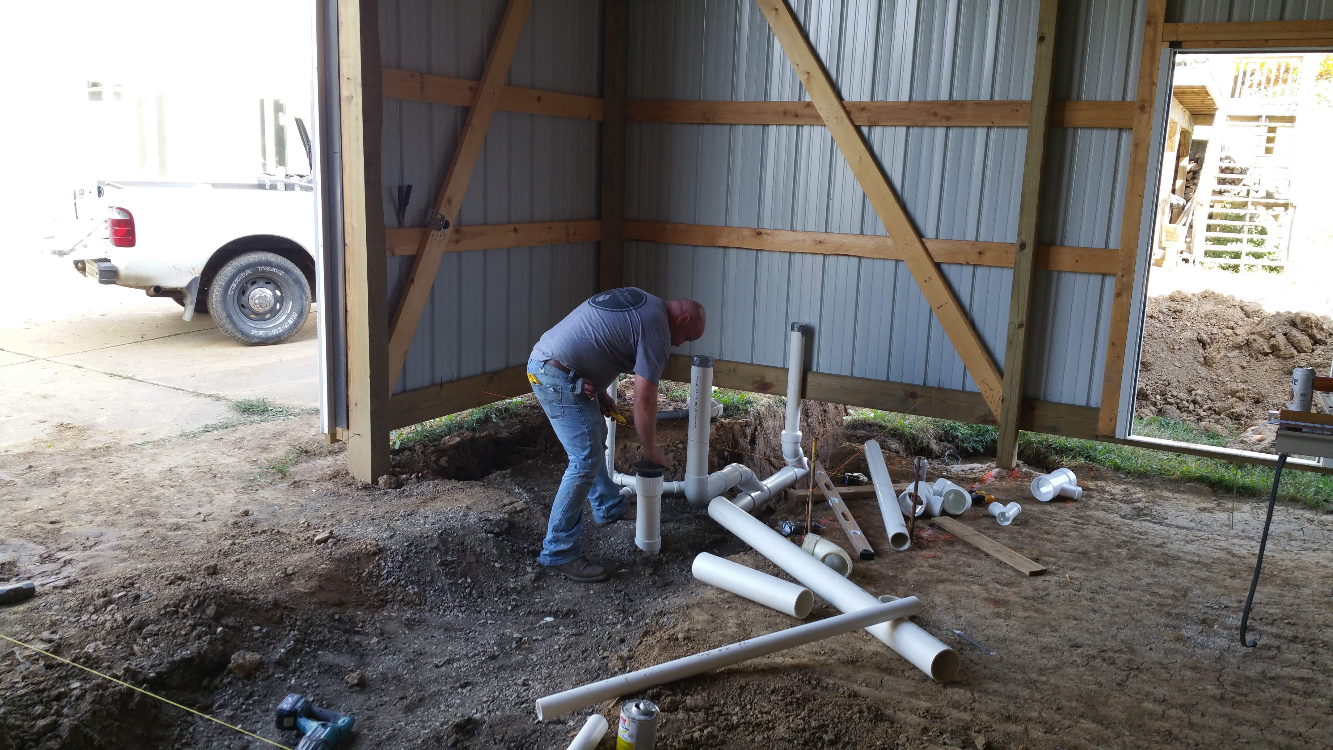

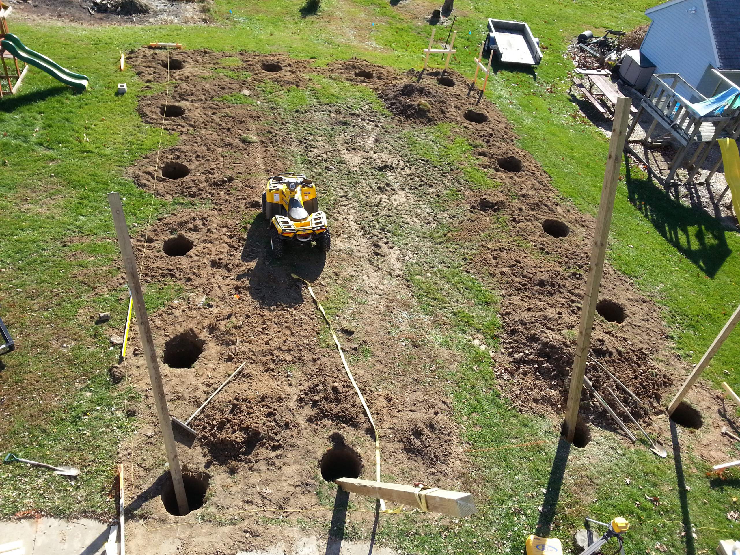

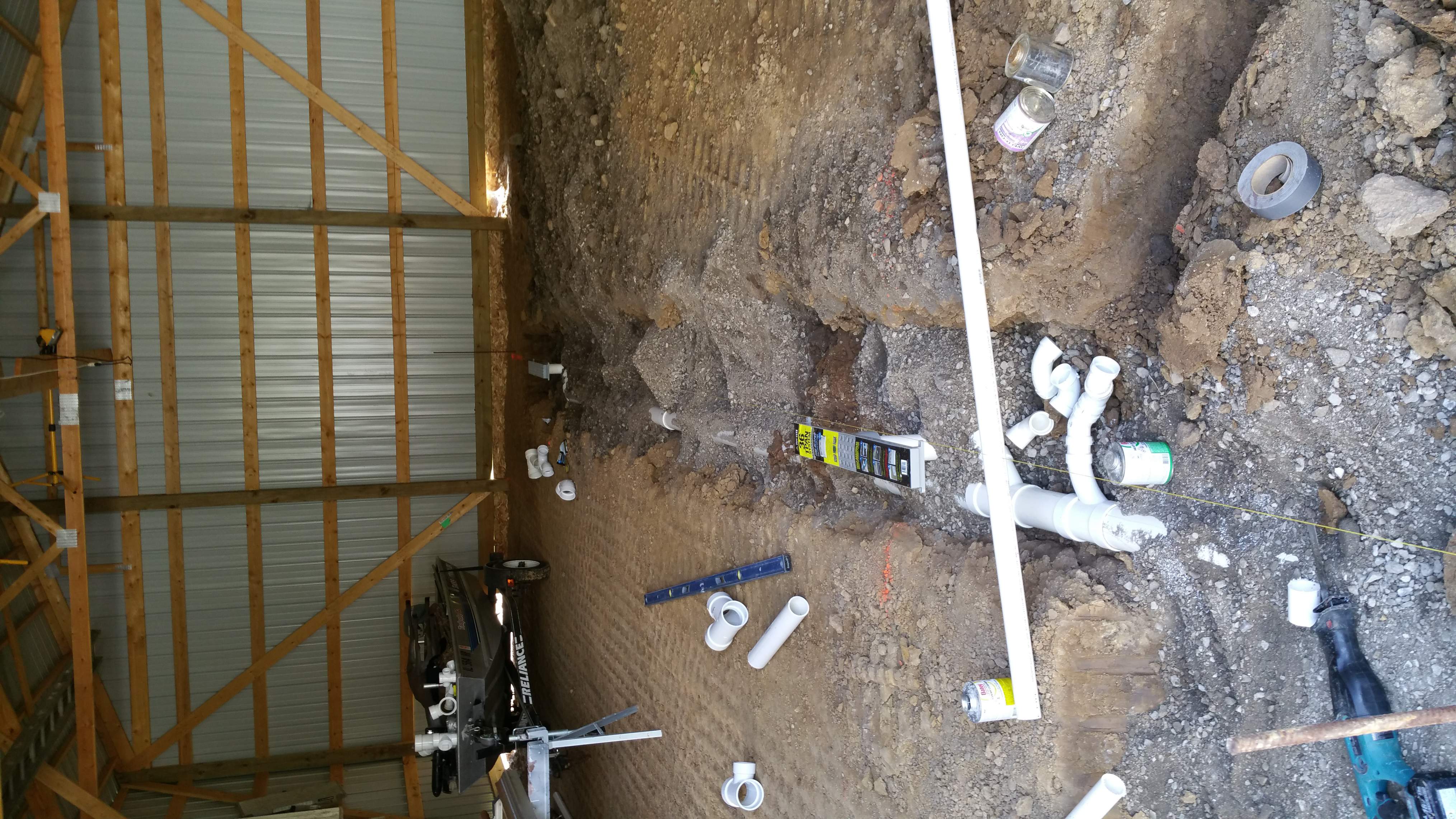

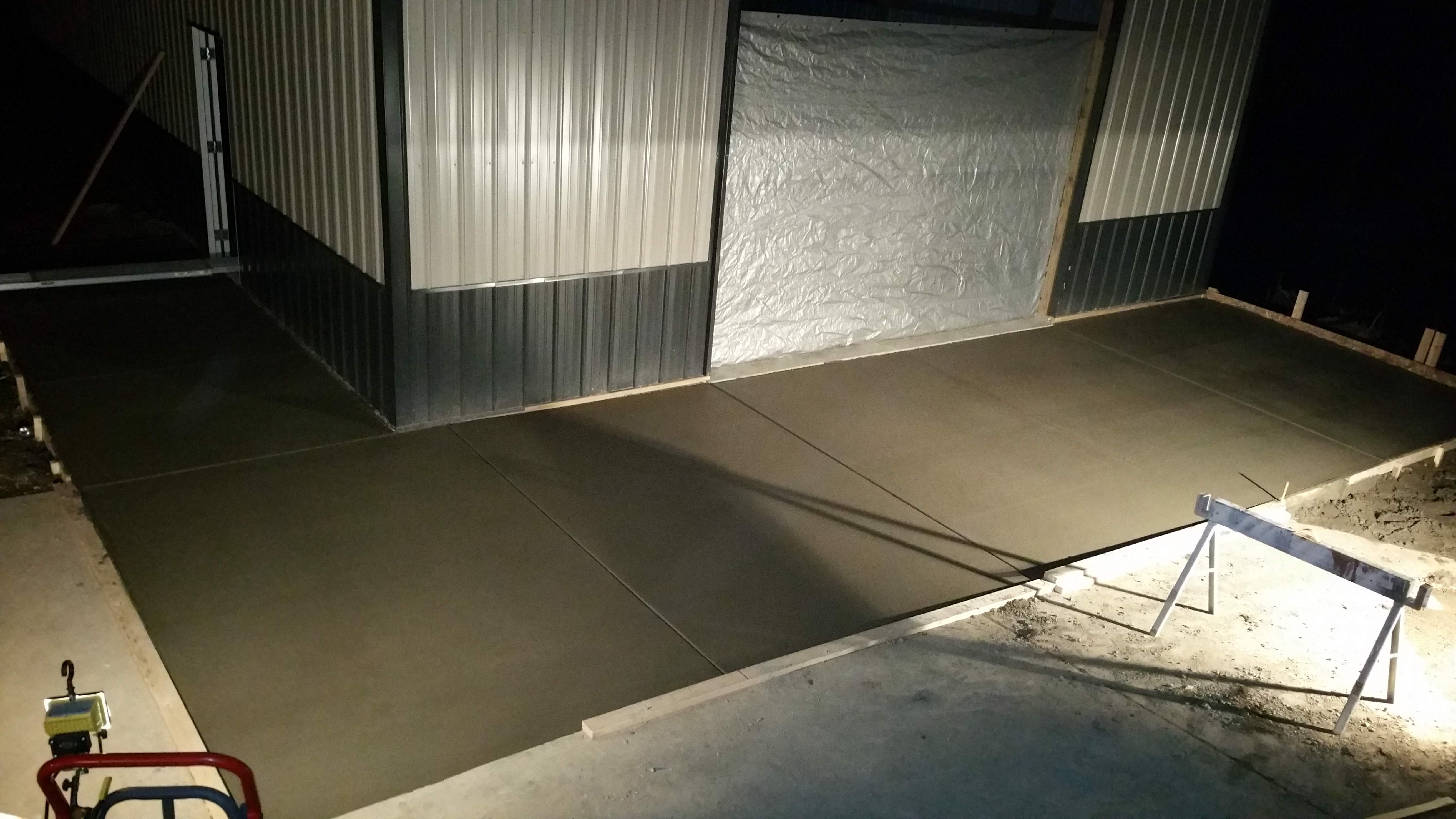

30x45 I built.In floor heat.Bathroom with stool,shower,urinal and sink.Also have plumbing on opposite side of building for a game cleaning station...birds,deer,fish...etc.Will be some type of stainless steel setup:D
thickened footings for a 2 post lift that will be installed after I save enough money for insulation and tank less heat setup:eek:

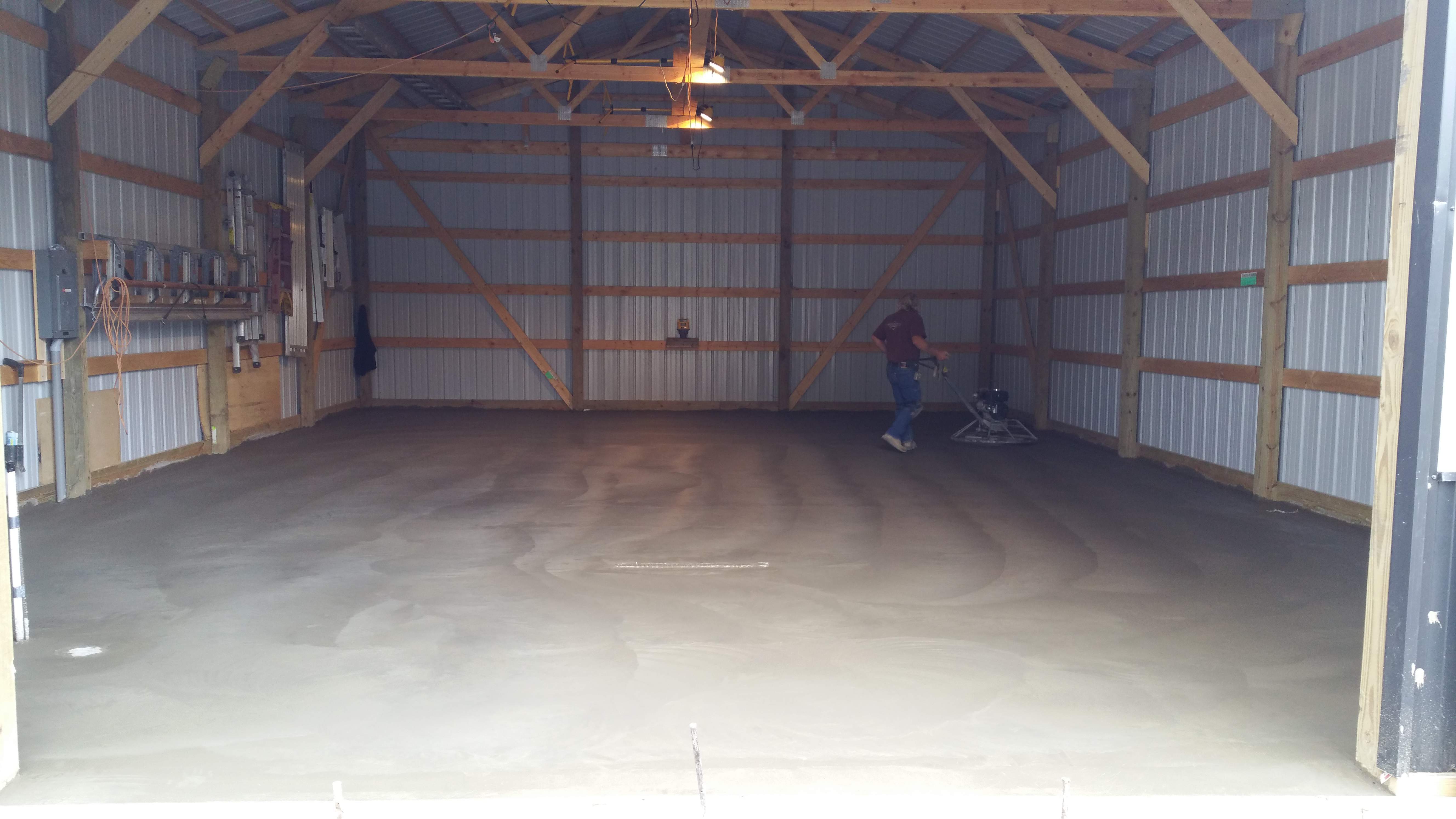

Hi Jay, nice shop! I'm planning one for next spring. I have some pretty un level terrain and have been struggling with one side lower than the other. What did you fill with to level the floor before pouring the concrete?
   / current project 12 month progress nights and weekends 30x45 shop for the toys!!
I hauled in 10 tandem loads of really good clay soil.i built a temporary wall on my low side.i put the material in 1 foot lifts and used a vibratory ramax to compact the soil.held that material minus 10 " from finished floor.about 4 inches of gravel and poured my floor with 4000 psi white Rock at about 5 to 5.5 inches thick

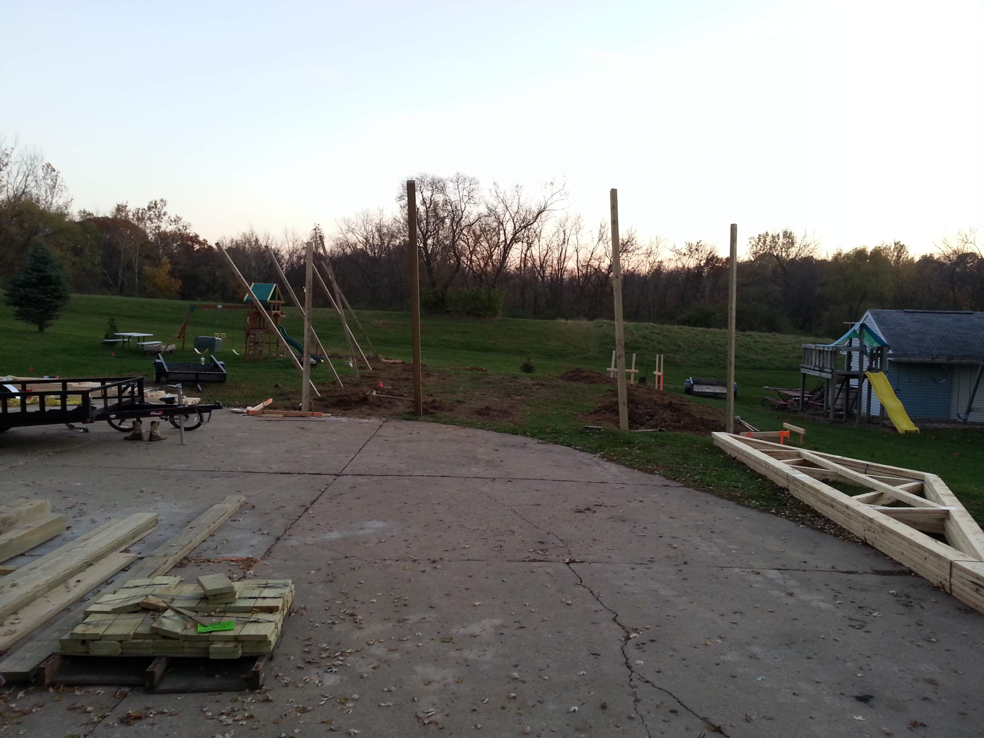

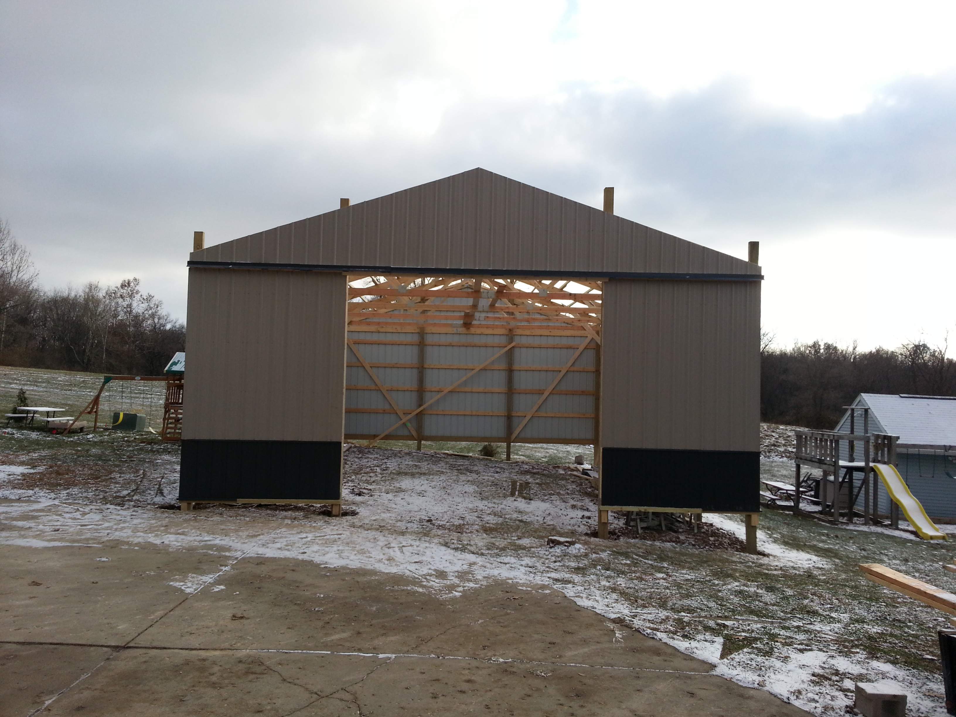

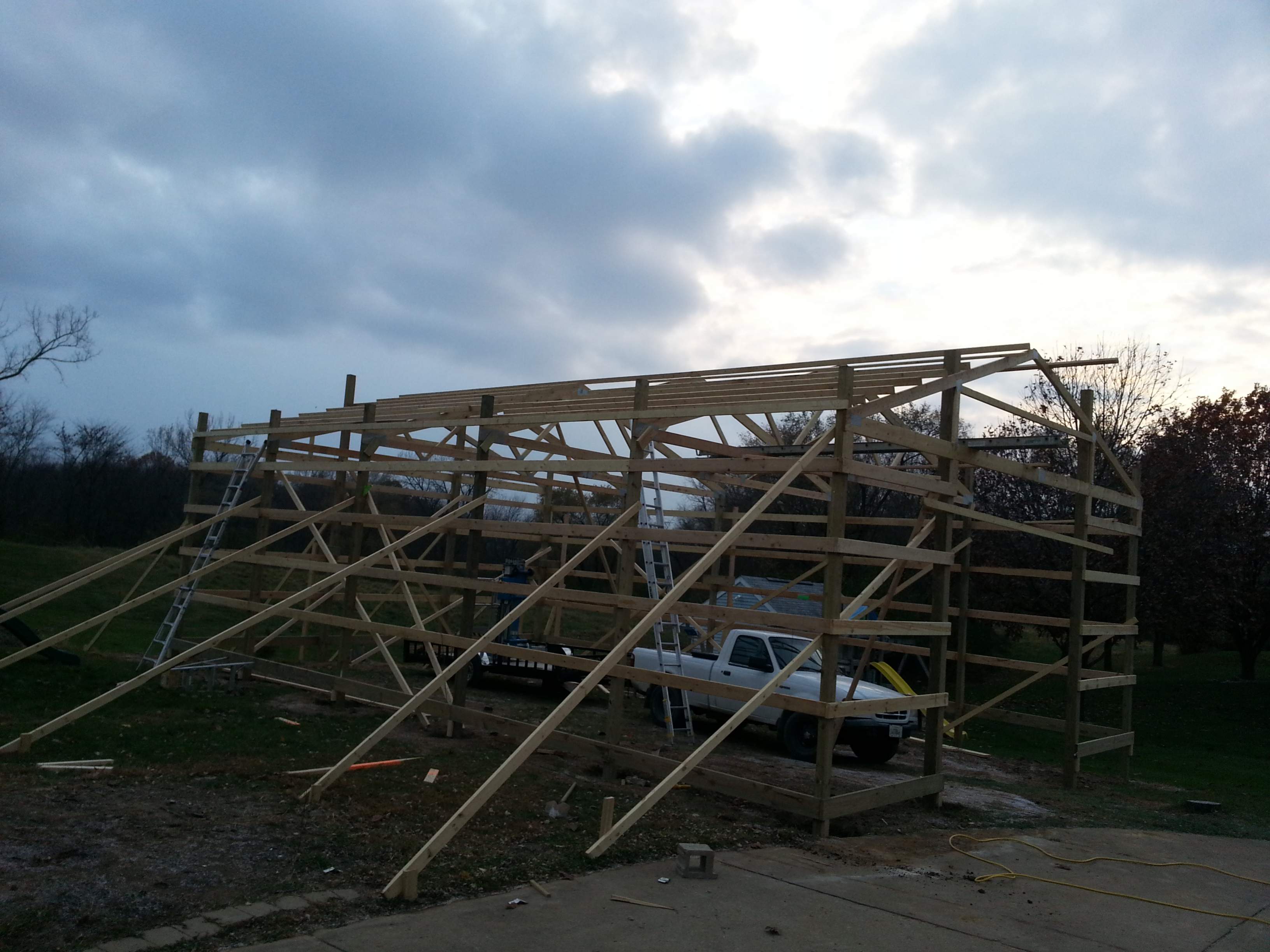

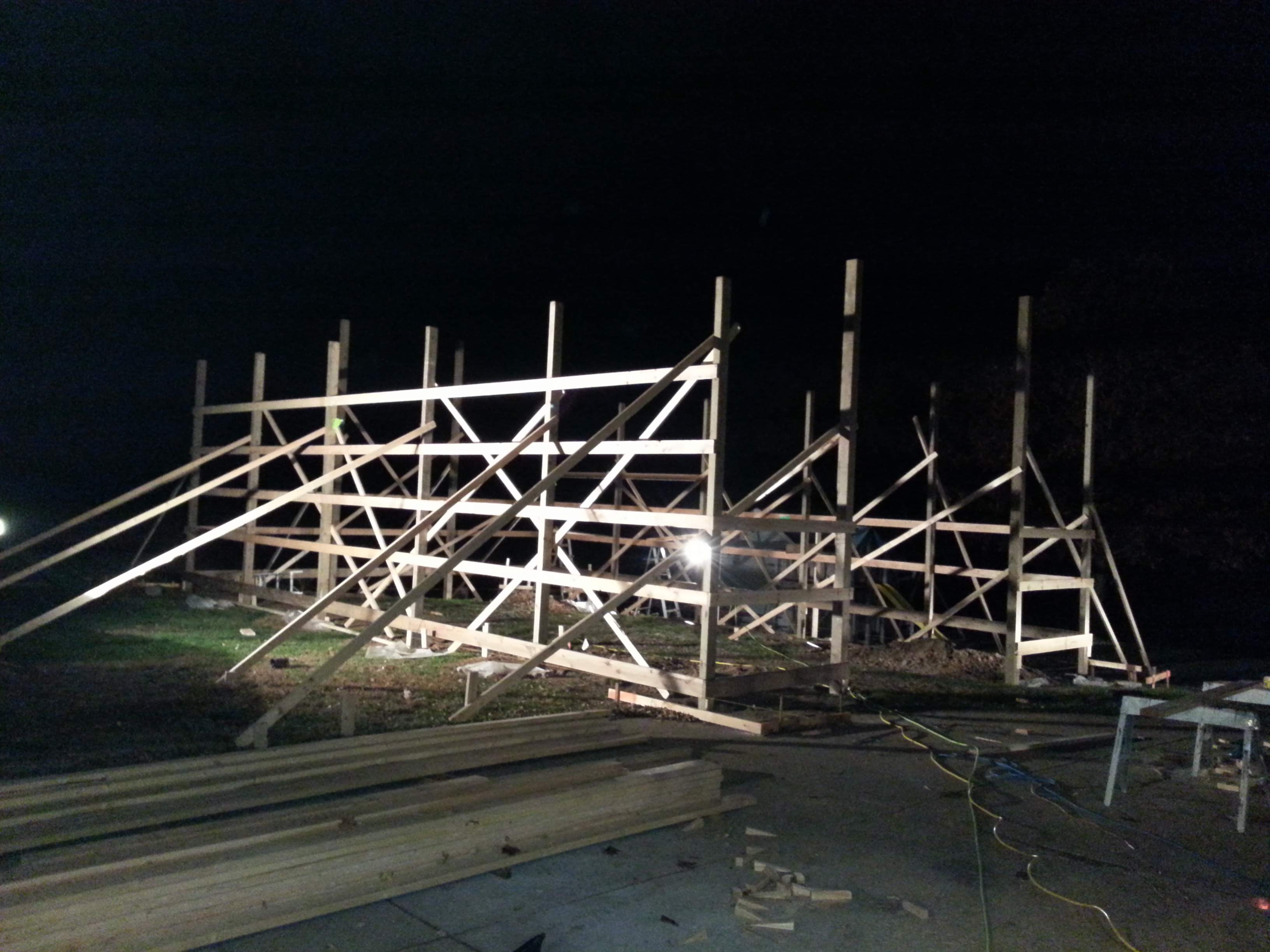

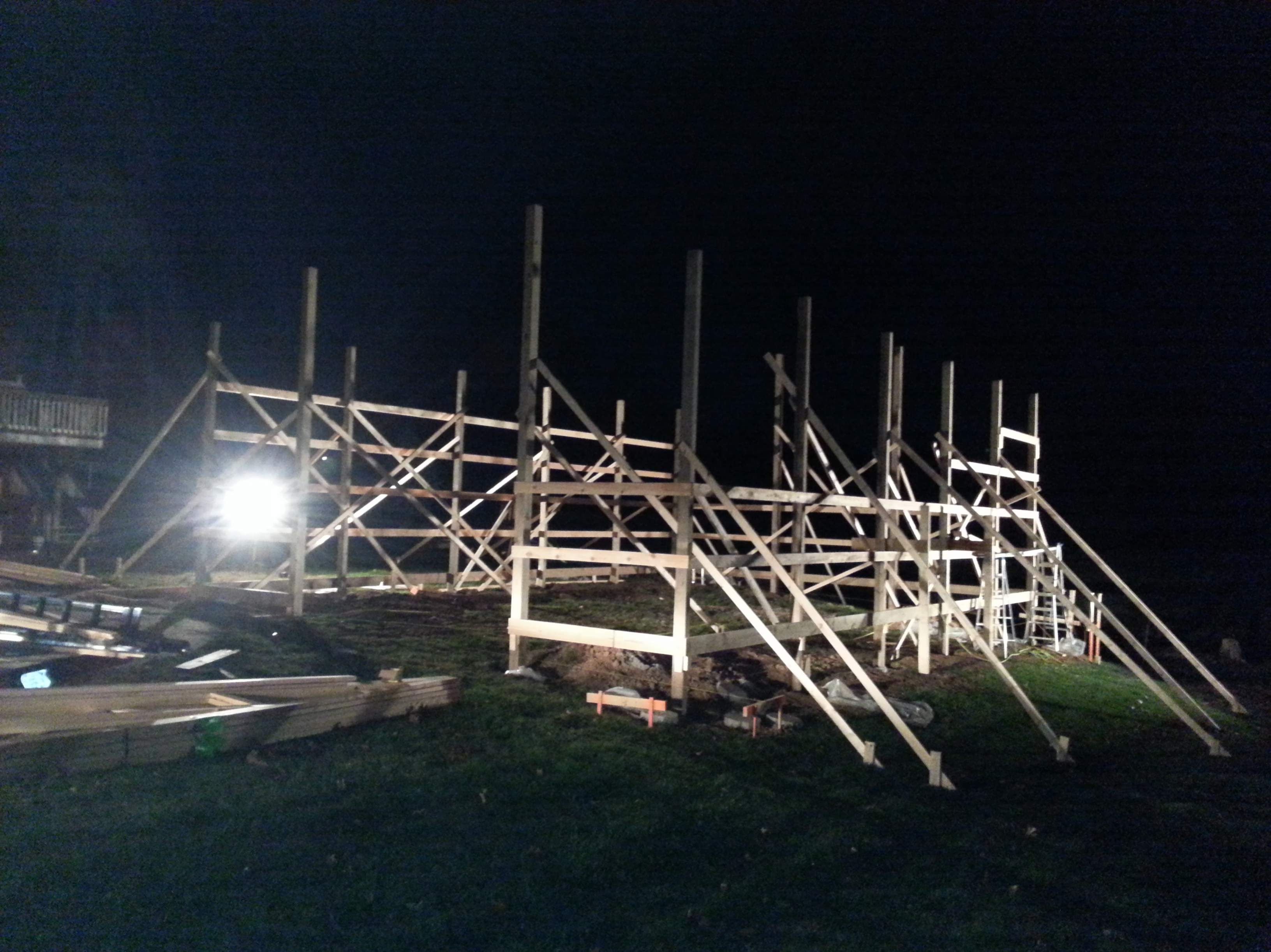

Nice shop.
A few build questions though.
Are you in a high wind area that requires the 45 degree knee brace from the truss to the post? OR are they temporary? I would think those would be a PITA for finishing the building off.
How are the trusses attached? Did you notch the posts which i looks like? Is that short board on the side + nails the only thing holding the truss to the post? or did you thru-bolt with a few carriage bolts?

We don't get wind to bad.I put the knee braces on just for extra support.the trusses are lagged and notched sittings in the posts.the small boards where just to help hold the truss in place during the setting process to keep them from falling down untill lagged.this winter when I have some free time I may still run a bolt through each one

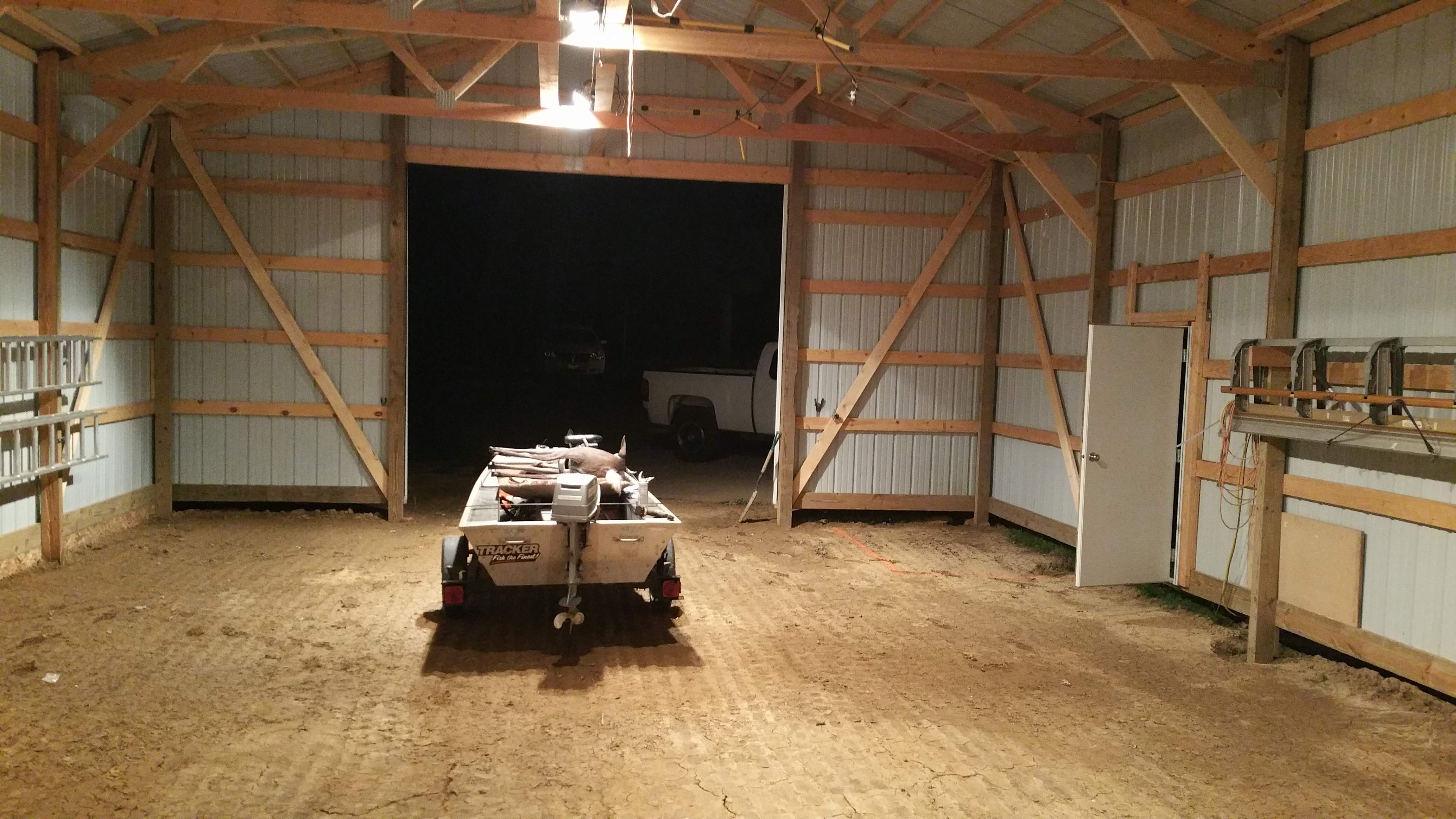

Very nice! I've got in floor heat in mine, and it is something I sure don't regret. Wish I'd have put in a bathroom though.
BTW, you have a deer sleeping in your boat! :)
