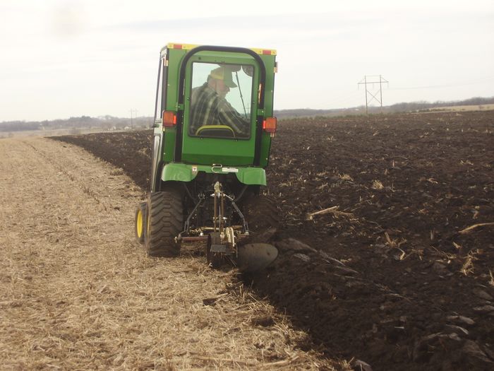

Nobody has pics of the the rear of the tractor with a hard doors/ windows, does that slide out in the summer? Are there any blinds spots or is viewing pretty good overall. Does curtis make a defrost fan for there cabs?

Yes curtis sells a defrost fan but its pricey, I bought one from a Rv store for $20.00. The view is pretty good I haven't had any problems. Search this forum under search forums at the top of this thread page type in, new 2520, on page 2 there are some pics of my tractor.

The doors come off easily. The rear window comes out by removing 6 bolts. The panel has to stay in or the entire cab can be removed. But that means you have to deal with the cab wiring and heater hoses.
As with any cab, there are blind spots but you will quickly figure a way to work around them.
