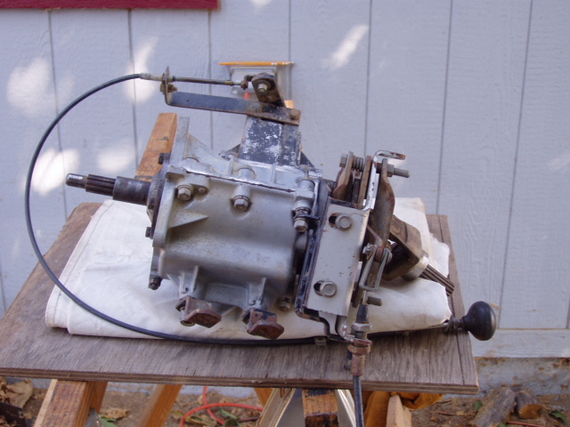

Welcome Soutthpaw,
I have a couple of Cushman Golfsters, a three and a four wheeler. If yo are ever in need, I have a nice three speed w/reverse and PTO transmission for sale that probably fit either of your Cushmans.

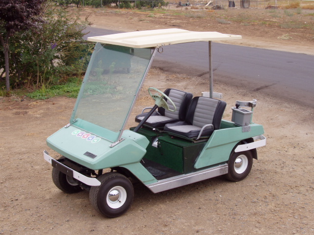

   / Cushman Haulster / Truckster Info needed. #3
This is our daily driver Cushman CG400 that is currently for sale because we are soon to move to a far more rugged area of California and thus bought a Kawasaki mule.
ever consider a lift kit and knobby tires for your golf cart???

   / Cushman Haulster / Truckster Info needed. #7
No,No and No. It is totally stock, pristine and runs well.
I originally tagged the golf cart in this thread as a "CG 400" wrong by me as it is a "GC400" Gran Cushman 400.
