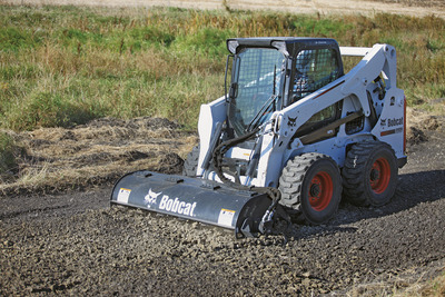

When finishing up a house, it is best for me to grade everything and then pour the sidewalks. This eliminates any, I wish I had accounted for that.... or that area is lower, etc. I realize that most pour and then grade. This mostly being that you don't want to pay your grader twice. When you grade then pour, you create a 4 inch dam with concrete so you backfill. Essentially grading again, then bring in more dirt to blend the grade level. I want to build something like an aggressive 4 ft box scrape for my skidsteer. With extra teeth. I want to grade the yard exact. Paint the lines on the ground, then cut a 3 inch deep x 4ft wide recess the entire lengths of sidewalks. This will leave room to form, then pour and give an inch higher than ground level walkway. The ground, especially now, is like a brick. So I need teeth to cut in and a box to drag out the dirt. A large capacity box would be nice so that once you move the skidsteer into position, you can cut 10 to 15 feet before dumping. During wet months, I can shave this out with my 4 in 1 bucket, from the sides, but way to hard now. I have a bobcat heavy quick tach , 4 or 5 inch tubular frame that I never made into a boom pole. I could weld ripper teeth all along the bottom edge. But I would rather get it out, away from the machine a little so I can see it. Well, I have explained my intentions. All ideas welcome.

Run a tiller where you want to excavate for the sidewalk and you won't need teeth on the bucket.

Hmmmm, you got me to thinking.... I would likely not use the custom sidewalk cutter for anything else. But a tiller, I could use it for more. It would be nice to have more multi purpose attachments. About tillers, while running a bobcat soil conditioner with my s250, it often stop spinning, not having enough torque. I wonder how well a tiller does? Would it cut fast enough to suit me? I have several attachment manufacturers within a 100 miles. One offers a tiller for $1600. I would not want to buy something that will not last, but there is not much to one. The main concern being teeth wear. How can I determine if this tiller is junk or a good value?
   / Custom build #5
Bobcat has one: Tiller Attachment - Bobcat Company
