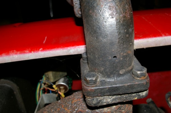

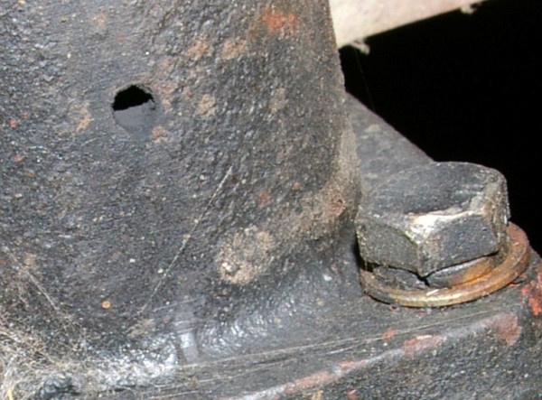

Take a look first John. Some of the Y380/385 exhaust elbows came with a weep hole already drilled (or cast)
//greg//
   / Cut the Exhaust stack
Next time I go out there I'll take a peek. Have to put the magnifiers on for the closeup............
The camera did the trick. Much easier to see in a picture than trying to crawl under. Sure enough..... A Weep Hole........
#9
1 More at loner range..........
I feel better now Greg, that all the bases are covered.......Let it rain, sleet, snow or whatever............
