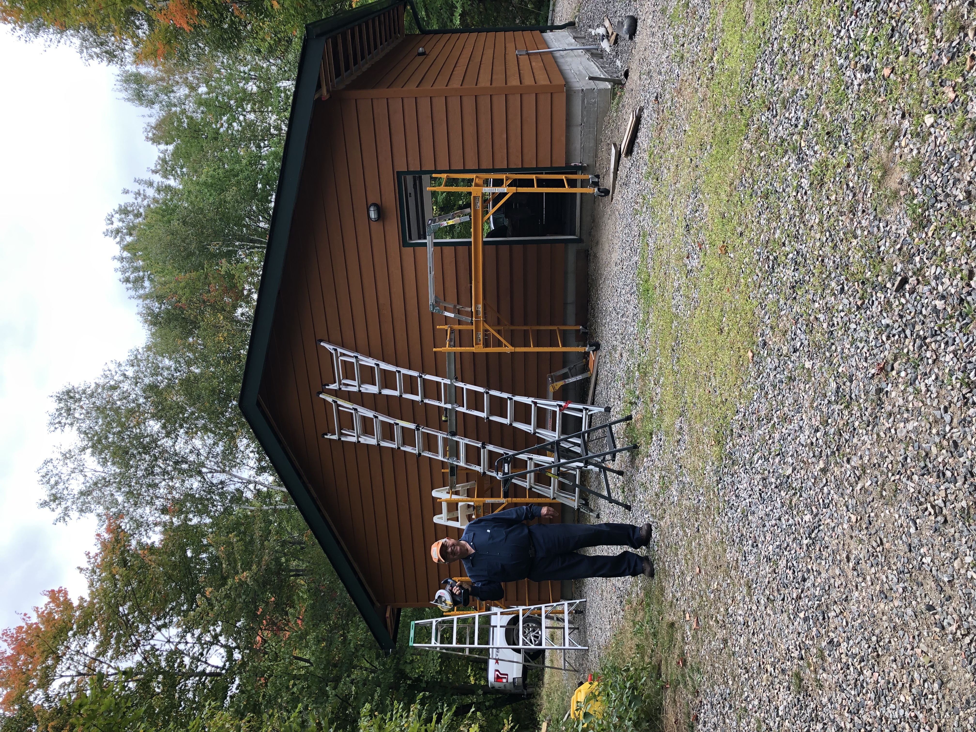

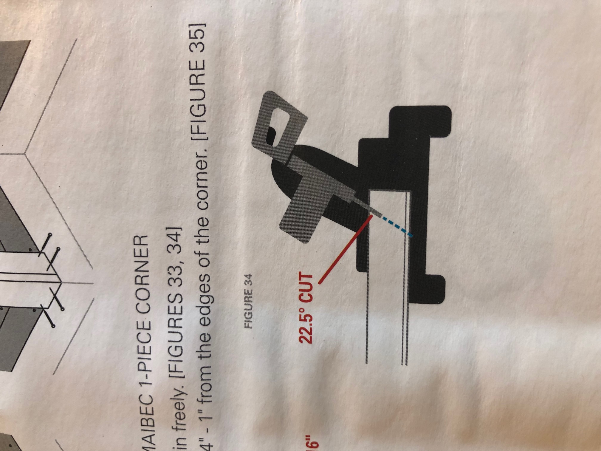

Hello guys, here is one for you. I am installing beveled siding on the garage, and the siding supplier (Maibec of Quebec) says to join boards by cutting them at a 22 1/2 degree angle, to prevent water penetrating the joint. (As opposed to just 90 degree but joints.)
They also say to cut the 22 1/2" joints with the "visible" side facing down, and my friend who is helping me says he can't measure properly that way. The problem, of course, is that the cut at front (flat) side of the siding will be at 90 degrees, but the back (beveled) side will not. So, he is cutting the other way, but that makes the joints at the front slightly off of 90 degrees, which is I suppose acceptable, but it does look a bit funny.
Any advice here would be much appreciated!

You take a piece of scrap and cut the bevel and then measure how much longer (or shorter depending on whether you are cutting a left or right bevel ) the back side is relative to the front side at the bevel. Then add the difference to each measurement. Also check to be sure your saw blade is square to the backrest and plumb to the table surface.

Well, it's all finished now, but the issue is that bevelled siding cuts different than flat siding, depending upon whether the face is down on the mitre saw, or the back side is down. If you cut with the face side down at, say 22.5 degrees, the face side of the cut is perpendicular to the length of the board no problem, but if you cut with the face side up, the back side is perpendicular, but the face side is off a bit. It is in fact hard to see this after application if no one points it out to you, but you need to make sure that the matching cut is laid out on the OPPOSITE side of the saw, so that slight angle matches.
Weird. Makes sense when you think about it, but I would have never thought of that ahead of time.
PS That is my helper, holding the little Ryobi 18 volt circular saw that I gave him after we were finished. (He like it a lot, and I had 3 of them so...)
