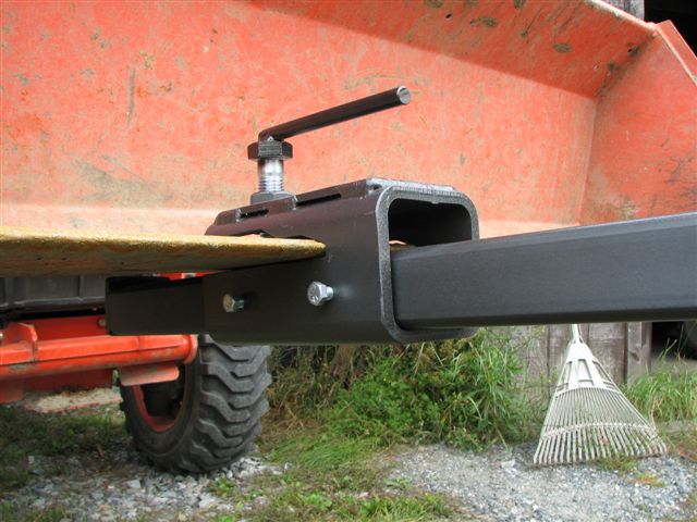

Here are the ones I have made....I have some with a 2 x2 forks rated for 1000 lbs (17" out from bucket), the ones in the picture are 2 x 3, rated at 1600lbs, and I also have a 2000Lb set made with 2 x 4 tube. I sell the ones pictured for $299/pair.
