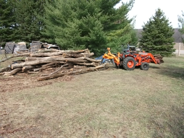

A man after my own heart! I love to tinker too. Some thoughts: If you build a saw rig you will have to move the log somehow. If you use the tractor to power the rig you will need another tractor to move the logs. If you just use the chainsaw you move and the log doesn't. I drag logs out of the woods and cut them on a landing, using the tractor to assist when needed.
There has to be a higher end use for your "goodies" Are you cutting firewood for heat or lumber? If for heat, do you use a wood stove or a masonry heater?

Personally I fine the 'buzz saw' to be quite safe. Ive used one for many years, But I do just use it for the smaller stuff. limbs etc. I have to cut someof my wood to under 12 inches in legnth . I paid 800 dollars for mine 19 years ago...
