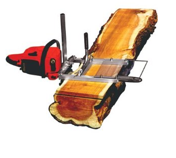

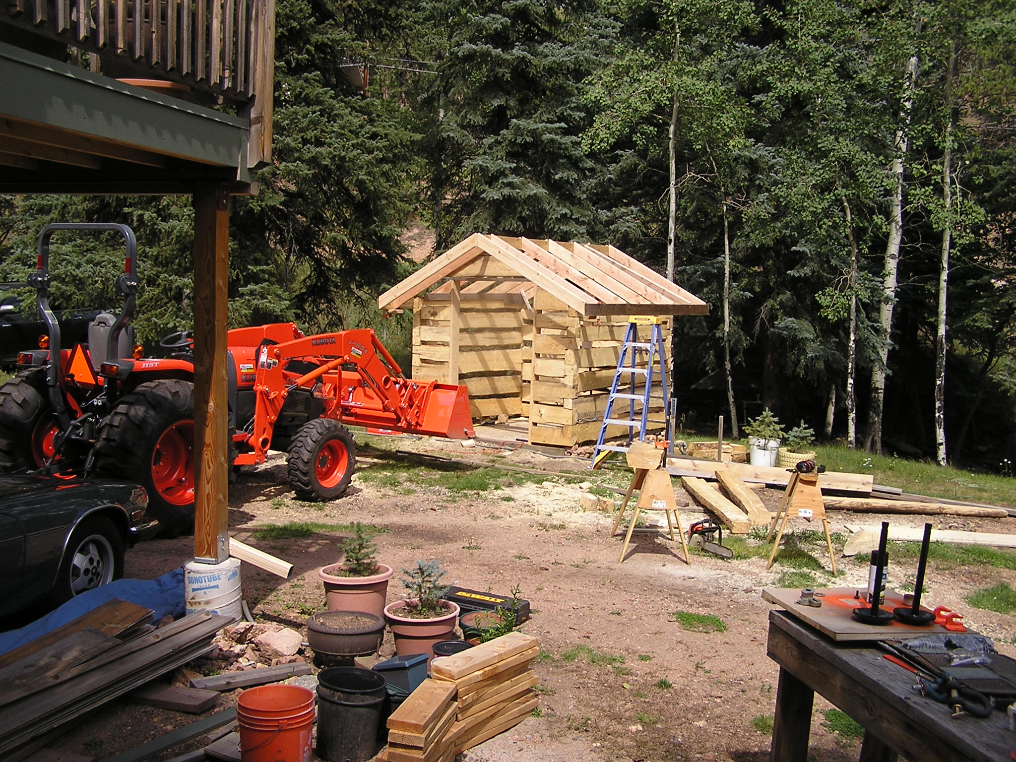

You can buy an attachment for your chainsaw that will allow you to make parallel cuts. It's best to buy a rip chain for your saw, as well. I have used the one shown in the picture below, and find it works well. It costs about $130 from Northern Tool. I have a small chainsaw (Stihl 026 - about 30 years old) and that is a bit small, but still doable. I built this small hut last summer to hold my trash cans and keep the bears out.

I have a Granberg Alaskan Chainsaw Mill, as well as their Mini Mill (which is cheaper and the only thing you need for sawing beams or a piece like this mantle). However, I use a 77cc chainsaw, because that is what's required for milling (and many people go even bigger). I also use rip chains. You will most likely melt down your little Husky if you attempt to use that saw for such a long (time wise) set of cuts. It will not cool quickly enough, and it's not a pro saw that can handle repeated long cuts.

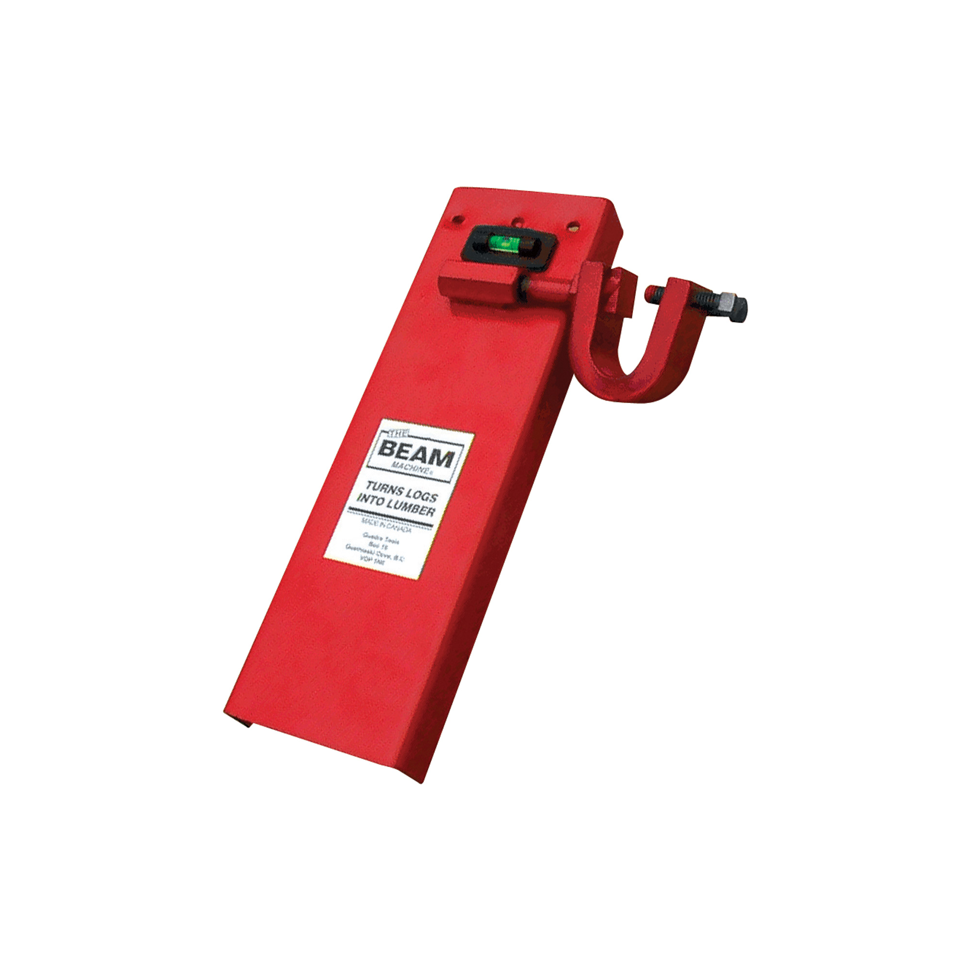

11890_2000x2000.jpgwww.beammachine.com
That'll help a lot for the price. A lot less than a alaska saw mill. Or find a guy locally with a band mill you could take one log to. Probably only charge you $15 or $20 and it would be perfect. Sawmilltrader.com has listings of guys with mills across the country.
