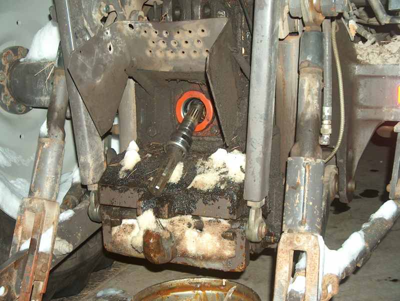

This is what I wrote on another post:
WARNING!!! When you fit a new PTO shaft, be sure it is not too long. Just measuring between the PTO and the implement is not good enough. The lenght of the top link makes a difference. Longer top link usually shortens the length between the PTO and the implement. Consider the movement of the implement if you shorten or add lenght to the top link. Then shorten the shaft an inch or two extra, just to be on the safe side. I had a breakedown on my tractor due to a too long PTO shaft. The PTO axle was pushed into the rear of the tractor, destroying the grove for the circlip that holdes the PTO in place, making the PTO axle slide out followed by 12 gallons of hyd. oil! I think I probably was lucky that nothing else broke, but I am not sure yet, the bearing at the end(Inside the tractor) of the PTO axle might have been pushed out as well, if tha is so, it is a big job coming.
Gunnar
