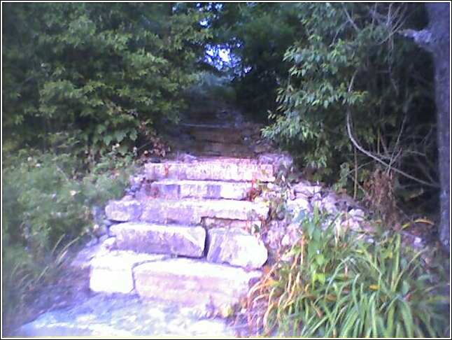

UncleRich, here is a shot of the bottom flight of my stone stairs. There are 3 landings and 4 flights of 3 or 4 stairs. The total rise in this area is under 10'. The run is probably about 35' and it is very comfortable to walk despite the irregularity of the steps. The stairs and walk are not quite a straight walk up a slope in the woods.
