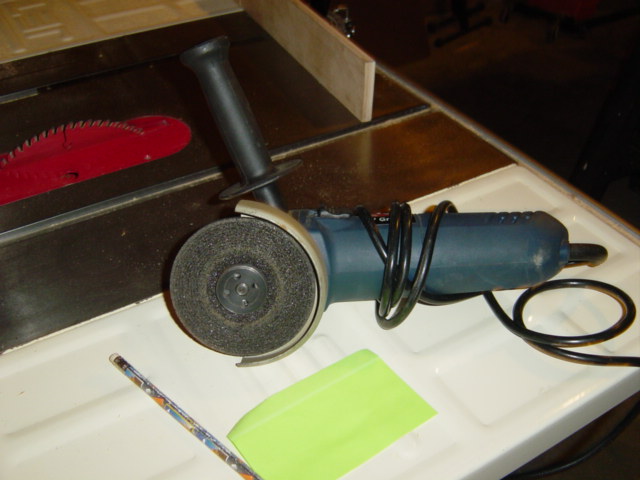

Assuming it is stitch welded, use a 4 or 7" angle grinder. See attached ($30 at the depot, great for ocassional use)

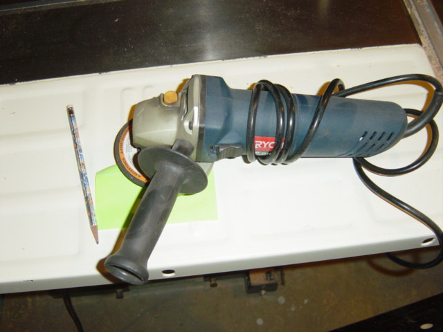

Use the perimeter (vs the "flat") of the disc to cut thru the welds. Pic 2

Oops, the aluminum didn't register. You can buy special wheels for an angle grinder for aluminum, do not use a standard disc for steel, you won't get very far. Same with the cut off wheel, they're for steel. The grinder wheels I've used for aluminum almost look like a compressed paper, but they cut very well. Plasma will work, but you don't have one I'm assuming. Torch won't work either. Jig or sawzall if you can reach the weld with them. Sorry for my /forums/images/graemlins/confused.gif
