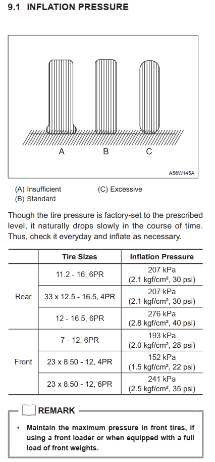

New CX2510HST Cab has about 10 hours. I bought it with R14T 6 ply tires (Goodyear) and the service manual says to fill rear tires to 40 PSI but checking today the rear only have about 19 PSI ! (Yes I checked with another pressure gauge as well).
The rear tires are labeled for 40PSI and the front for 34 PSI. I know that for loader work I should inflate the front tires to the full recommended rating. What about the rear, how much lower can I safely go? The tire shape seems OK with 19PSI, no side wall sagging and the tires appears to be making full surface contact. I dont want to round up the tread but think 20 PSI is way too low.
Thanks in advance for any advice

It is called out in the owner's manual, but all I have immediate access to is the service manual (below) and only for the open-station model. Technically these are for Ag/Turf/Ind tires - they don't explicitly call out R14s. Also if it's not noted in the tire section of the owner's manual, look in the ballast section of the manual: they will often advise a few psi higher or lower if liquid tire ballast is used.
In my opinion sidewall is only good for telling you max PSI for any application. Not necessarily the optimal PSI for that application (same logic for passenger vehicles... you follow the door placard, not the sidewall).

Spoke to my dealer (also was Kubota dealer for 20y before switching to Kioti). They never recommend inflating to maximum specs. My R14 rear tires (12-16.5, 6ply) is rated as 40psi but they routinely fill only to ~ 20psi. Front rated at 35 psi they advise from 20 -30psi depending on front load. If rear load increases to near tractor limits they would increase rear tire psi. They equate tire pressure to shock absorbers to use the low end of the recommendations except for high loads.
