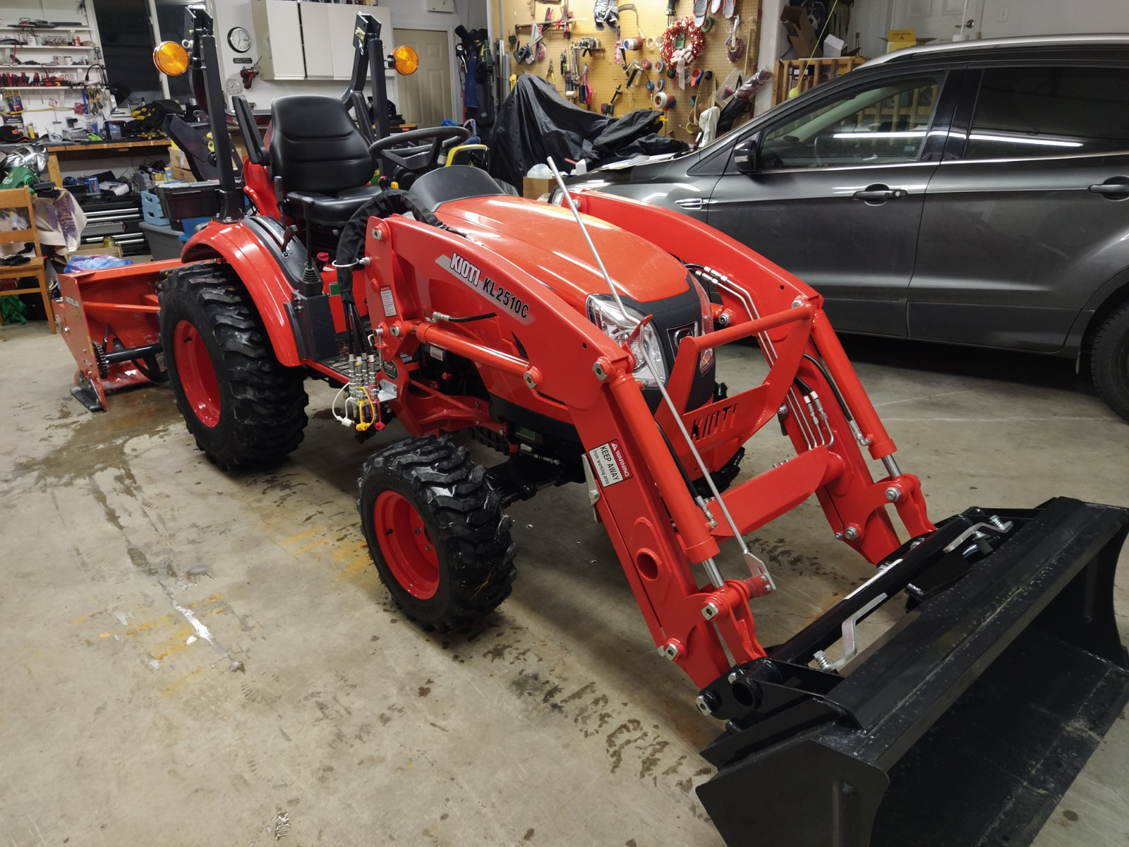

I am new to the forum. I just got delivery of a Kioti CX2510MB model (manual transmission) and paid $21K (Canadian) included in the price was the KL2510C FEL (no zero financing) , block heater and rear remotes. Also bought a Meteor 60 inch pull type snow blower. Looking at other peoples CX2510 on the forum the bucket leveling gauge is different perhaps the "C" in the loader is the Canadian version. Won't have a chance to test the blower as the snow is melting and nothing in the forecast (darn it). This is my first tractor and I really like it, seems to turn very tight at the end of my driveway without using the dual pedal braking.
