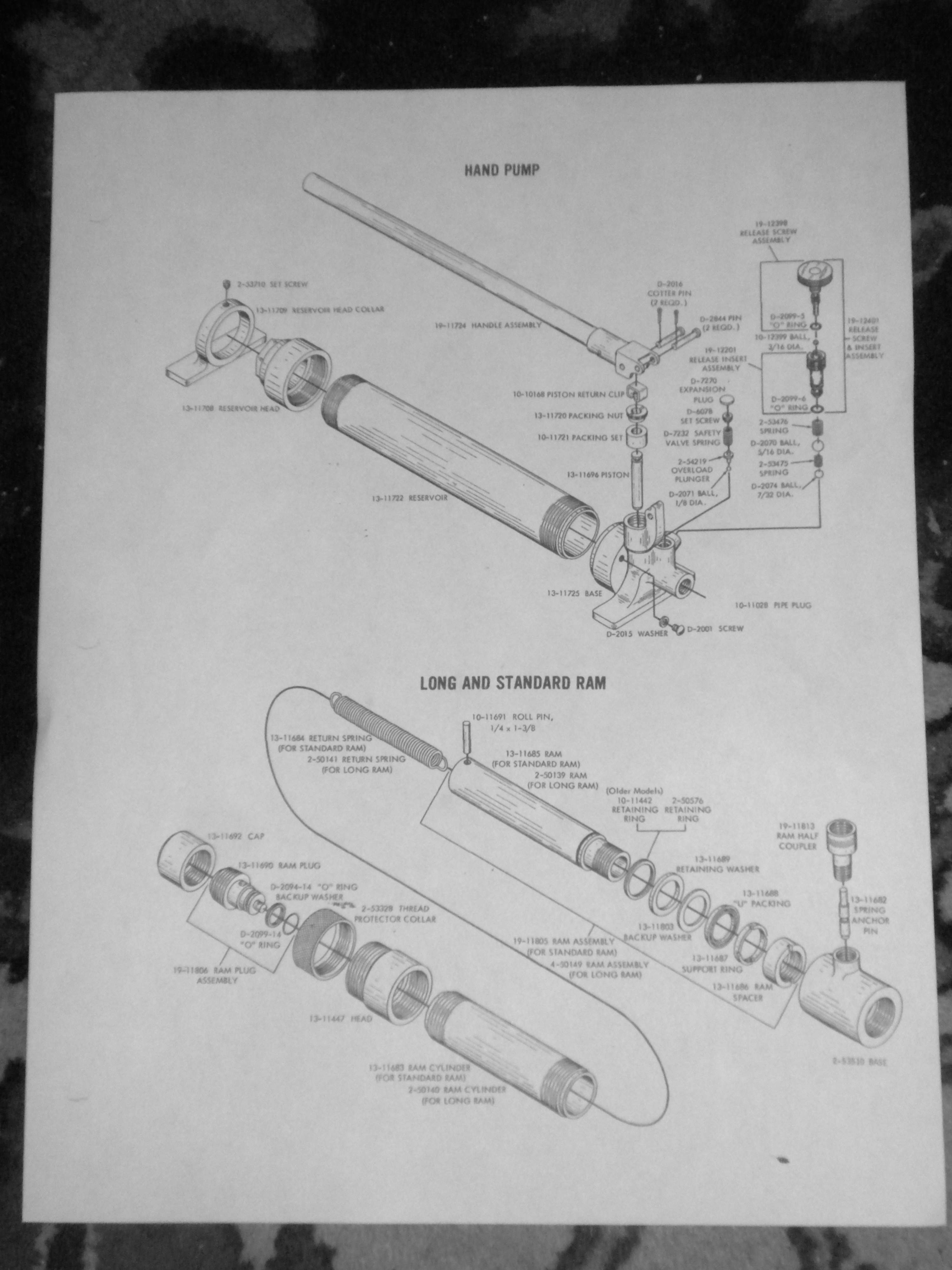

Morning from the hills, I have a problem some of you whiz's on hydralics can help me solve. It's not on a tractor mind you but, I do use it with/for my tractors. I have a benchtop style 10 ton shop press. It uses a powerpak type hand pump and a ten ton cyl. Problem is the seals leak around the rod, well leak may not be a strong enough word. Its more like runs out. I have tried to put it in a big vice and unscrew the cyl but I've had no luck. I'm not sure thats even how it comes apart. Its a NAPA branded item I've had for 20yrs. I'll try to upload a pic later as the day progresses.
thanks. tim

Sorry for the delay, I forgot it was family weekend at my daughters university and I had to take a little trip over the weekend. Yes, I realize NAPA didn't make this Cyl. they don't make anything they only sell their "branded" items. I really hope these images, and [URL="http://i700.photobucket.com/albums/ww7/mrvair/photo2.jpg"]here, and here, and here.[/URL] can help with identity of the real manufacturer, and help me disassemble and ultimately repair it. The tool marks on cyl. I made by trying to open it up. Thx. guys.

Looks like you have the Ausco version of the 10 ton ram Model 5-52016
Fasten the base in a good vise, then manually stretch out the ram (you'll be pulling against the return spring internally).....there will be a .250" x 1.375" roll pin just under the threaded head an inch or so.....take out that roll pin while the ram is stretched out......
After the roll pin's out it'll allow you to pull on the threaded head to expose the return spring, slide a skinny screw driver under the spring, then disconnect the threaded head......then let the spring snap back in (you'll use a homemade hook tool to pull it out when you go back together
From here you can unscrew either the head or the base, whichever one comes loose will work, but the base is better to come off cuz it holds the return spring and will allow you to polish up the barrel
I don't have my digital camera at work but will take pix of the service breakdown tonite and send
As far as the u-cup seal, I may have it but will need exact dimensions
