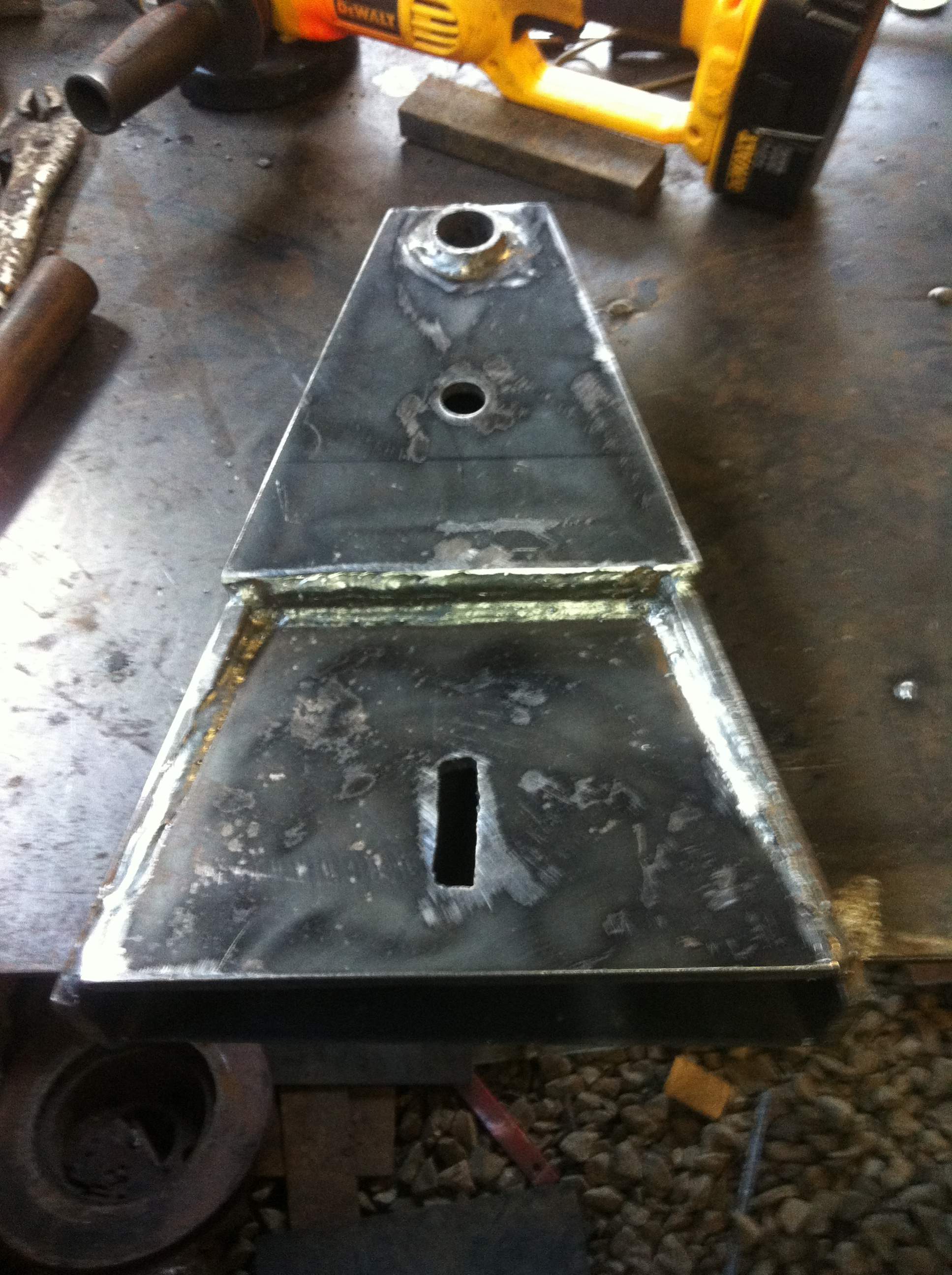

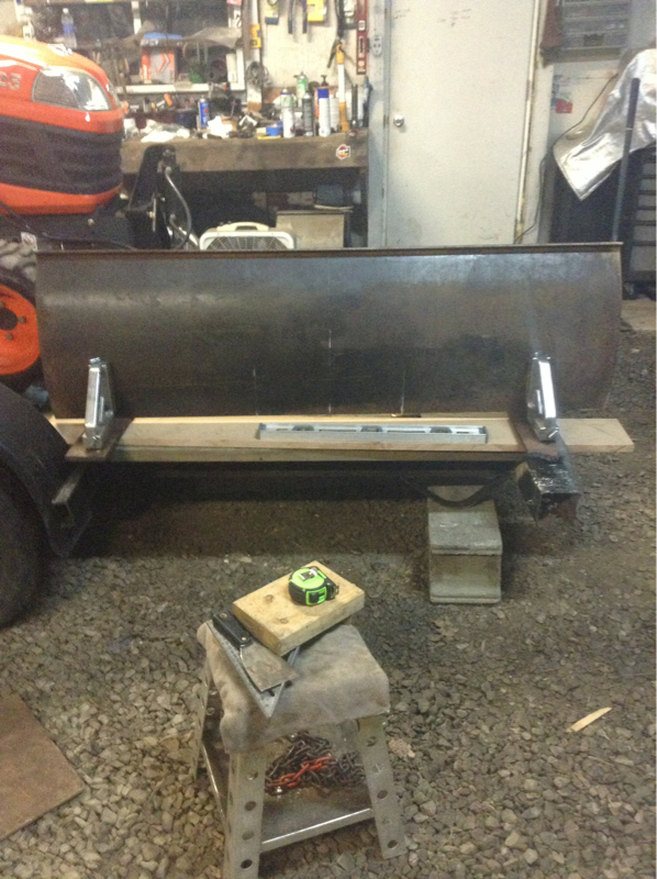

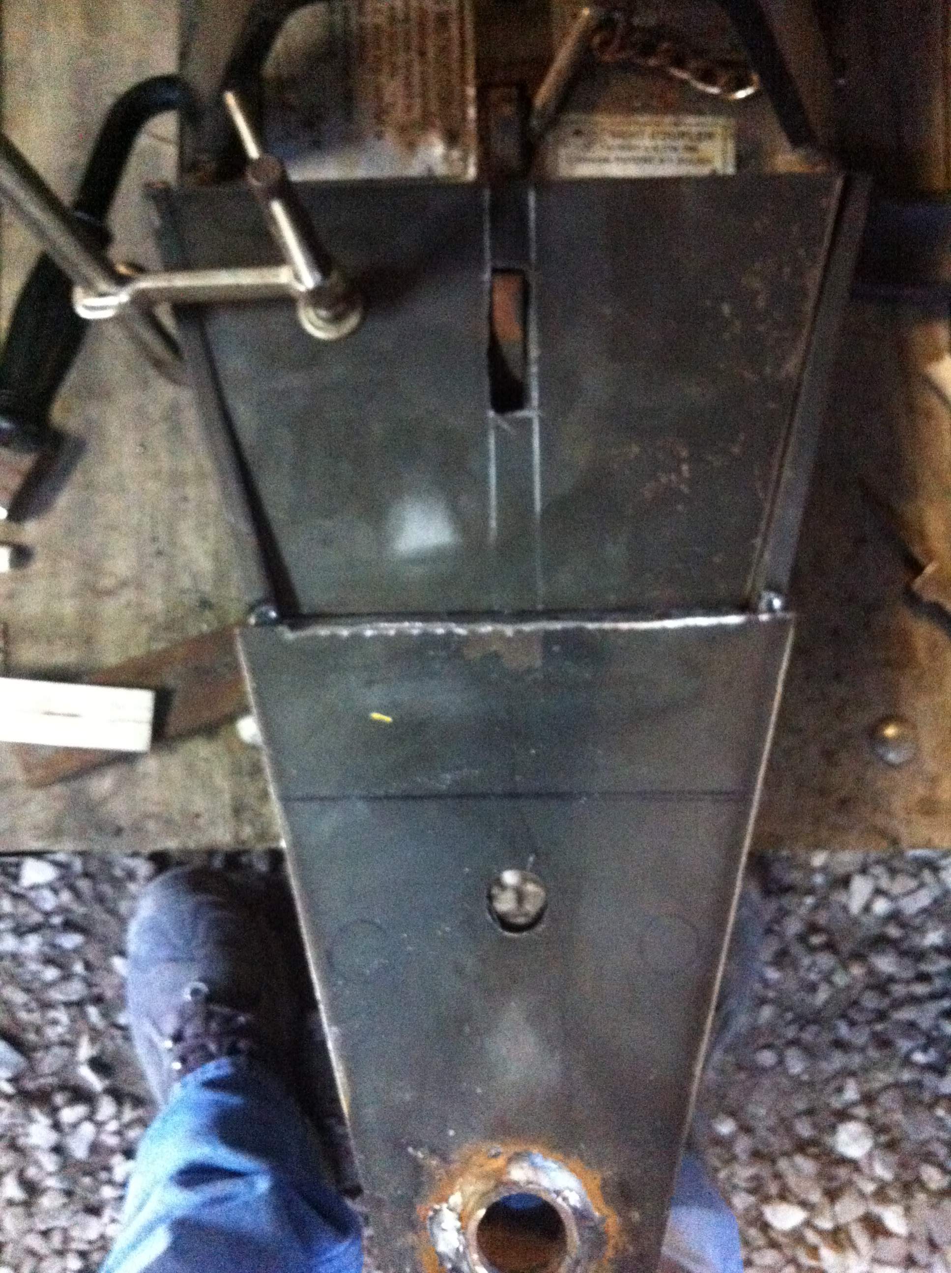

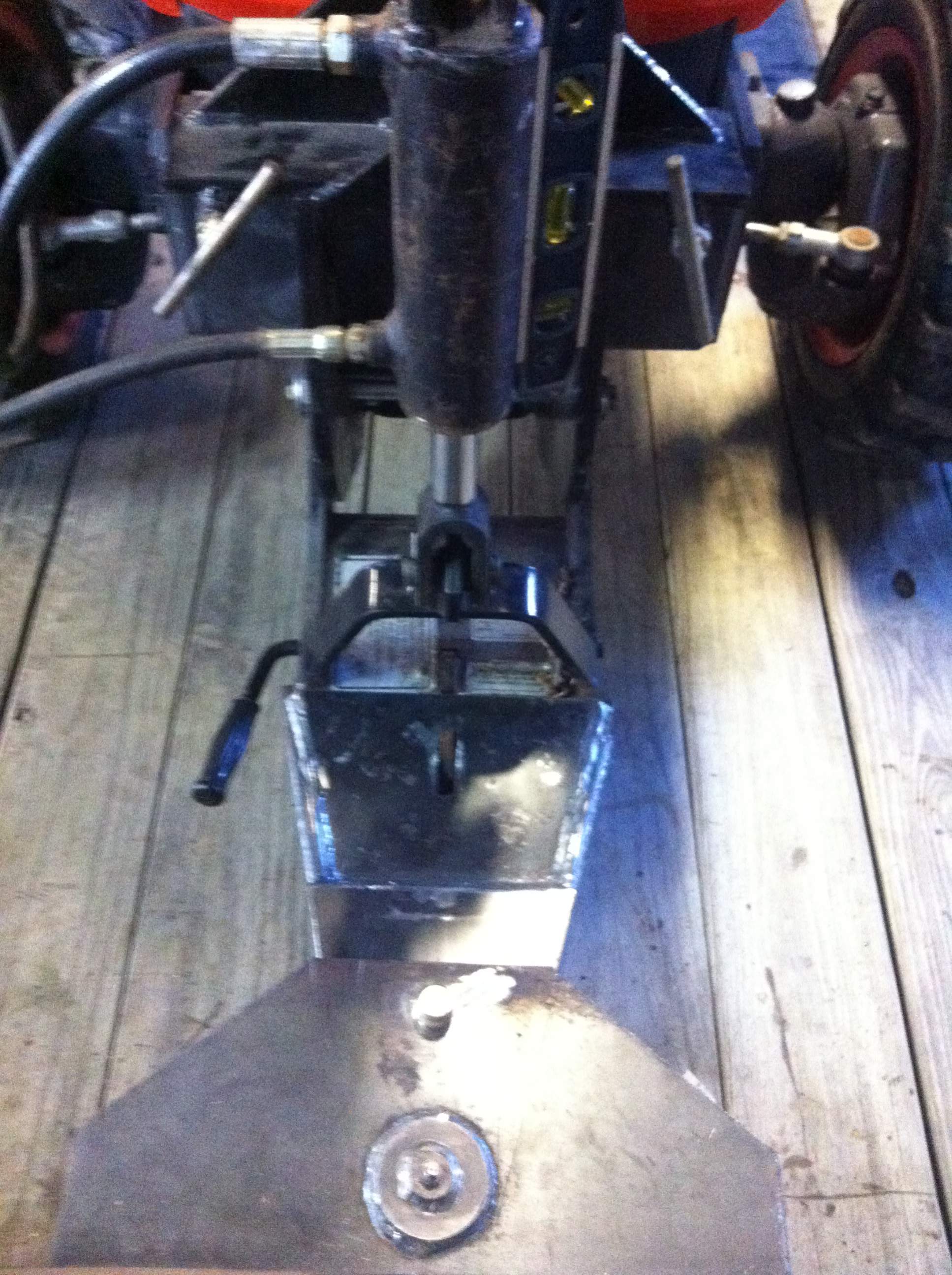

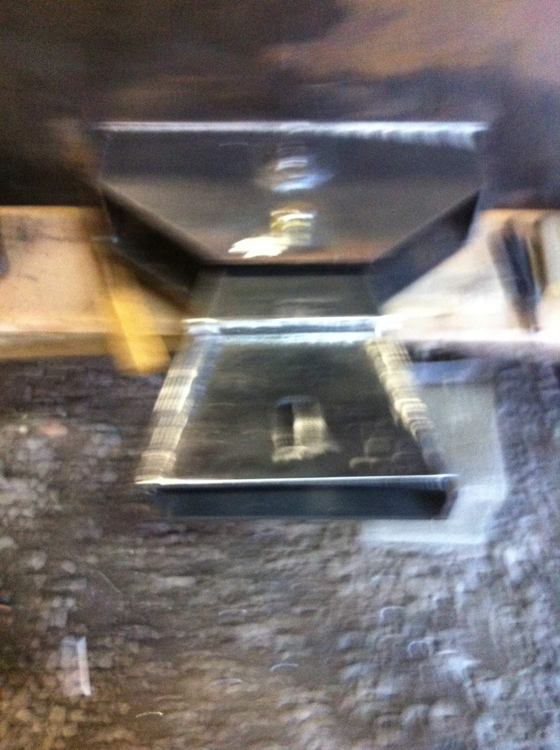

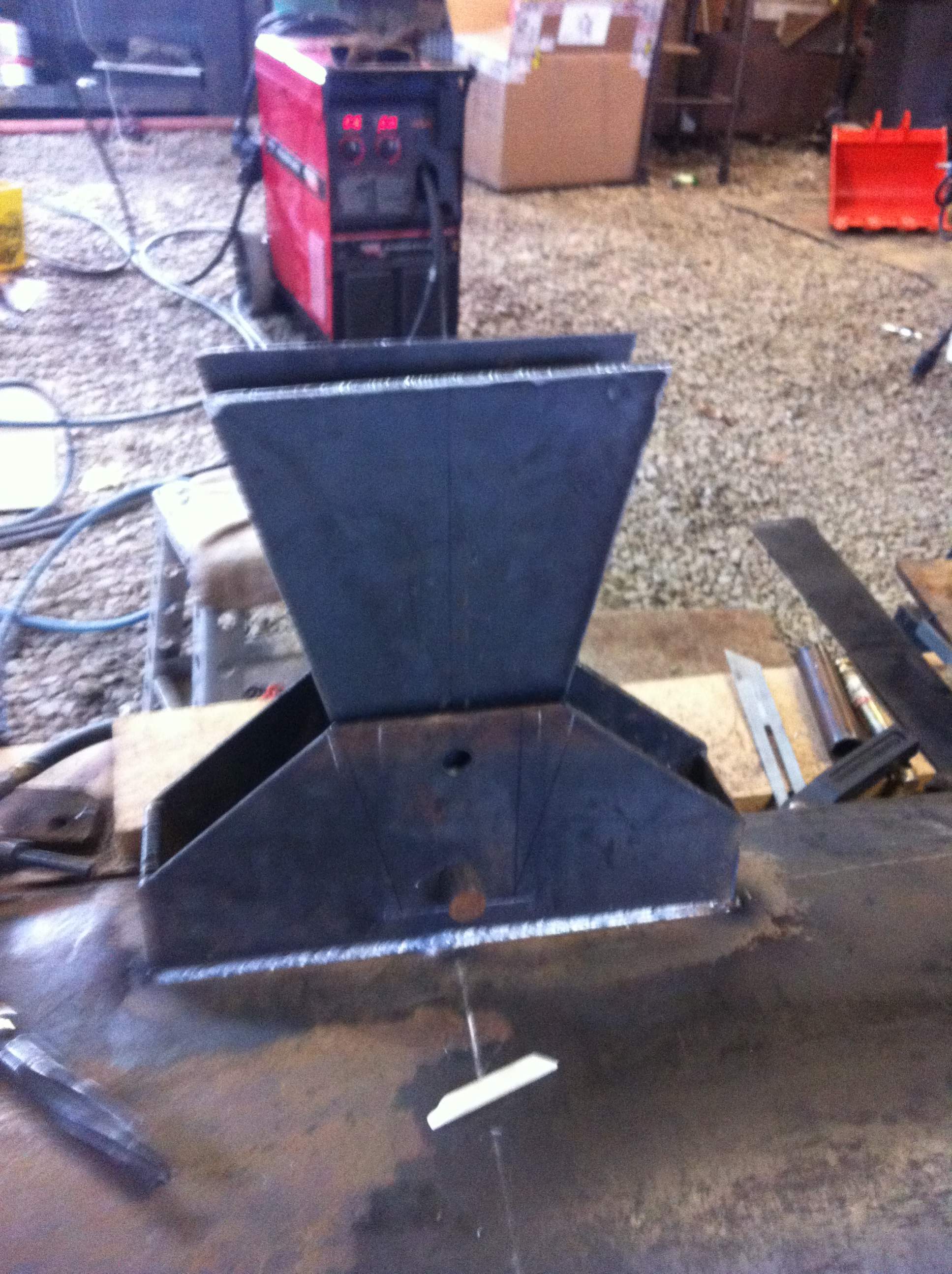

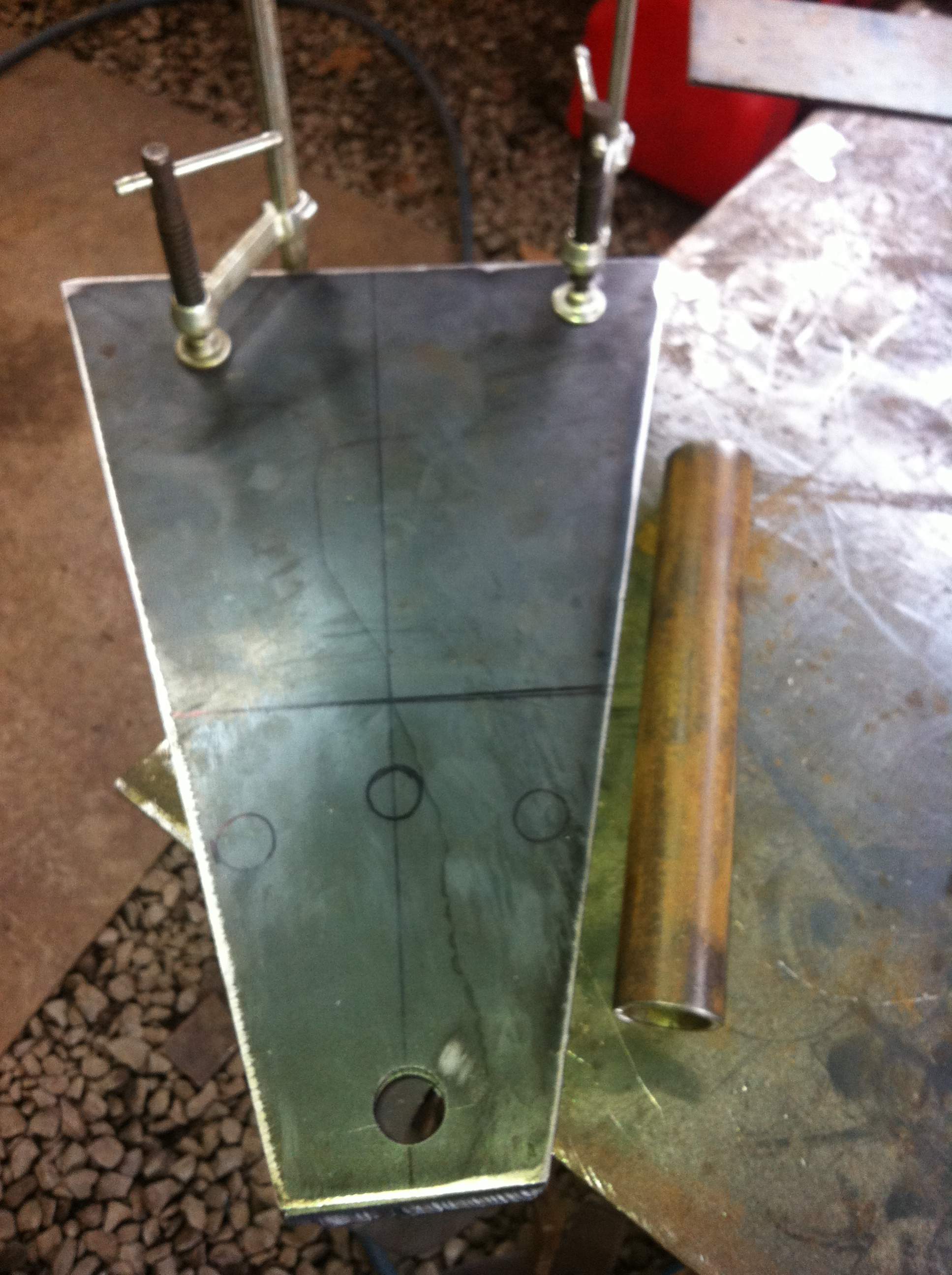

Hi guys new guy here,:D. My question/questions are I reacently purchased a BX2751 quick hitch for my 2010 BX25 and i'm in the prosess of makeing a blade for it. Already have the blade rolled/bent to match the factory BX2763a (hight/width/curvature) but can't find the part# or specs for the angle cylinder for it? Also looking for some measurements on the bracket that bolts to the blade that the quick hitch an angle cylinder latches to. I have bin roaming this forum an google since Wednesday and only find pictures. I emailed my Kubota dealer an no response yet. I also emailed Messic's while waiting. Any help would be appreciated.
Will post pics when I upload them from my phone.
Thanks for your help an time,Joe

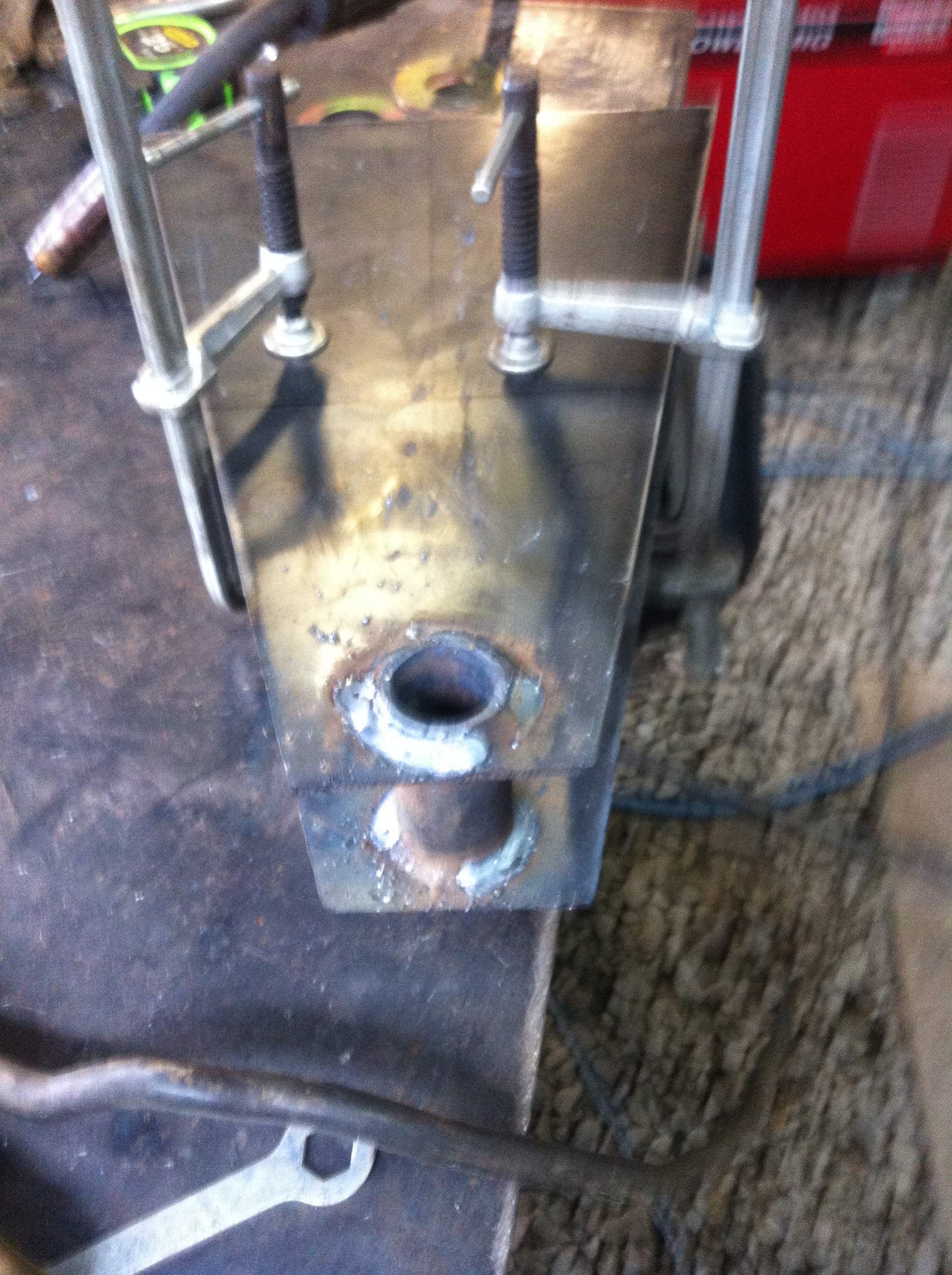

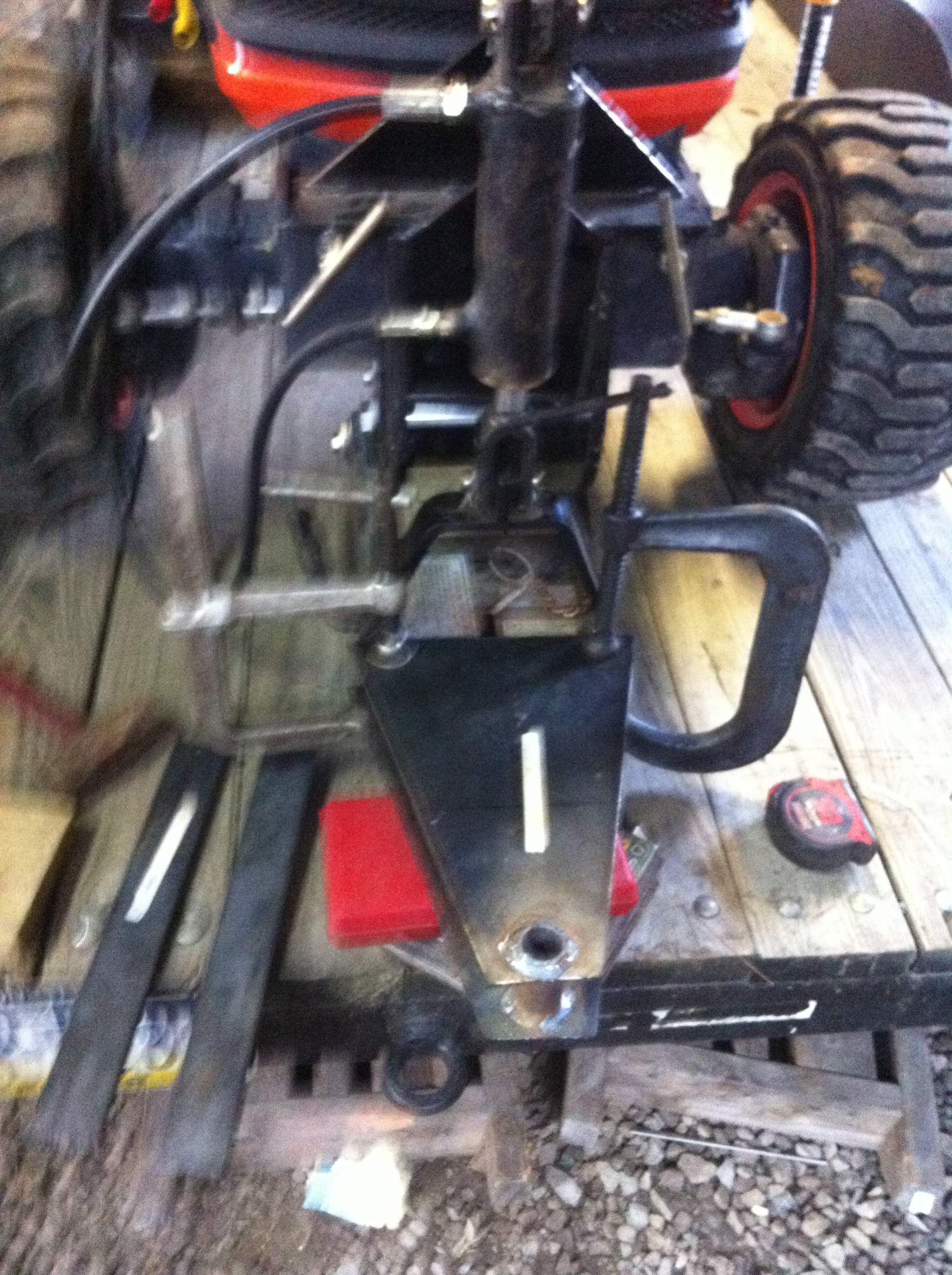

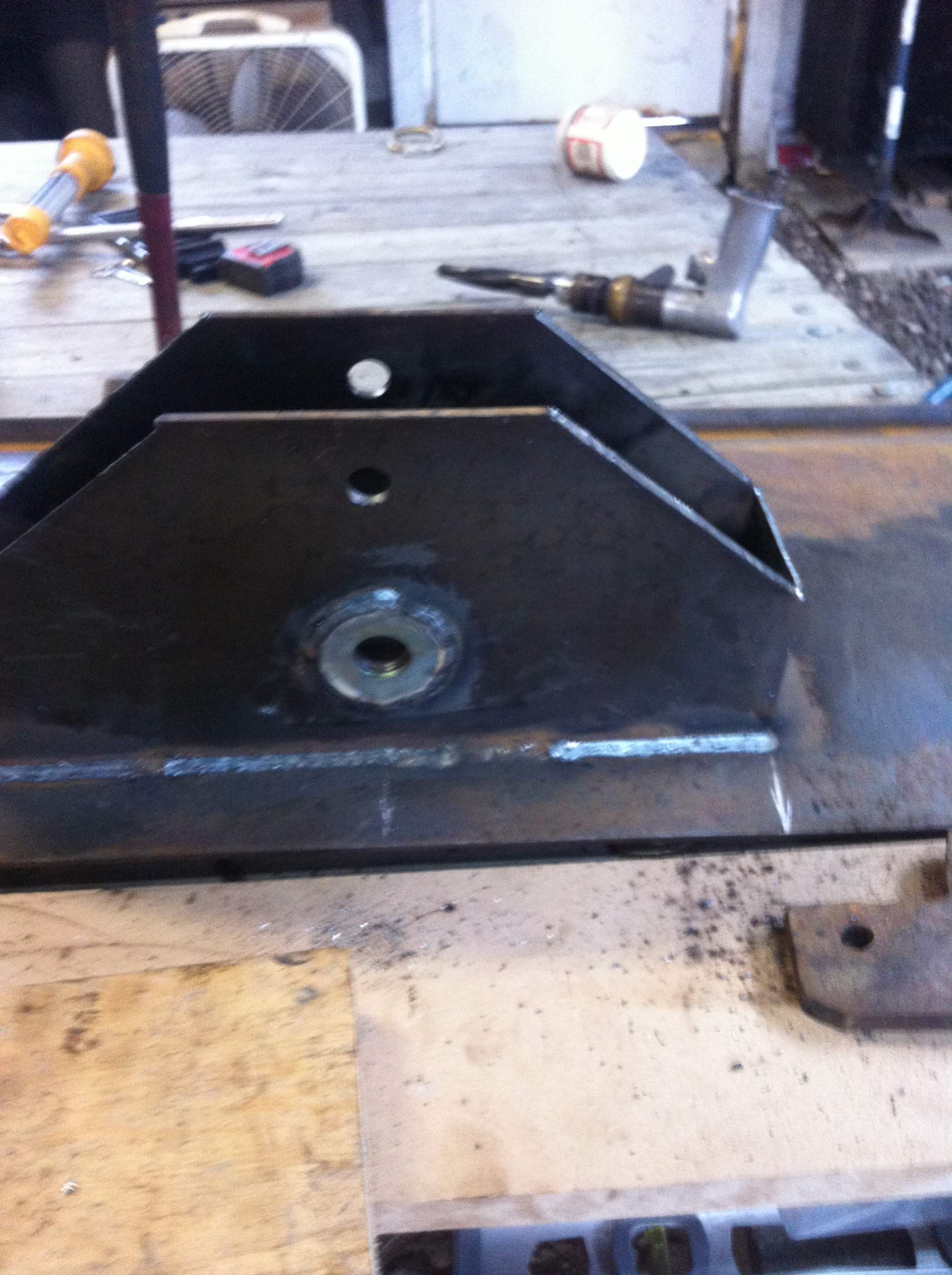

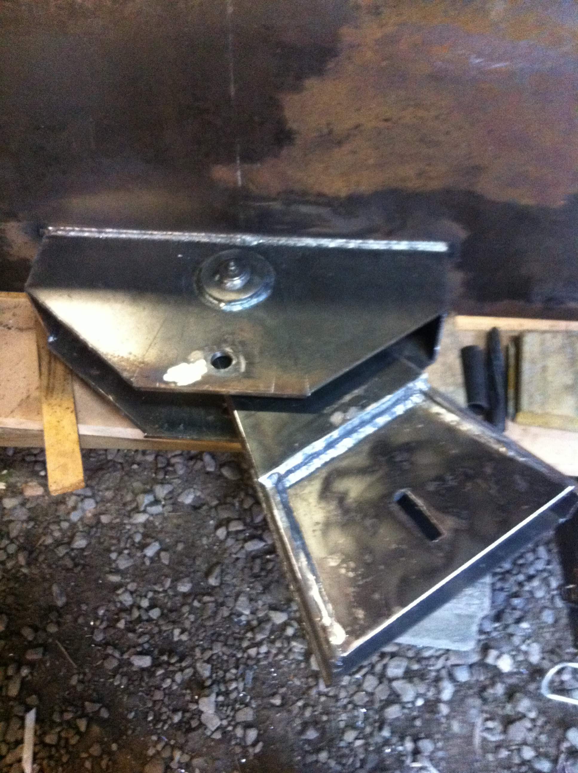

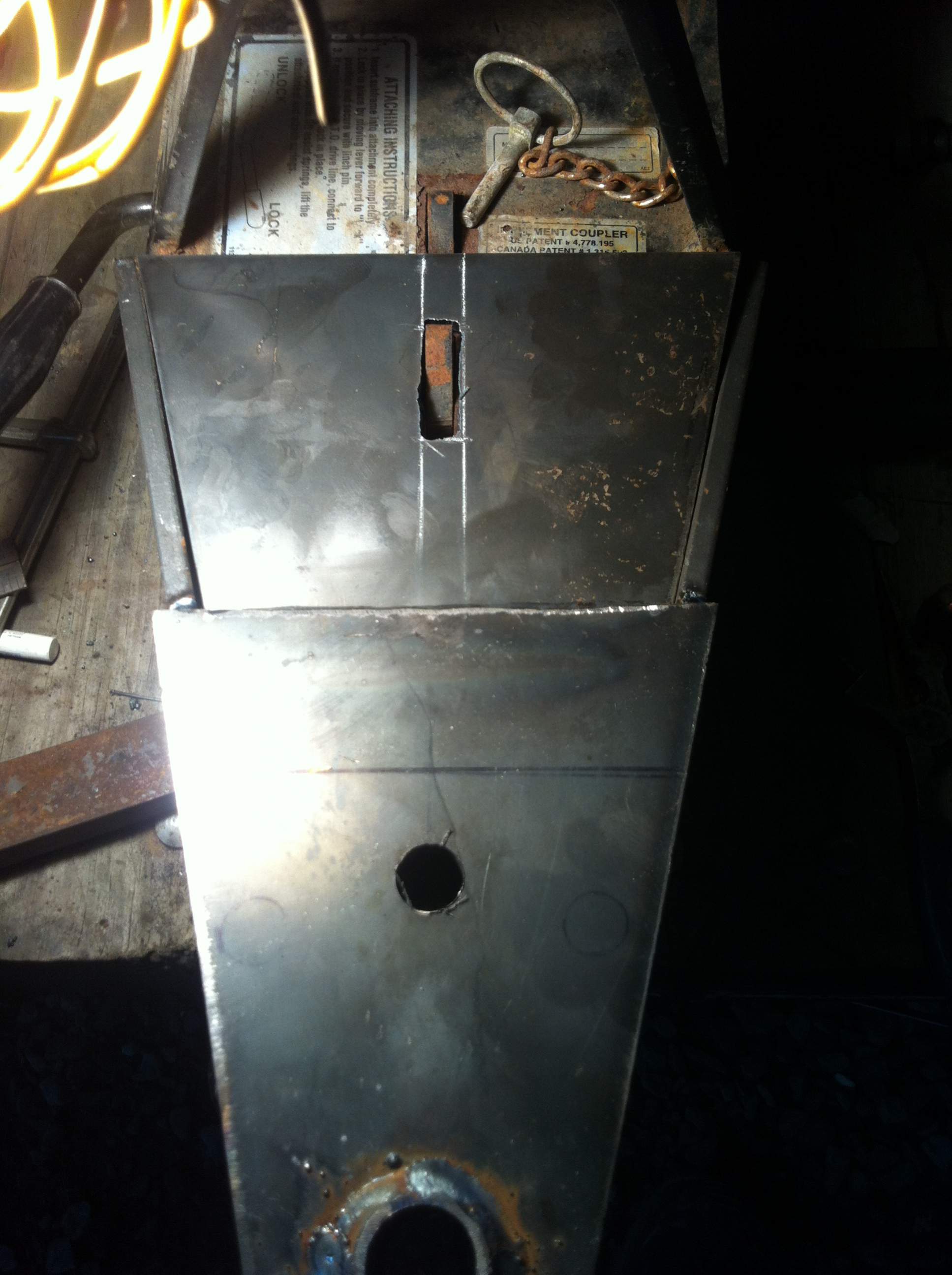

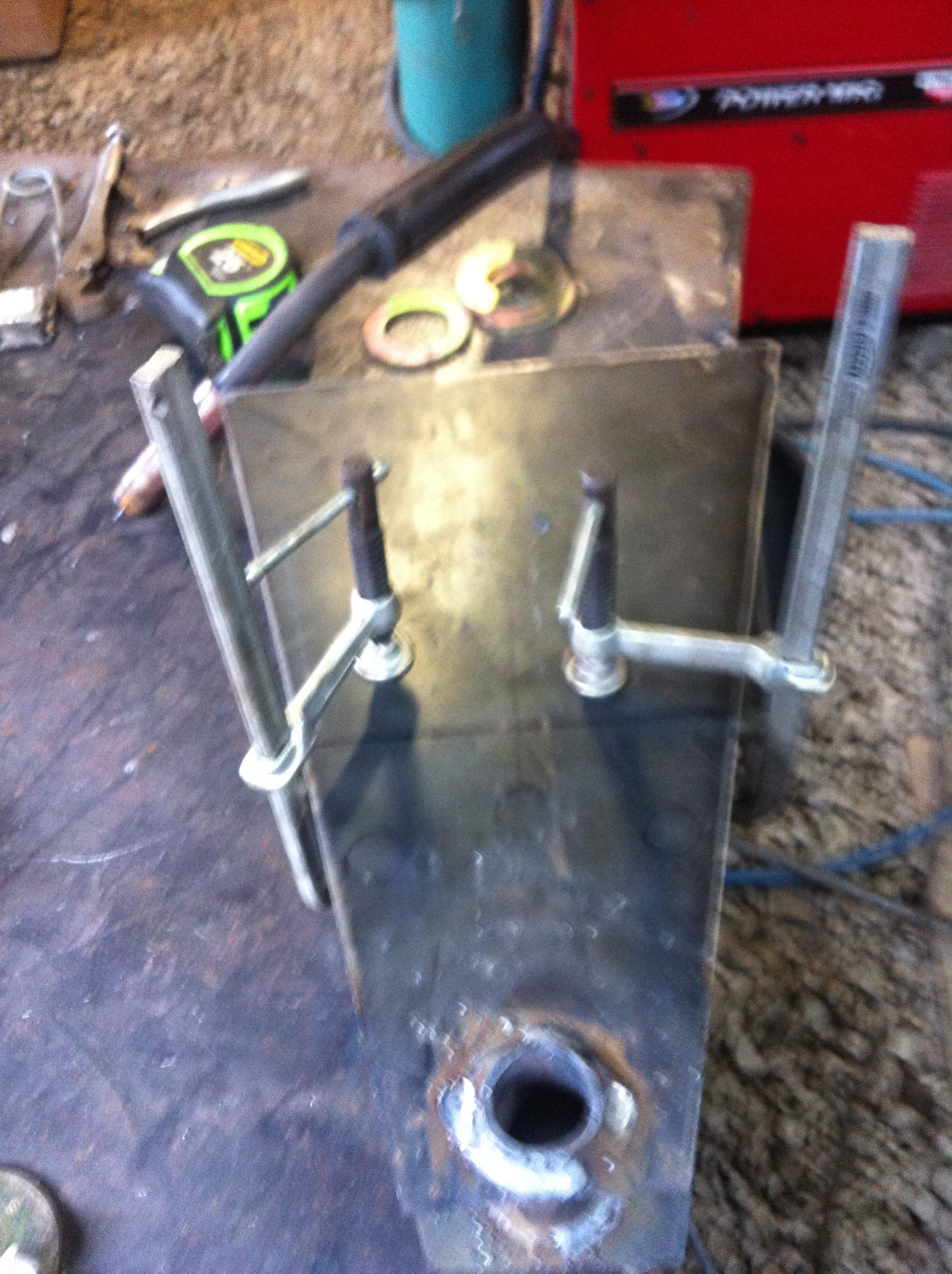

Little bit of progress. Guesstimating on the way.

I've been looking for that same cylinder for my sweeper. It is the same one on both the 2763 and the sweeper. The Kubota part # is 70001-00871, hydraulic cylinder and the desc has the dimensions as 2" x 5".

Nice fab so far!
My suggestion is since your building from scratch, use some common, inexpensive and readily available SA snowplow cylinders like Meyers, Western, Fisher, ect. use. They are usually 2x8, or 2x10 in heavier/wider plows.

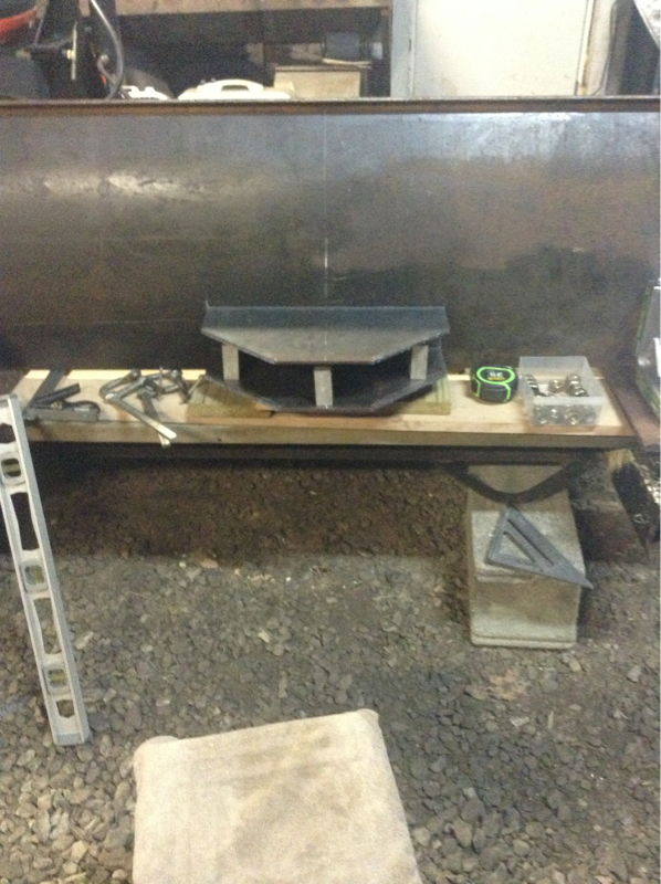

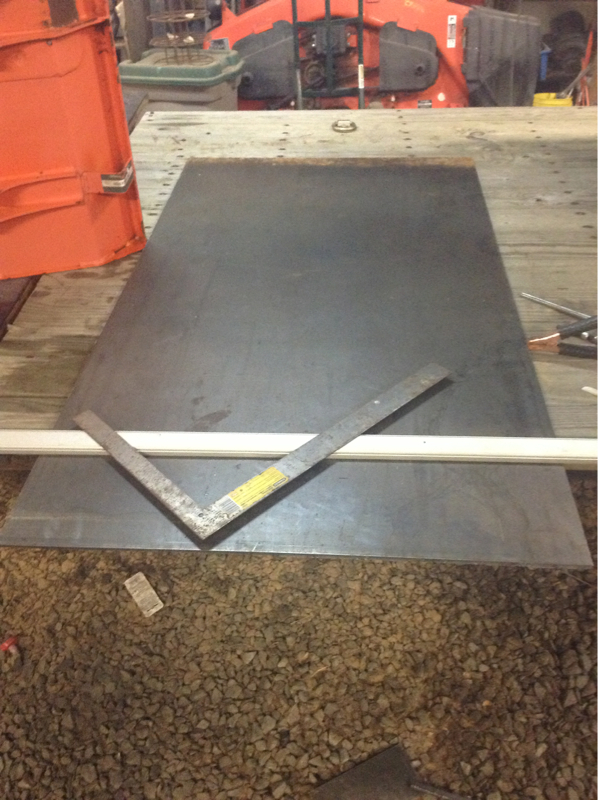

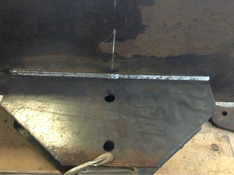

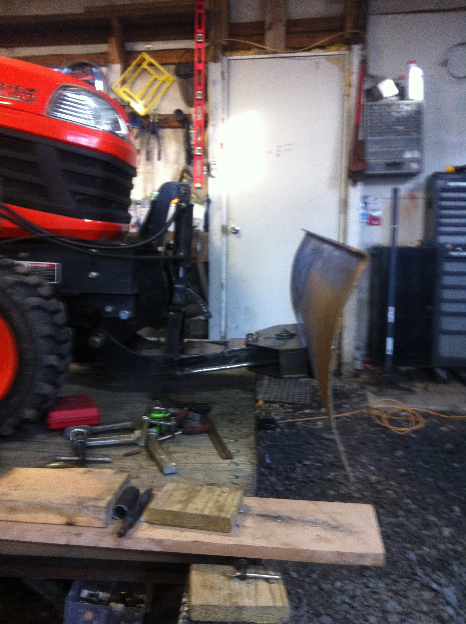

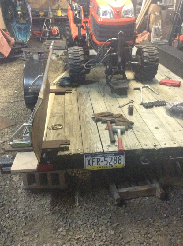

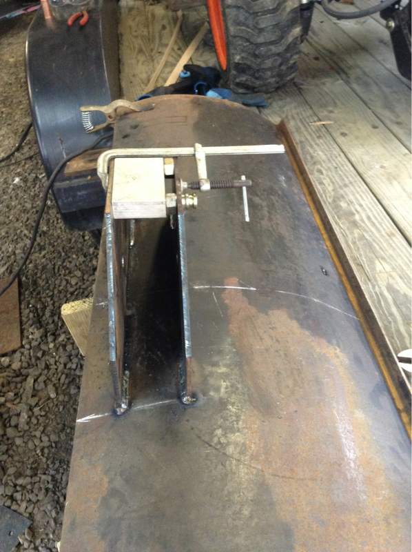

Got it pretty much finished up today. Just have to wire wheel it down and do some touch up grinding then for some paint. Glad Its almost done as they are calling for 5" of snow starting tomorrow around 12296.jpg299.jpg300.jpg301.jpg303.jpg304.jpg
   / Cylinder and measurements for bx2763a blade

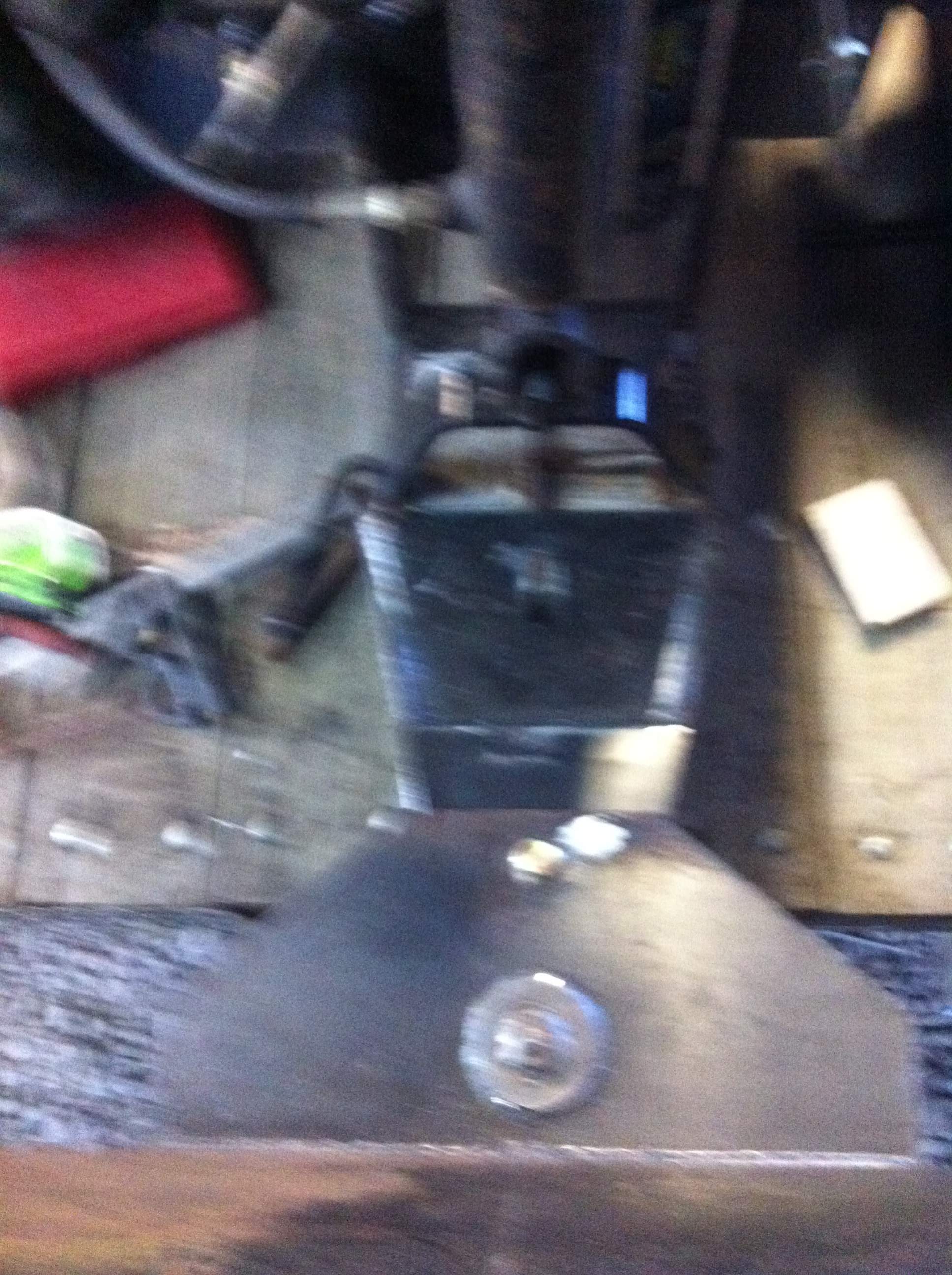

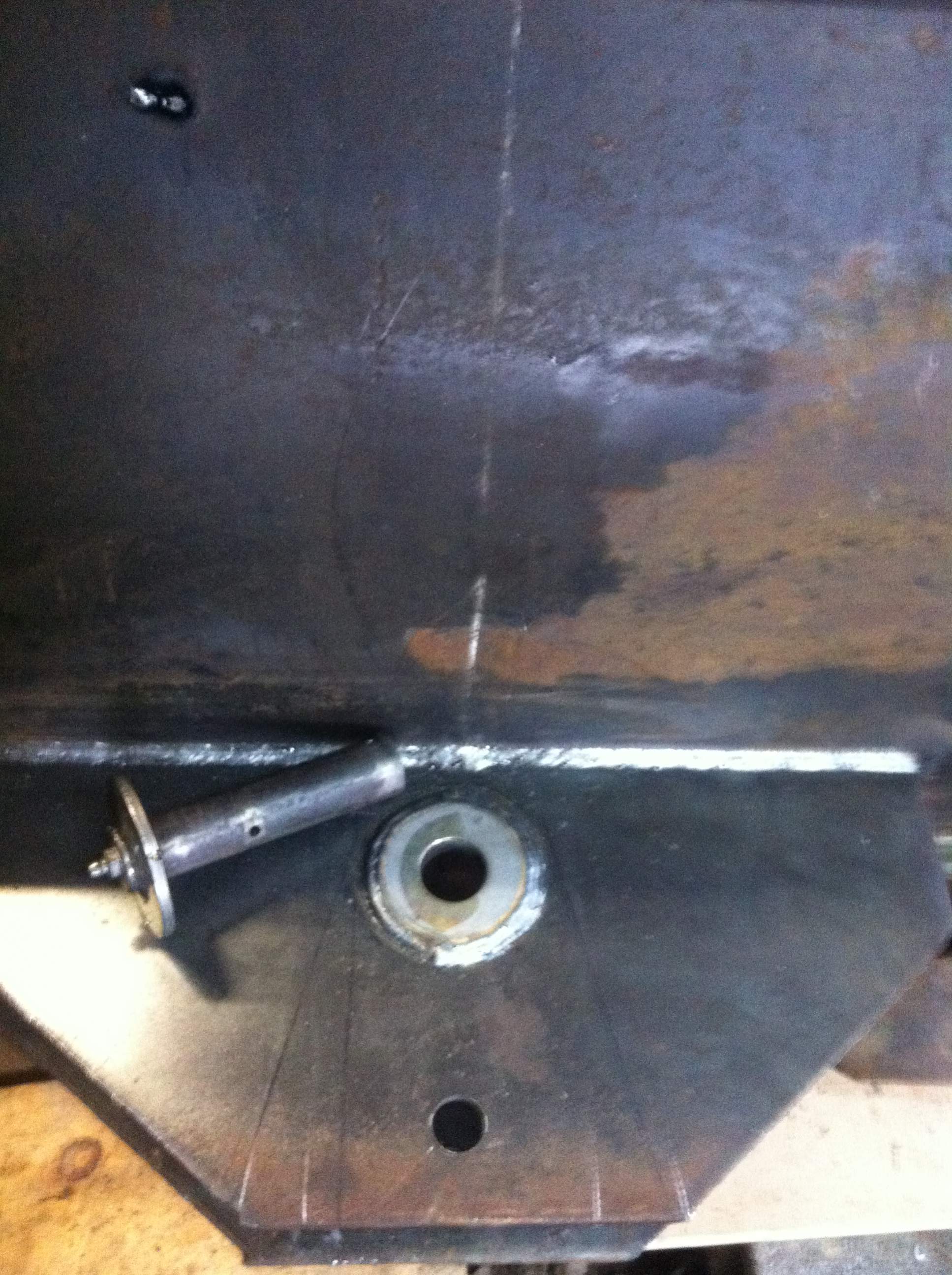

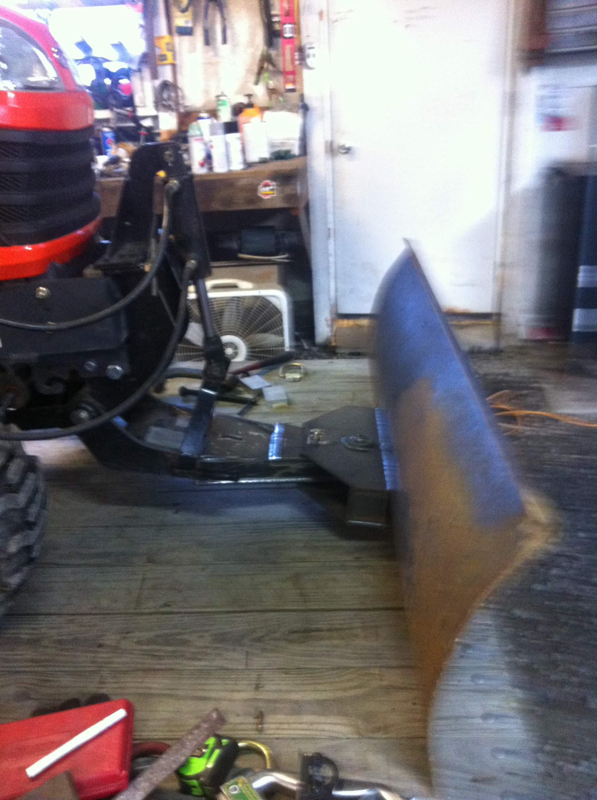

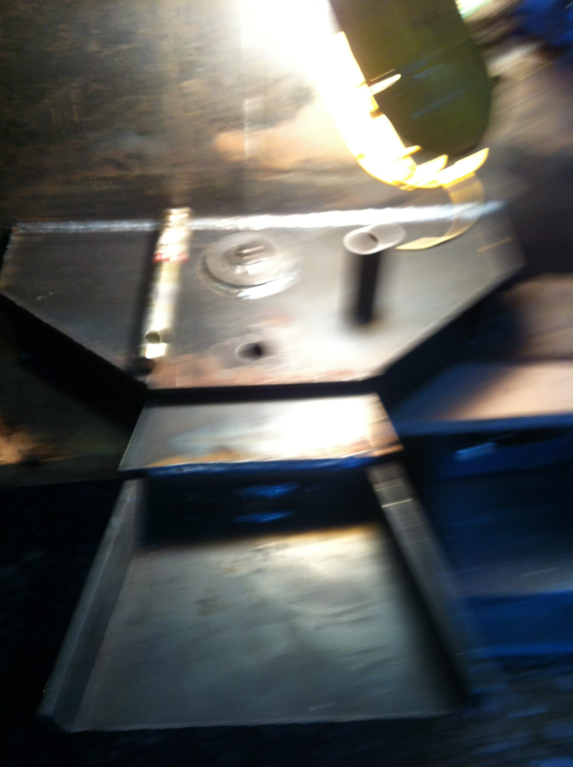

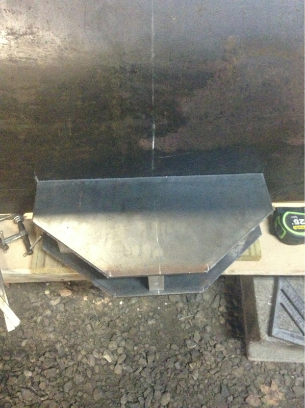

I have looked around an seems like everybody that has any wants top dollar for them an the one that I found cheap the shaft was all scared up so I'm just gonna order that one from surplus center. At least I know what I'm getting.

Ya my dealer gave me a price of $305.00 for the cylinder. I'm going with the 1-1/2 x 6" one from surplus center for $88.95.

Looks good!
Are you bolting on a reversible cutting edge?
